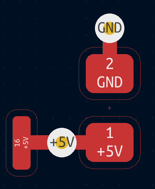

I've been designing the 4-layer board, and I came across an interesting predicament. Attached are pictures.
This is a SOIC-16 chip. As you can see, I am using vias to bring the 5V and GND signals to their inner layers. I am not putting the vias *on* the pads, but very near it. But the via for 5V is in between the bypass cap and the pin. This saves a lot of room! But I have a feeling like it's not optimum. If it is not optimum, is it still "good enough"?
Thank you for any insight.
Chad
Proxy
Posts: 746
Joined: 03 Aug 2018
Re: SMT/SMD, 3V3, and CPLD Routing Tips?
Post by Proxy »
At the kinds of speeds these systems run at, even using an autorouter is "good enough" most of the time.
So I'm sure what you're doing there is fine.
plasmo
Posts: 1273
Joined: 21 Dec 2018
Post by plasmo »
It is common to place bypass caps at back of the components. Like Proxy has said, reasonable placement then auto route is good enough. You’ll find with 4-layer pcb, the design is most likely functional without any bypass cap. During product qualification we may build up a qualification unit without any bypass cap to check system noise margin. In most cases such qual units worked just fine.
SamCoVT
Posts: 344
Joined: 13 May 2018
Post by SamCoVT »
This looks fine to me. When you get into the hundreds of MHz and GHz ranges, then exactly where you place things matters a lot more, but at the speeds this board will run at (tens of MHz) it's probably not going to matter that much and what you have looks better than average (meaning you have a very high chance of it being just fine).
When designing PCBs, there are always things you can do to make it better, however any given board just needs to be good enough and many things you do to make one thing better can make another thing worse. It also takes time to keep optimizing the board, so it's better to just get to where it is good enough and not waste any more time unless you really need those optimizations.
Is your design good enough? Very likely. You've even followed some best practices like using power/ground planes, using SMT caps, placing the cap very close to the IC, and placing the vias close to the cap; you are already well above the "good enough" level. Any further optimizations you might do, such as actual location of the vias or how many you use to connect to the power/ground planes, aren't going to have much effect at your speeds and power levels and probably not worth spending time on. As Bill notes, your circuit might even work without any bypass caps installed (but you should install them, as they make things measurably better).
Arlet
Joined: 16 Nov 2010
Post by Arlet »
For hand soldering, or home reflowing in a toaster oven, it's not a problem to put a via inside a pad. It will suck up some solder, but you can always fix that.
