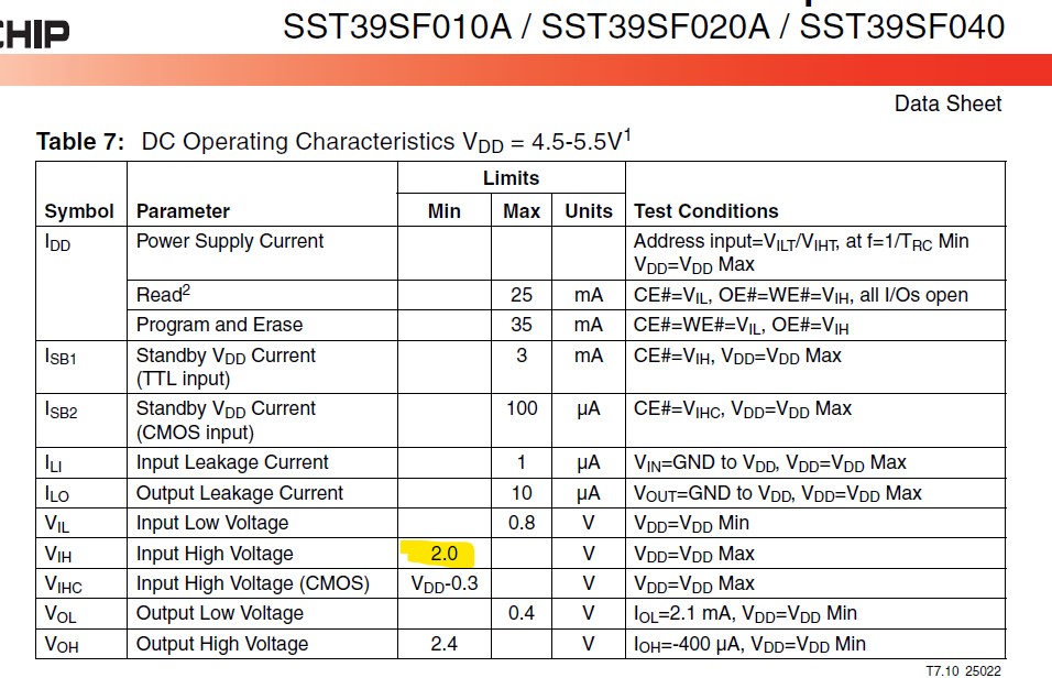

1) My 3V3 CPLD is sending address signals to my SST39SF040 Flash ROM. The ROM is powered by 5V. I have looked over the datasheet and I cannot find anywhere it says that 3V3 inputs are acceptable except for a tiny mention "TTL compatible". Right now I have 3.3K pull-up resistors to 5V on those lines so (in theory) the 3V3 signal from the CPLD is simply grounding when low and 'letting the resistors pull up' when high. At least that's my theory. I believe it still works without those resistors but I'm scared to touch this ... breadboard. I am aware of the SST39LF040, powered by 3V3, but it also says it's "max high input" is not 5V, so it doesn't seem 5V tolerant. Any experience with the SST39SF040 with 3V3?

PostPosted: Fri Jun 30, 2023 11:50 am
Posts: 197
The VIH figure from the DC part of the datasheet shows you the minimum voltage that will be accepted as a high, in this case that's 2.0v. There's no maximum quoted so anything from 2v to the absolute maximum of any pin of VDD+0.5 is acceptable. (Though input voltages over the supply should be avoided for the long term health of the device.)
As long as the CPLD is guaranteed to output at least 2v, then you're in spec.

PostPosted: Fri Jun 30, 2023 12:15 pm
Posts: 718
Thank you, and yes I saw that.
But the "CMOS" version does not guarantee 2.0V. So what is the difference between the CMOS and the, uh, blank?

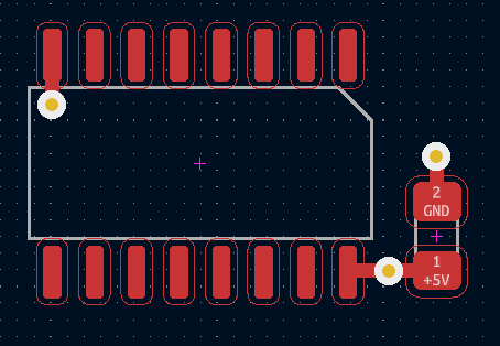

PostPosted: Mon Jul 03, 2023 11:46 am
Posts: 718
I've been designing the 4-layer board, and I came across an interesting predicament. Attached are pictures.
This is a SOIC-16 chip. As you can see, I am using vias to bring the 5V and GND signals to their inner layers. I am not putting the vias *on* the pads, but very near it. But the via for 5V is in between the bypass cap and the pin. This saves a lot of room! But I have a feeling like it's not optimum. If it is not optimum, is it still "good enough"?

PostPosted: Mon Jul 03, 2023 1:10 pm
Posts: 746
At the kinds of speeds these systems run at, even using an autorouter is "good enough" most of the time.
So I'm sure what you're doing there is fine.
PostPosted: Mon Jul 03, 2023 2:13 pm
Posts: 1117
It is common to place bypass caps at back of the components. Like Proxy has said, reasonable placement then auto route is good enough. You’ll find with 4-layer pcb, the design is most likely functional without any bypass cap. During product qualification we may build up a qualification unit without any bypass cap to check system noise margin. In most cases such qual units worked just fine.
PostPosted: Thu Jul 06, 2023 1:47 pm
Posts: 255
This looks fine to me. When you get into the hundreds of MHz and GHz ranges, then exactly where you place things matters a lot more, but at the speeds this board will run at (tens of MHz) it's probably not going to matter that much and what you have looks better than average (meaning you have a very high chance of it being just fine).
When designing PCBs, there are always things you can do to make it better, however any given board just needs to be good enough and many things you do to make one thing better can make another thing worse. It also takes time to keep optimizing the board, so it's better to just get to where it is good enough and not waste any more time unless you really need those optimizations.
Is your design good enough? Very likely. You've even followed some best practices like using power/ground planes, using SMT caps, placing the cap very close to the IC, and placing the vias close to the cap; you are already well above the "good enough" level. Any further optimizations you might do, such as actual location of the vias or how many you use to connect to the power/ground planes, aren't going to have much effect at your speeds and power levels and probably not worth spending time on. As Bill notes, your circuit might even work without any bypass caps installed (but you should install them, as they make things measurably better).
PostPosted: Fri Jul 07, 2023 5:33 pm
For hand soldering, or home reflowing in a toaster oven, it's not a problem to put a via inside a pad. It will suck up some solder, but you can always fix that.
