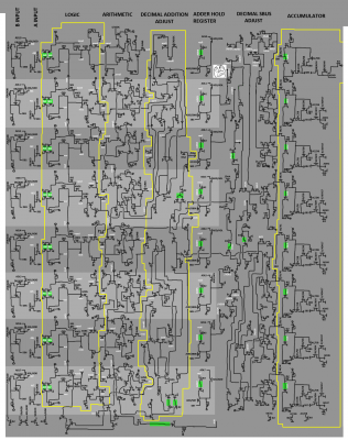

I decided to release sources of ALU and LOGIC :
http://ogamespec.com/6502/ALU.psd
http://ogamespec.com/6502/LOGIC.psd
Remember, this is still W.I.P.

Re: Breaking 6502 apart
Post by org »
Todays speccy: complete ALU transistor schematics
Enjoy! :D

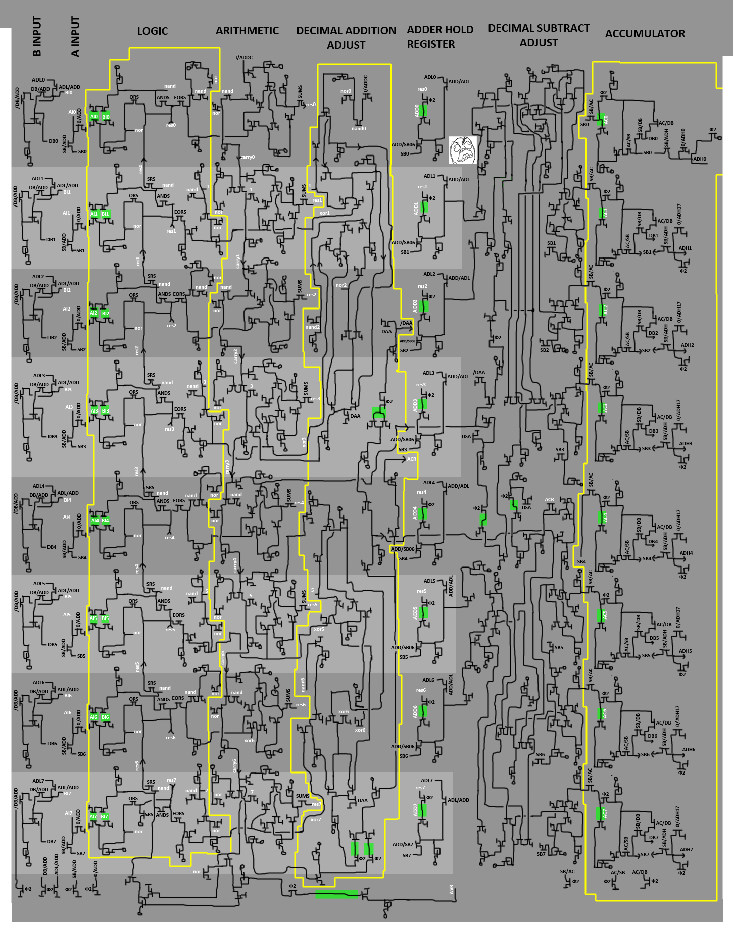

Post by org »
Todays speccy: ALU logic (missing BCD correction).
// A/B INPUT
if ( NDB_ADD ) BI = ~DB;
if ( DB_ADD ) BI = DB;
if ( ADL_ADD ) BI = ADL;
if ( SB_ADD ) AI = SB;
if ( 0_ADD ) AI = 0;
// LOGIC (based on NAND/NOR)
NOR = ~(AI | BI);
NAND = ~(AI & BI);
if ( ORS ) ADD = NOR;
if ( ANDS ) ADD = NAND;
if ( SRS ) ADD = NAND >> 1;        // next bit feed previous result
if ( EORS ) {
    nEOR[0,2,4,6] = ~ (~NOR & NAND)
    EOR[1,3,5,7] = ~ (~NAND | NOR)
    ADD[0,2,4,6] = nEOR[0,2,4,6]
    ADD[1,3,5,7] = ~EOR[1,3,5,7]
// ARITHMETIC
// BCD correction run-flow : DAA -> ALU -> ADD -> DSA -> SB -> AC.
// DECIMAL ADDER ADJUST (detect decimal carry and halfcarry)
// input carry driver I_ADDC comes in inverted form
// carry chain
carry_out = I_ADDC;
// bits 0,2,4,6
carry_in = carry_out;
carry_out = ~(NAND[0,2,3,6] & carry_in) & ~NOR[0,2,4,6];
SUM[0,2,4,6] = ~(nEOR[0,2,4,6] & ~carry_in) & (nEOR[0,2,4,6] | ~carry_in);
// bits 1,3,5,7
carry_out = ~(~NOR[1,3,5,7] & carry_in) & NAND[1,3,5,7];
SUM[1,3,5,7] = ~(EOR[1,3,5,7] & ~carry_in) & (EOR[1,3,5,7] | ~carry_in);
// trans-level implementation of summator see in ALU_sum.png
// overflow test
carry6_out = carry_in;
if ( PHI2 ) AVR_Latch = ~(NOR7 & carry6_out) & (NAND7 | carry6_out);
AVR = AVR_Latch;
if ( SUMS) ADD = SUM;
// High-level implementation :
// s = AI + BI + ~I_ADDC;
// SUM = ~ ( s & 0xFF );
// carry_out = s >> 8;
// ADDER HOLD (register holds data in inverted logic)
if ( ADD_ADL ) ADL = ~ADD;
if ( ADD_SB06 ) SB = (SB & 0x80) | (~ADD & 0x7F);
if ( ADD_SB7 ) SB = (SB & 0x7F) | (~ADD & 0x80);
// DECIMAL SBUS ADJUST (affects SBus lines)
// ACCUMULATOR
if ( SB_DB ) DB = SB;
if ( SB_AC ) AC = SB;
if ( AC_SB ) SB = AC;
if ( AC_DB ) DB = AC;
if ( 0_ADH0 ) ADH &= ~0x01;
if ( 0_ADH17 ) ADH &= 0x01;
DSA is actually "DECIMAL SBUS ADJUST", not "DECIMAL SUBTRACT ADJUST".
DSA is applied before loading accumulator (AC), after BCD correction.
EDIT: important condition:
if ( PHI2 )
    NDB_ADD = DB_ADD = ADL_ADD = 0_ADD = 0;
    SB_AC = AC_SB = AC_DB = 0;
    ADH = 0;
For the equations, you could check the patent which is linked from this post
viewtopic.php?p=8859#p8859
You might find some of the info on the visual6502 wiki useful too
http://visual6502.org/wiki/index.php?ti ... ecimalMode

A bit cleaned ALU.
I'm ready to write its C simulator. Stay tuned ;)
