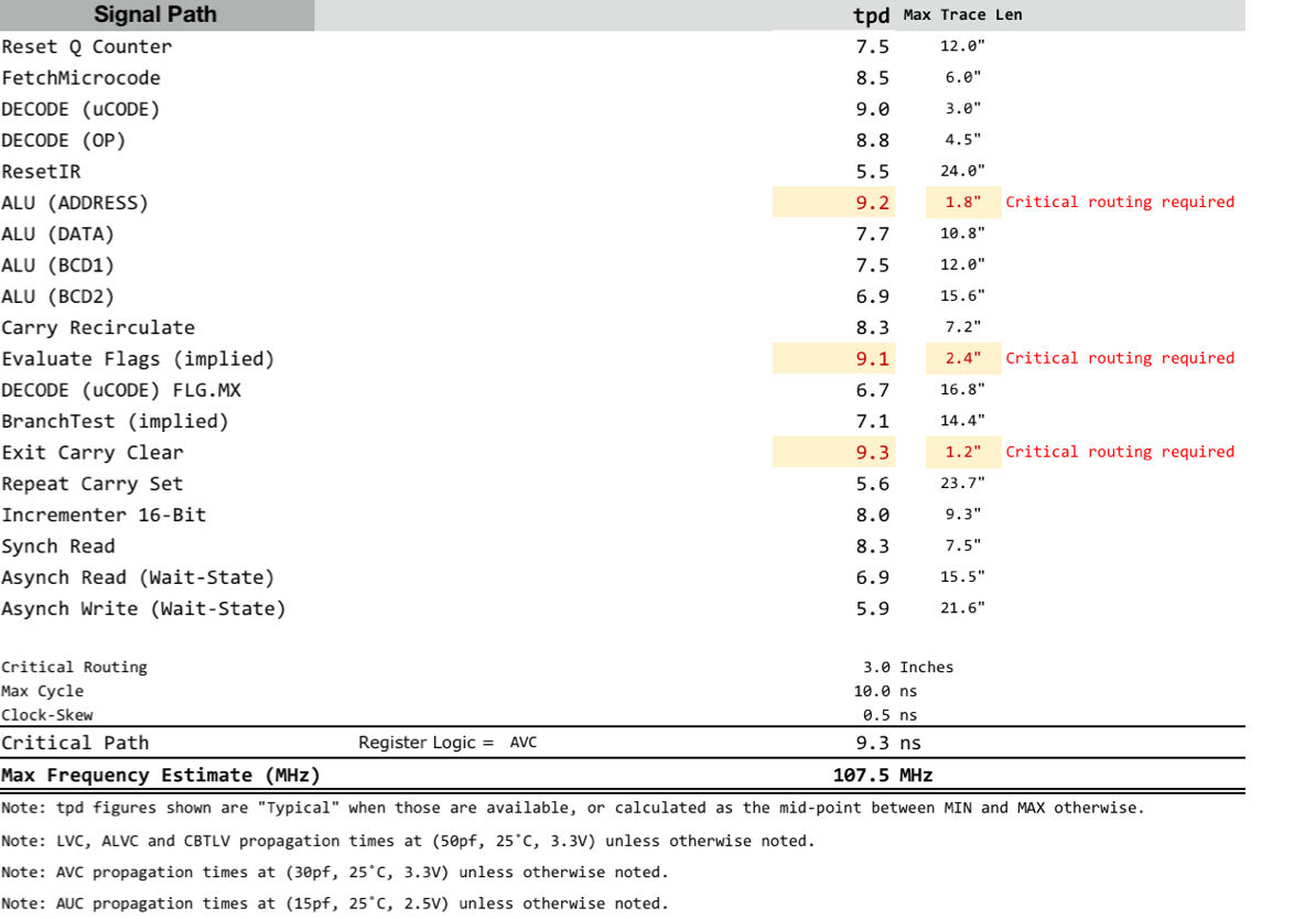

It’s too close for comfort!
Listed above are all the signal paths through the CPU with estimated propagation delays. Highlighted are paths that will require critical routing. Those are paths that will allow less than 3” of cumulative signal trace length (assuming 0.5ns of clock skew and 6” per nanosecond propagation delay through an FR4 pcb). It’s going to be a neat trick to route these critical circuits within the prescribed maximum trace lengths. The tolerances here are making my head spin! :evil:
For reference, the following logic families are assumed:
  • AVC (3.3V) — Registers
  • NC7SV (3.3V) — Gates and flip-flops
  • LVC (3.3V) — Decoders and counters
  • CBTLV (3.3V) — Muxes
  • AUC (2.5V) — 74AUC2G53 2:1 switch
The obvious issue is the inclusion of 74AUC2G53 2.5V ICs in this mix. Were it not for them, we could get by solely with a 3.3V supply. But they are essential. So we are definitely into a dual-supply scenario here.
Another possibility is to simply run all parts at say 3V, which is below the Absolute Maximum rating of AUC parts and only slightly below the Recommended VCC of the 3.3V families. I’m not sure what kind of safety margin is needed to keep those ICs happy. Certainly I was able to run the AUC FET Adder at 3.3V without frying any chips! Maybe a single 3V supply may work?
An alternative mix of families is:
  • AUC (2.5V) — Registers
  • AUC (2.5V) — Gates and flip-flops
This mix of parts has slightly longer average tpd figures and slightly lower output drive but also lower input pin capacitance associated with AUC parts. AUC also features variable impedance outputs whereas NC7SV gates don’t. The former are far better for transmission lines, but in many situations gate-level ICs are used only within lumped circuits in any case. Honestly, I’m not at all sure which mix of parts if going to best at this stage. We may have to wait until the layout before the better alternative is clear.
In the meantime, I would very much appreciate any thoughts anyone might offer regarding the relative safety of running ICs a little hot, but below their rated absolute maximums. Is that pushing luck too far?
Cheers for now,
Drass
Most parts will suffer a loss in speed when run below their nominal voltage.

I vote for the alternative mix, and for having 2.5V and 3.3V polygons on one PCB layer if possible.
To me, mixing 3 different logic families in the same design somehow feels safer than mixing 5 different logic families in the same design.
We need to take a closer look at the signal paths with a propagation delay slower than 8.9ns.
Capacitance is going to be a critical factor, we need to take a closer look at it, too.
At 100MHz, address decoding is an interesting (and still open) topic.
Would suggest to draw one big schematic for the whole CPU first while placing the chips in a *.brd file
by sorting/grouping the chips according to functional groups in the CPU block diagram,
just for getting a rough overview about how many chips we have in total, and how they are "wired" together,
and if\how\where we would be going to need line termination of the control (and\or data) signal traces.
This (hopefully) will tell us, how to break the big schematic into a set of smaller schematics
for the set of PCBs the CPU will be made of while trying to keep the PCB traces as short as possible.
Drass, it would be helpful if you could post a more detailed block diagram of the CPU.

Regarding the trace lengths: Do you plan to put parts on both sides, to get more parts per square inch and hold the trace lengths down?
Yes, that’s the plan. The stackup is not quite fully worked out, but for sure there will be components on both the top and bottom layers. The current thought is to go with a 6 layers, as follows:

This would be on a 1.6mm FR4 (7628) PCB, with 8 mil microstrip and 6.5mil stripline traces to yield 50Ω impedances. If the VCC plane becomes too fragmented due to the dual-voltage supply requirement, then it might be necessary to either turn Signal H into a VCC2 plane or go to an 8 layers board. Dr Jefyll has done some great work to confirm the use of VCC as a reference plane in various scenarios, which is great. I will need continued help to finalize the stackup when the time comes (which I suspect will be partially into the layout).

Yes, I agree. I was thinking about it as a compromise where 2.5V parts run faster than spec and 3.3V parts slower, but it more or less averages out. The main question is whether I can get away with a single supply. I tested 2.5V 74AUC2G53s at 3.3V and all was fine ... their Absolute Maximum rating is 3.6V. I’m wondering whether planning on a single supply that can be pushed up to 3.3V if necessary is reasonable. (i.e. to run the 2.5V parts well above the “recommended” range but still below the “maximum” range). I don’t fully understand the safety margins required so this may be a crazy idea that should be quickly abandoned. :roll:
