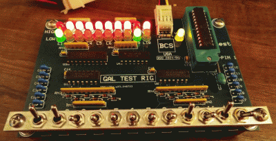

While it is possible to monkey-rig a GAL and some LEDs on a breadboard, a breadboard’s sometimes-flaky connections may introduce problems that will produce false results.  I figured it would be better to build a test gadget that could produce repeatable results, which meant it had to be fault-free in all respects.  So what I’ve done is expand on the monkey-rig concept to produce something that is easy to use, unambiguous in operation...and trustworthy.  :wink:
The test rig I built is designed to test a 22V10, which device has 12 dedicated input pins and 10 dual-purpose pins, the latter which may be programmed as inputs or outputs.  In my application, I am assuming that the dual-purpose pins are all outputs, an assumption that simplified the test rig’s design, as well as contained its cost.  I’m powering the test rig with 5 volts from an old PC power supply, since I always seem to have several laying around.

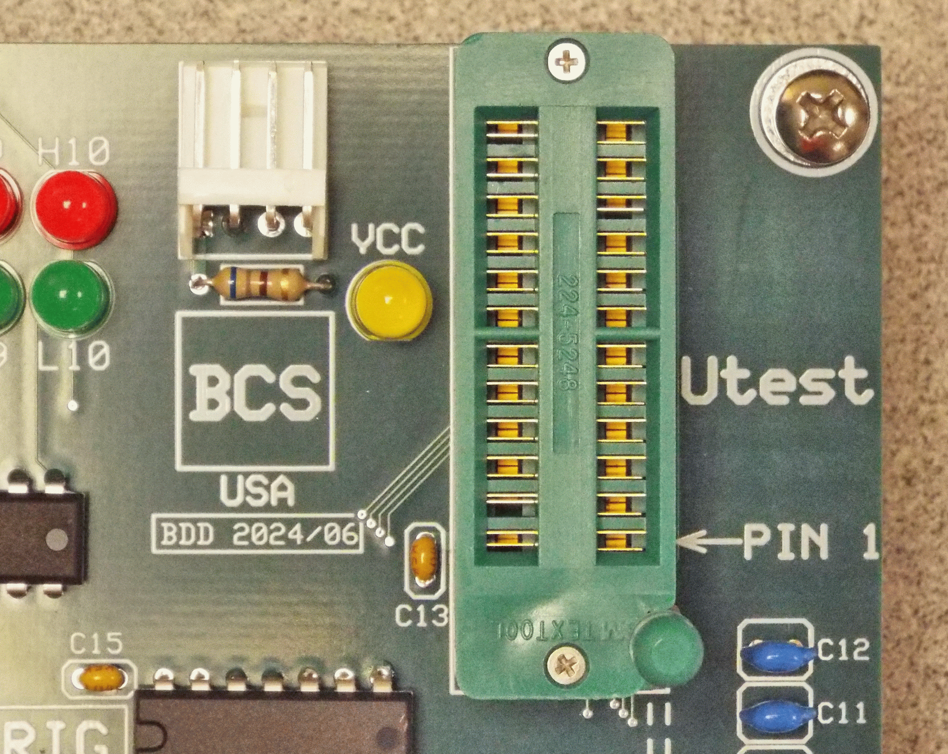

For convenience, the rig has a ZIF socket for the GAL under test.  I was less concerned with the cost of this socket than I was with its reliability and durability, so I chose quality over cheapness—unsurprisingly, it’s the most expensive single part on the rig.  :shock:  Although the socket is wired to accommodate a 22V10, which has 12 dedicated inputs, a 16V8 or 20V8 could be tested by employing a little Mickey-Mouse-ity with some short jumper wires.
The rig has an array of toggle switches to control the GAL’s inputs, the switches being debounced so they don’t introduce glitches that might mistakenly be seen as something caused by the GAL itself.  Each output on the GAL being tested ultimately drives a red/green pair of LEDs to indicate state, with the usual “red-means-high” arrangement.

GAL Test Rig
GAL Test Rig
GAL Test Rig ZIF Socket
GAL Test Rig Output State LEDs
GAL Test Rig Input Switches
The switches, from left to right, control the following inputs to the particular GAL that was the test guinea pig:
  • A15, A14, A13, A12, A11, A10, A9, A8, A7, A16, VADR, RWB

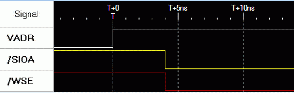

While I was fooling around with the test rig, I connect the logic analyzer to see how quickly the GAL responds to input changes.  Here’s one capture:
Logic Analyzer Capture
In the above, the capture was triggered by the low-to-high transition of VADR.  The test rig switches were configured to generate the address $00C00x, which corresponds to a DUART #1 (/SIOA) chip select.  The logic analyzer was configured to sample signal states for a short period of time before VADR went true.  Elapsed time starts at the trigger event.
As can be seen, both /SIOA and /WSE apparently became true only 4 nanoseconds after VADR became true.  I say “apparently” because the logic analyzer’s maximum resolution is 2ns.  The GAL acting as the guinea pig is guaranteed to have 7.5ns pin-to-pin performance, which is possible in this case because all logic is combinatorial and doesn’t use any pins as nodes.  Hence the above capture implies that the logic analyzer is being optimistic about the guinea pig’s performance.  More likely, the switching speed is at least 5ns due to logic analyzer fudging.  Or...it could be 3ns, which is listed as a TPD minimum in the data sheet for simple, combinatorial logic—but seems very unlikely.  Either way, performance when compared to what would be achievable in equivalent discrete logic is excellent.  :D

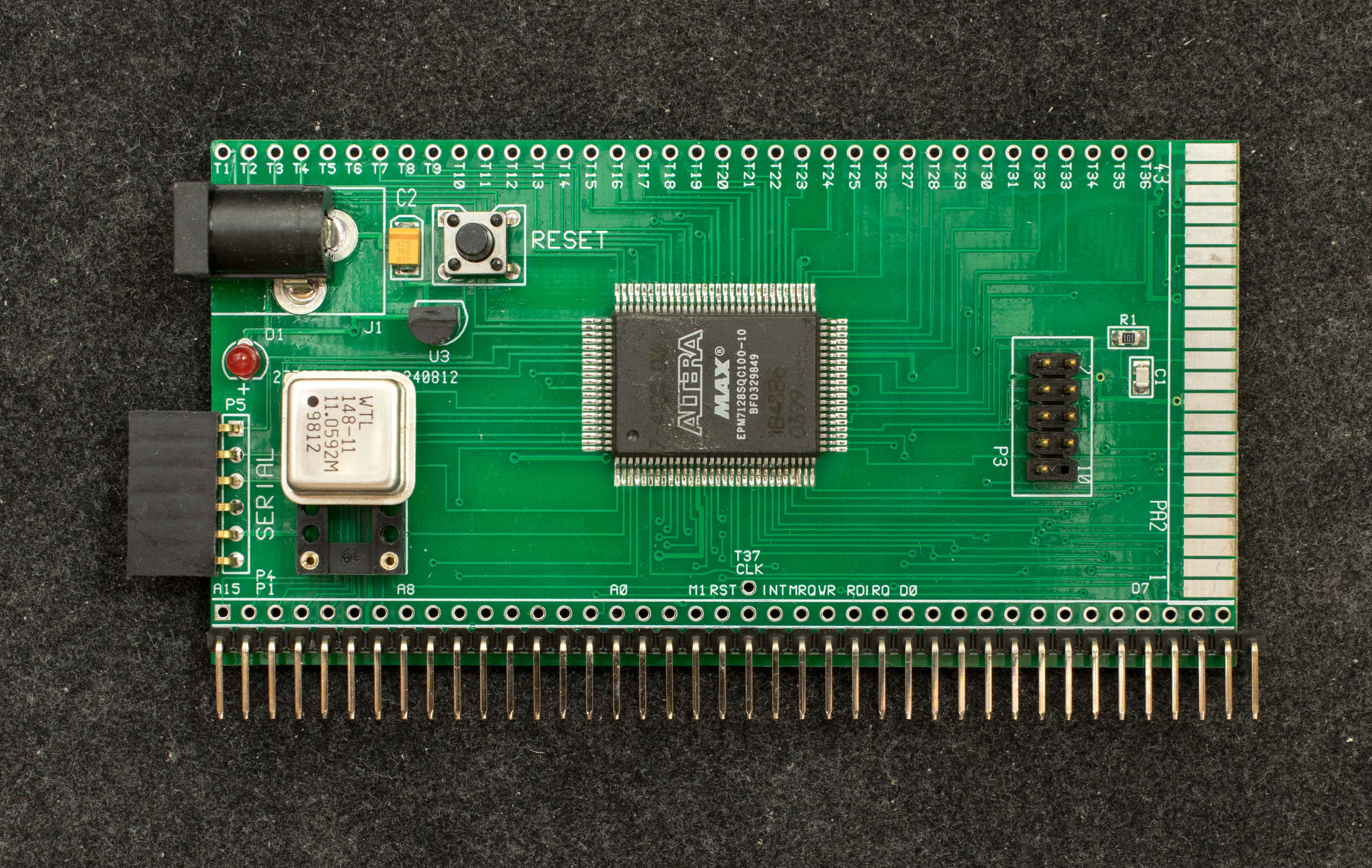

In the same vein as the above GAL tester, I have a CPLD tester on the “drawing board.”  Functionally, the CPLD tester will be like the GAL tester, but more elaborate due to the greater number of signal pins and the fact that most of them may be programmed as inputs, outputs or bi-directional.  So there are going to be a lot more parts to make it all work.
Also, an array of jumper blocks is going to be needed to configure each signal pin according to its role in the CPLD’s design...input, output, etc.  Doing the PCB layout will be a challenge, since a lot of stuff will have to be crammed onto the board; it would be nice to not end up with a PCB that’s the size of a pizza box.  Also, there is the question of how to physically attach the test CPLD to the tester, since CPLDs are made in a variety of packages.  Having three or four different ZIF socket types on the same PCB seems impractical, since it’s likely most of them will see little use.
How to do all this has been keeping me up at nights.  :D

I have used CPLD fair bit over the years and found it to be reliable and trouble free so a tester had not been necessary. However, if I were to design a CPLD tester, I probably will use a CPLD to test another CPLD. Something similar to the attached picture where every CPLD pins are brought out and accessible to a CPLD-based tester. The tester board and device-under-test board may look very similar with two boards stacked on top of each other, except tester CPLD needs to have more pins to accept test vector inputs and report test results.
As a proof of concept, the board in the picture can serve as both CPLD tester and device-under-test by jumper 4 tester outputs to drive 4 inputs of the device-under-test and set aside two tester pins as serial input and serial output to receive test vectors and transmit test results.
