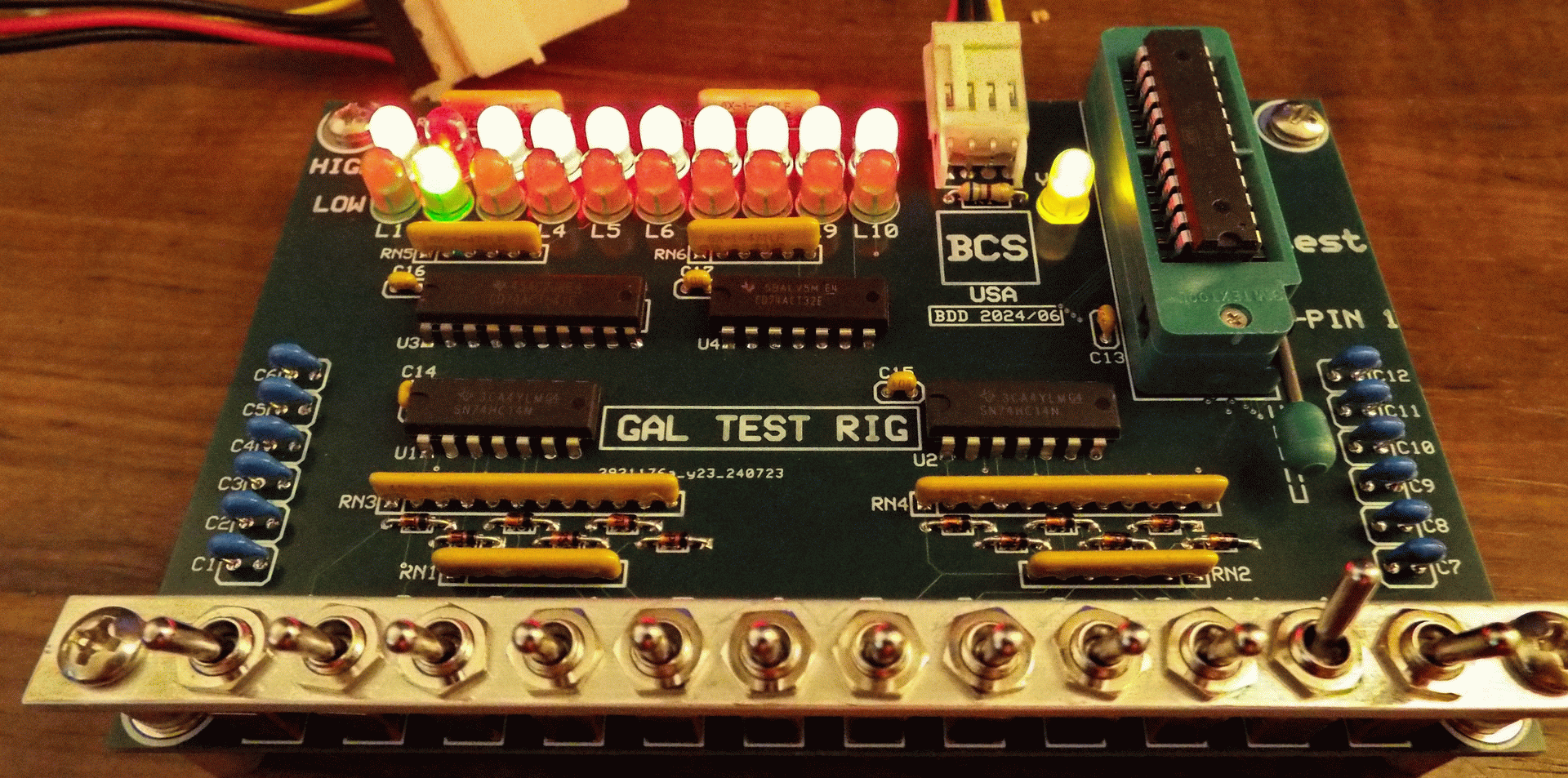

With that in mind, I decided to design and build a contraption that can prove that the logic outputs of a GAL agree with the designed logic and what WinSIM displays. Since the GAL under test would be in a “live” circuit in which inputs may be switched between low and high, it should possible to observe output behavior using a scope or logic analyzer under quasi-dynamic conditions. Hence there would a possibility of seeing an anomaly that would not be apparent in simulation.
While it is possible to monkey-rig a GAL and some LEDs on a breadboard, a breadboard’s sometimes-flaky connections may introduce problems that will produce false results. I figured it would be better to build a test gadget that could produce repeatable results, which meant it had to be fault-free in all respects. So what I’ve done is expand on the monkey-rig concept to produce something that is easy to use, unambiguous in operation...and trustworthy.
The test rig I built is designed to test a 22V10, which device has 12 dedicated input pins and 10 dual-purpose pins, the latter which may be programmed as inputs or outputs. In my application, I am assuming that the dual-purpose pins are all outputs, an assumption that simplified the test rig’s design, as well as contained its cost. I’m powering the test rig with 5 volts from an old PC power supply, since I always seem to have several laying around.
For convenience, the rig has a ZIF socket for the GAL under test. I was less concerned with the cost of this socket than I was with its reliability and durability, so I chose quality over cheapness—unsurprisingly, it’s the most expensive single part on the rig.
The rig has an array of toggle switches to control the GAL’s inputs, the switches being debounced so they don’t introduce glitches that might mistakenly be seen as something caused by the GAL itself. Each output on the GAL being tested ultimately drives a red/green pair of LEDs to indicate state, with the usual “red-means-high” arrangement.
As GAL outputs are TTL, I used 74ACT drivers to control the LEDs. I did not bias the drivers’ inputs high or low, which means if the unit is powered with no GAL in the socket, or if one or more of the GAL’s outputs is floating, the corresponding LEDs will display random states. A fancier design could be made to detect such a condition and disable the corresponding LEDs, but I didn’t want to go to that much trouble.

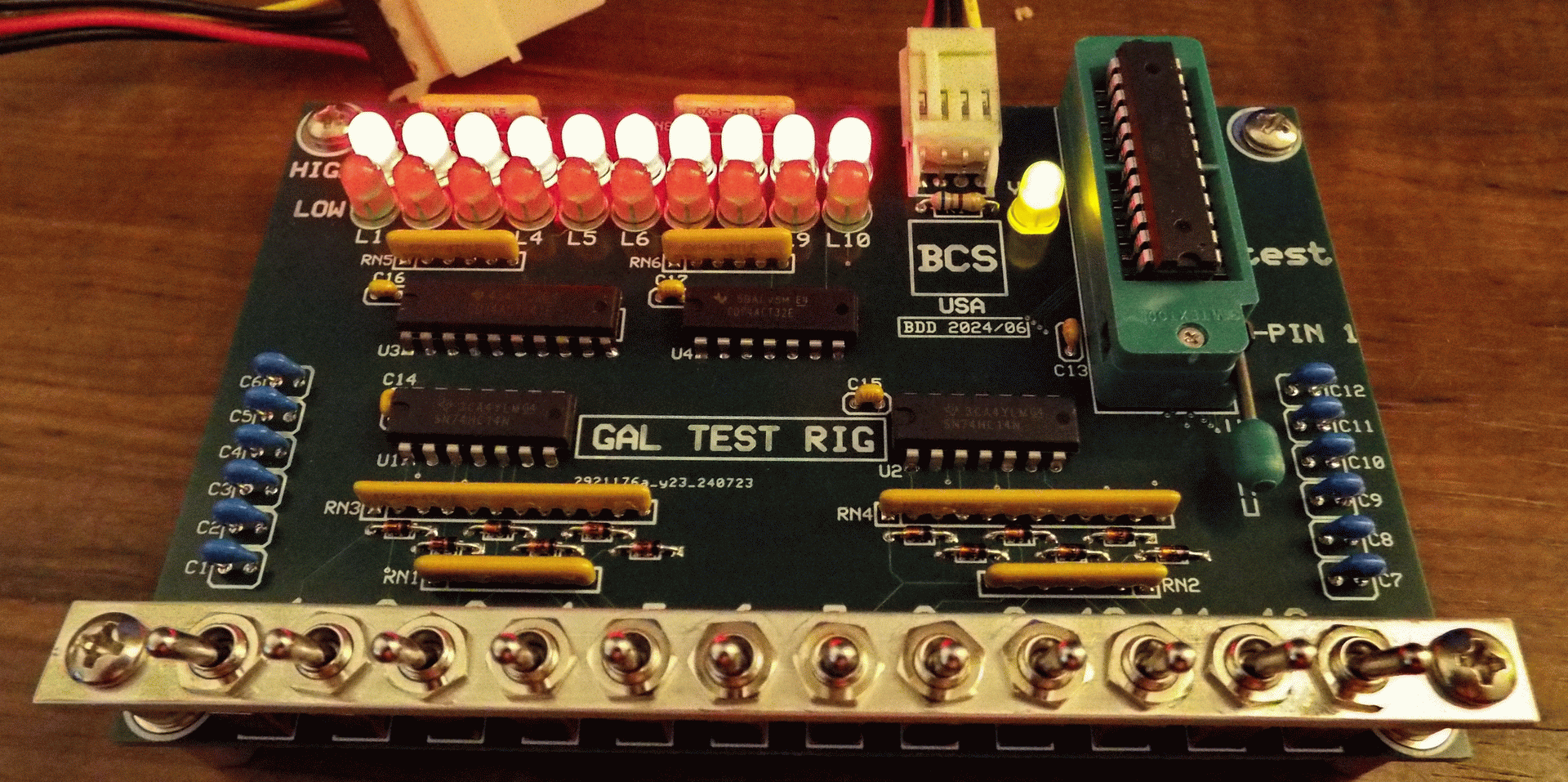

...and here are some photos of the finished product.
The switches, from left to right, control the following inputs to the particular GAL that was the test guinea pig:
- A15, A14, A13, A12, A11, A10, A9, A8, A7, A16, VADR, RWB
The switches are generically numbered 1-12, since their functions will naturally depend on how the GAL under test has been programmed. In this case, VADR represents the ORing of the 65C816’s VDA and VPA outputs.

During initial testing, I took some voltage measurements for posterity. VCC under load was 5.04. The GAL’s unloaded VOH was ~4.2 volts—in this circuit, loading is vanishingly-small, with only the inputs to the CMOS LED drivers and some parasitic capacitance seen as outputs change state. Curious as to how well the GAL can drive a load, I applied 3.3K to several outputs being driven high, which caused VOH to drop to ~3.7. Increasing that load to 1K caused VOH to drop to ~3.5. These results were significantly better than the data sheet specifications. The GAL’s VOL was typically 0.12 with a 1K ohm load tied to VCC, also better than specified. In a practical application, a GAL usually won’t see such loading.
What follows are some photos with the guinea pig in the socket, the test rig powered and various input combinations set. After a period of operation, the GAL got noticeably warm, which is typical of these devices.
Above, VADR is false, which means the address bus state is undefined, a condition that occurs during intermediate execution cycles of some 65C816 instructions. All GAL outputs are in the false state, which is what is expected.
Above, VADR is true and the effective address is $0000xx, resulting in RAM being selected. The GAL’s /WSE (wait-state enable) output is false, since RAM accesses do not require a wait-state. /WSE is represented by the leftmost red/green LED pair and /RAM is represented by the second-from-the-left pair.
Above, VADR is true, RWB is high (read) and the effective address is $00E0xx, resulting in ROM being selected. /WSE has been driven true, since ROM accesses must be wait-stated. Had RWB been low (write), /ROM would be false. /ROM is represented by the third-from-the-left LED pair.
Above, VADR is true and the effective address is $00C00x, resulting in /SIOA (DUART #1) being true. Again, /WSE is true, since I/O must also be wait-stated. Although RWB is high, it’s a don’t-care if the effective address is selecting anything but ROM. /SIOA is represented by the rightmost LED pair.
Above, VADR is true and the effective address is $00C08x, resulting in /SIOB (DUART #2) being true. Once more, /WSE is true, and RWB is a don’t-care. /SIOB is represented by the second-from-the-right LED pair.
