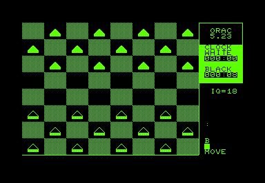

V - Toggle different graphic shapes for black pieces.
M# - Set a randomisation factor. Bigger for more random the play. M0=off, M1 default. (M0 .. M15 <RETURN>).

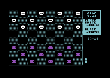

F1 - Change the foreground colour. (F1 key) (C16: CTRL-D)
F3 - Change the background colour. (F3 key) (C16: CTRL-E)
F5 - Change white piece colour. (F5 key) (C16: CTRL-F)
F7 - Change black piece colour. (F7 key) (C16: CTRL-G)

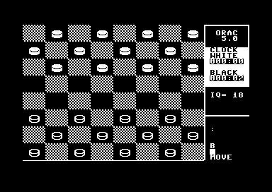

(PET screenshot)
PLAYING THE GAME
You can enter your move by using the Cursor keys to move up/down/left/right, then hit SPACE to select the piece you want to move. Repeat to select the destination square. You can also make moves by typing in the from-to square numbers, followed by RETURN. To show the square numbers, hit N <RETURN>. When playing the game, remember that IF YOU CAN JUMP, YOU MUST! This is a very important rule. For a short tutorial on playing the game, see the end of this document.

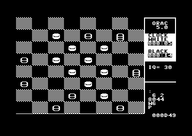

The C64 version, when thinking, shows on the right the best move so far, its eval in hex, and at the bottom a node count in hex.The eval is a two byte integer, about $8000 for an even game, higher for a black win, lower for a white win, etc. It uses the usual game searching methods - Alpha/Beta pruning, short-look ahead to sort move ordering, and so on. The IQ setting determines the search depth, about 4 IQ points for each ply, however jumps do not count as a ply, and are scanned deeper.
In end games (with Kings) Randomisation will improve ORAC's play, try setting M3 up to M15 <RETURN> if ORAC is repeating moves in a winning position. When you first run ORAC, there are 8 sample problems to try - L0 .. L7 <RET> loads them, white to play and win.
To get a quick idea of the game, try running ORAC using the auto-play feature (A command) from a new board with different IQ settings.

As things stand this program is still a "work in progress" - you might say somewhat slow progress! ORAC was fairly strong for its day, in testing it beat other 8 bit commercial offerings like the Fidelity Checker Challenger stand alone machine. But in reality there is plenty of room for improvement, particularly in the endgame, which is rather weak. Detection of position repetition, which requires storing all game moves, would greatly improve play. Also simple endgame databases could be implemented, for example 1 king vs 1 king lookup is about 200 bytes (32x32/5) plus access code. On larger 6502 platforms, small transposition tables would improve performance. Of course these days there are very strong checker programs for modern platforms in the public domain, do bear in mind that a modern PC is over 1000 times faster than a 6502 PET/C64/VIC computer - ORAC is from a different time. (ORAC was first advertised in PCW, June 1981!)
The original PET version is included here (ORAC88PET.PRG), its runs on PET BASIC 2.0 (2001/30xx) type machines. It was written using an early home-made assembler, with patches hand assembled and applied later, so its a bit of a mess. I had to "resource" and untangle this for the C64/VIC/C16 version, although more work is needed. I tried to keep the original 6502 engine functionally the same for now, which makes bug checking easier. I moved some critical engine variables to zero page (board etc), which improves speed by 10% or so. This code is also smaller, needing about 3-5K or so. The PET version (ORAC88PET.PRG) randomises selection of moves if they are of equal value, which is best for actual play. For testing it is possible to disable randomisation by typing: POKE 6409,96 after loading but before RUN. If you turn off randomisation in the new version (M0) it should play the same!
The PET version has vestiges of an interesting feature I tried in an early version (see memory location $192f). It would scan the board in 5 square "X" patterns (like a 5 on a dice) and, using 3 possible square values (white, black, empty) use a lookup table of 243 (3^5) bytes to get a "score" for that particular pattern. This little bit of 6502 asm is an early example of pattern recognition code. It didn't really seem to work well with ORAC, I didn't see a gain in performance, and it slowed down the search, so I patched it out. But I note that more advanced versions of this (with more sophisticated/bigger patterns, more memory, faster computers etc) seem to be used with success in more recent game playing programs.
Now follows a short tutorial on the game, since checkers is not so widely played these days. I hope you find ORAC fun, and maybe useful. Enjoy!
INTRODUCING THE GAME OF DRAUGHTS
(Vic20 screenshot, white to play and win in 17 moves.)
(For the rest of the tutorial and rules, see first post in this thread, or orac.txt in orac523.zip download.)

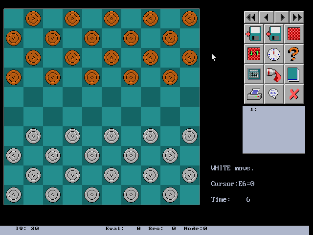

Just to add - I have released another related program:
DYNAMO DRAUGHTS is a program that plays International (10x10), Canadian (12x12), Spanish, American Pool, Portugese and Russian (8x8) games. It is moderately strong for its time, has many features not found on modern programs, and it was widely featured on many magazine cover disks and shareware libraries back in the 1990s. The original DOS version is included, together with a text/console version for win32 and linux, which compiles with C99 compatible compilers.
Download dynamo v9.18 with source:
dyna918a.zip
(242.93 KiB) Downloaded 47 times
Screenshot:
Now the interesting(?) thing is - I cannot find any 6502 program that plays 10x10 International draughts! So I was trying to get the c99 text version of Dynamo to compile with cc65, but it keeps throwing out-of-memory, even targeting a plus4 or c64. Can anyone suggest a better 6502 (C89) C compiler?
I may have to go back to much earlier simpler version to make it work.
It was not written with the 6502 in mind. The stripped binary of the Linux txt version is 38k. If it does compile, it might be the only 6502 program for these variants.
The best thing of course would be 6502 ASM, but it's a tricky job. Oracs engine was less than 3k, so it would be possible.
