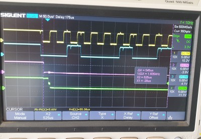

An aside: PS/2 keyboard or mouse use a 5v Vcc so I assume TTL logic levels, right? So another level converter required there, since I intend to use the STM to talk to it.
PostPosted: Tue Nov 21, 2023 10:18 am
Posts: 287
Location: South Africa
I haven't read the PS2 spec (which I probably should do) but I tested two keyboards and they both run up to about 5V on signals.
('scope set to 5V per div, clock in yellow, data in blue)
