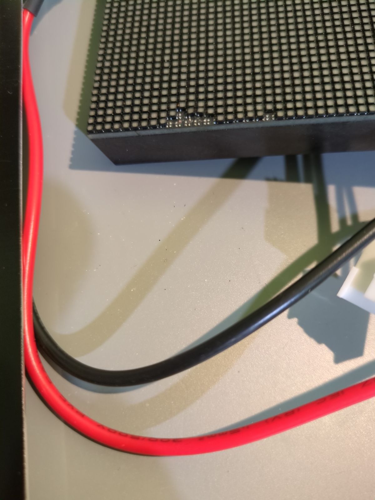

I’ve converted the clock module to a soldered breadboard. Testing it isolated from the other modules was fine, all power-or-two count bits measured correctly on the scope. However, when connecting to the hexadecimal keypad module and the NVRAM byte editor module the keypresses went haywire. It turns out the long wires were getting too noisy, picking up some clock-switching spikes, and creating false keypress signals on the keypress event line. Adding a 22pF capacitor on either or both ends of the event line cleaned that up. Here is the state of the modules with the soldered clock module in place, and the upper left breadboard cleared and starting to be populated for a font editing module.
I'm planning for the font editor to have the CPU in the loop. One byte of memory mapped input to grab switch up/down states, and three bytes of output to drive the 8x8 matrix and the address LED bar.
Re: Locked room challenge -- bootstrapping a design and buil
Posted: Thu Aug 03, 2023 1:19 pm
by Dr Jefyll
Glad you got the project working, but I won't be surprised if problems like this continue to crop up. And you're not the first to experience issues. The outputs of modern WDC CPU's and WDC peripherals (also certain modern RAMs and logic families) have aggressively fast rise and fall times, making AC performance problems -- especially on solderless breadboards -- a recurrent theme on this forum.
It's partially missing the point to think long wires (meaning signal lines) are the source of the trouble. The other half of the equation is the power/ground network that carries the signal line's return current back to the signal's origin. :!:
The signal line and its return path form a loop which, like it or not, behaves as an inductor... and this unplanned inductance wreaks havoc where high frequencies are concerned (such as the high frequency components of the fast rise and fall times I mentioned). Hence it becomes desirable to reduce the area of the loop and thus its inductance. Shorter wires will reduce the loop area but another remedy, usually more easily applicable, is to provide return paths that are physically close to the signal paths.
You may want to evaluate your project's power/ground network from the perspective described here. The real-world relevance of the matter is validated by other posts in that thread, notably including plasmo's.
Have fun, and keep us posted!

Thanks Jeff! Indeed, shoring up the power network stabilized the modules wonderfully -- I'm running solidly at 12.5875 MHz as desired with no issues.
Here is my latest progress, a font editor module (used already to create a decent 5x7 font for all the printable ASCII characters):

These display panels are quite bright, and draw a lot of current, hence the beefy power cable. Here is a close up of where some teensy surface mount pixels got knocked off:
The wee SMD pixels can be broken off easily with rough handling.
