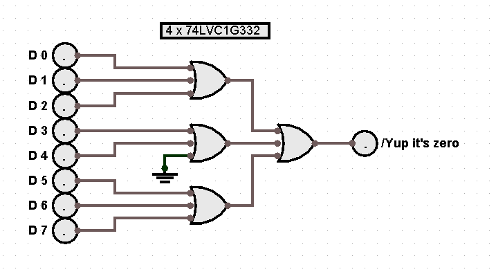

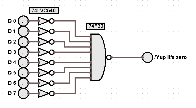

Given easily available ICs today I'm wandering what is the quickest circuit for determining if 8 signals are all zero. That's quickest in terms of time and ideally fewest ICs needed.
I suspect the answer is:
Detect Zero.png (10.96 KiB) Viewed 9812 times
but I'm hoping I've missed an obvious single chip solution.
I know there used to be an 8-input 74 series OR gate but it doesn't seen to have ever been manufactured in one of the fast families and doesn't seem to be generally available anymore.
I'm using a '540 because that's sacrificing something like half a nanosecond to allow a single IC to do the inversion as compared to two '04s.

Edit: those might be too slow, though. Perhaps consider two four input gates and a two input to combine their outputs?
If I drop all the way down to 3-input ICs then I can do the following:
Detect Zero.png (9.29 KiB) Viewed 9804 times
Which is marginally faster than the F family solution in my first post. But, gah(!), that's four tiny ICs. And they're not cheap either. A single 4-ciruit version would be awesome though whilst I'm making wishes a blindingly fast 8-input OR gate would be perfect.
A GAL?
Which brings me to Gordon's suggestion which, if I use one of my precious ATF16V8C-5JXs and program my own 8-input OR gate, would be even faster (by the datasheet) than all the other solutions. Owe, that pains me to use a GAL but if I'm scrabbling for nanoseconds... that's on me.

Anything in the CMOS 4000-series will be too slow. I’m not aware of any eight-input OR that is available in any of the fast logic series. Input inversion on a 74x30 (I've used TI’s 74AC11030, which is the high-speed version of the older 74HC30) is practical if the extra prop time is tolerable.
A possible substitute would be to program a 16V8 GAL to act as the equivalent of the 74HC30, the logic being /Y=!(A&B&C&D&E&F&G&H). It would be simple combinatorial logic that would incur no more than the device’s pin-to-pin prop delay. Microchip’s currently-produced GALs are available down to 7.5ns, which is comparable to the 74AC11030’s prop time on five volts.
Something to consider is in the realm of bank $00 detection, you only need to decode the number of bits you are actually using. In a 512KB system, that would be three bits.
