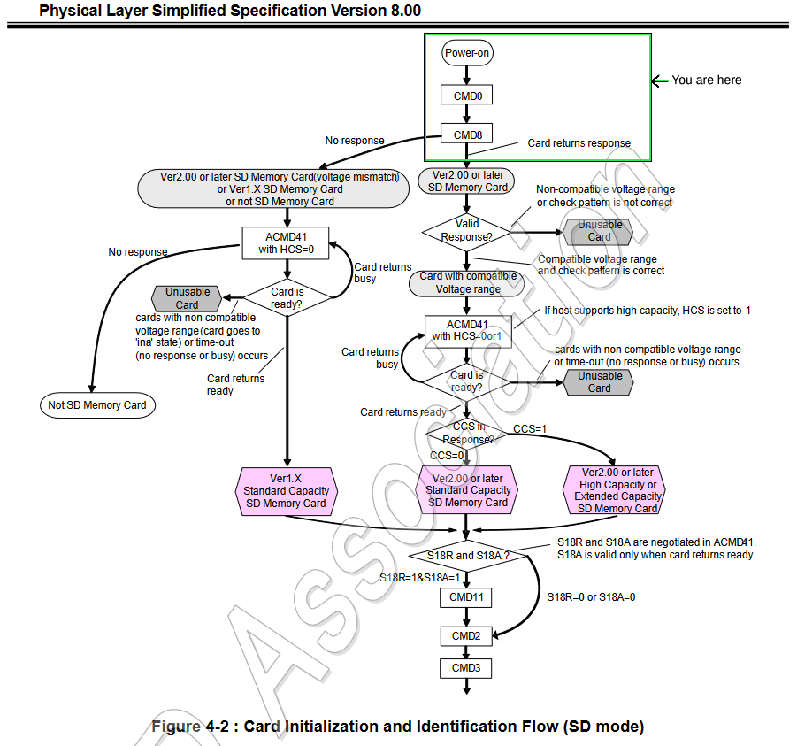

With that out the way let the adventure begin with trying to initialise an SD card.
First you have to put a newly powered up card into IDLE mode by sending it cmd0 and then send it cmd8 to ask what voltages it supports. Before you can send cmd0 you you have to set CMD high and tick the CLK 80 times at 100KHz. Or maybe you have to tick the clock 75 times. Or none. I ticked it 8 times and the category 10 SanDisk card I'm using seemed happy.
Again before cmd0 can be sent to put the card in SD mode DAT3 must be set high too. In theory all you DAT lines should be set as high impedance inputs and each should have a 10KΩ+ pull up resistor on. I used pull down resistors (because of course I did) so I had to set DAT3 as a high output because I couldn't rely on the (non-existent) pull-up resistor to do it for me. Still worked fine though. CMD should also have a 10KΩ+ pull up resistor. If DAT3 is set a low output the SD card will switch into SPI mode at this point.

You're not the only one. Yes, I could have used SPI mode just like everyone else. But where's the fun in that?
At the moment, I'm bit-banging the interface in software. The VHDL interface is waiting for a better understanding of what it needs to do, freeing up some space in the FPGA, and for me to find sufficient time and strength to do it. That's going to be a long wait.
The specification is a very big document. The information you need is scattered all the way through it. Hit your head against it enough, and you will eventually learn how to find things. But there will always be surprise bits of information in footnotes in chapters you haven't even glanced at. They'll turn out to be important.
My power-up sequence goes:
  • CMD0 "GO_IDLE_STATE"
  • CMD8 "SEND_IF_COND"
  • CMD55 "APP_CMD", ACMD41 "SD_SEND_OP_COND" with argument 40100000 (HCS=1, voltage = 3.3). The R3 response has HCS and the supported voltages set. Repeat until bit 31 of the response is 1.
  • CMD2 "ALL_SEND_CID" with argument 00000000. The R2 response has the CID. I ignore it.
  • CMD3 "SEND_RELATIVE_ADDR" with argument 00000000. The R6 response contains the RCA and some status that I ignore.
The card is now in the stand-by state. Reading a block is accomplished by
  • CMD7 "SELECT/DESELECT_CARD" with argument bits 31-16 = the RCA you were given, 15-0 = 0. The R1b response I ignore.
  • CMD17 "READ_SINGLE_BLOCK" with argument = the block address. The R1 response I ignore, but there will also be the block data. Keep toggling the clock, and you'll eventually see a start bit followed by a block of data and a CRC.
For a while I was trying to send CMD12 "STOP_TRANSMISSION" and wondering why I wasn't getting a response. But that command can only be used if you asked for multiple blocks. I'm OK with the inefficiency of reading blocks one at a time, so now I don't send it.
I haven't implemented block writes yet.
You'll need two CRC routines. I found them fairly straight-forward, following the description in section 4.5. I do them one bit at a time as the bit is sent, rather than trying to work a byte at a time. There are examples in the specification to test with, and I can provide more if you need them.
I can post my code if it would help. It's for my 65020 CPU, which although derived from and compatible with the 6502, is not a 6502. You wouldn't be able to use it directly.

Actually your previous comment was a life saver. I was sending ACMD41 with argument 0x40000000 instead of 0x40100000 because I was reading the SPI argument format instead of the SD mode argument format (that bit is reserved and should be 0 in SPI mode). My card was just sitting in an endless busy loop and had me stumped. I suspect ACMD41 with argument 0x00000000 would have worked too but that's an experiment for another time.
So far I've gotten CMD0 to CMD8 to CMD55 + CMD41 (ACMD41) to give me a positive response in SD mode I'll post up some of the timing quirks I ran into in a longer message later. Also worth noting the 74 CLK ticks before CMD0 are required by the specification (page 231) and the 8 ticks after CMD0 are too but I can no longer find where I read that.
Other interesting mistakes I made. CMD55 (the first half of an application specific command) has a response (R1) and testing with an oscilloscope attached rather than a logic analyzer was invaluable as I could see that both the Pico and the Card were driving the CMD line at the same time.
I used 47KΩ pull-up resistors but I should have used something smaller (10KΩ being the smallest suggested). They didn't pull-up fast enough so when I put the Pico CMD pin in input mode it immediately saw a low voltage and thought it was the start transmission bit from the SD card. The work around I'm using is to set the CMD pin as an input (i.e. high impedance) for 4 clocks ticks before I start reading from it and looking for a low. The SD card generally starts driving the CMD line around tick two and starts transmitting around tick 7 after the end of the command transmission.

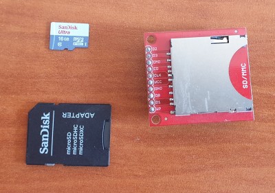

Yup I'm using this SanDisk card (with a Sparkfun breadboard adapter)
... and I've managed to get it stuck in modes where it just will not respond without cycling the power.
I'm going to probably go the same route where I can get a card working and stick with it; there's just too much wriggle room in the spec. I like the SanDisk 16GB Ultras because they're *really* cheap but run fine in high performance mode.
(And the back of the board that has the important socket signals on it)
