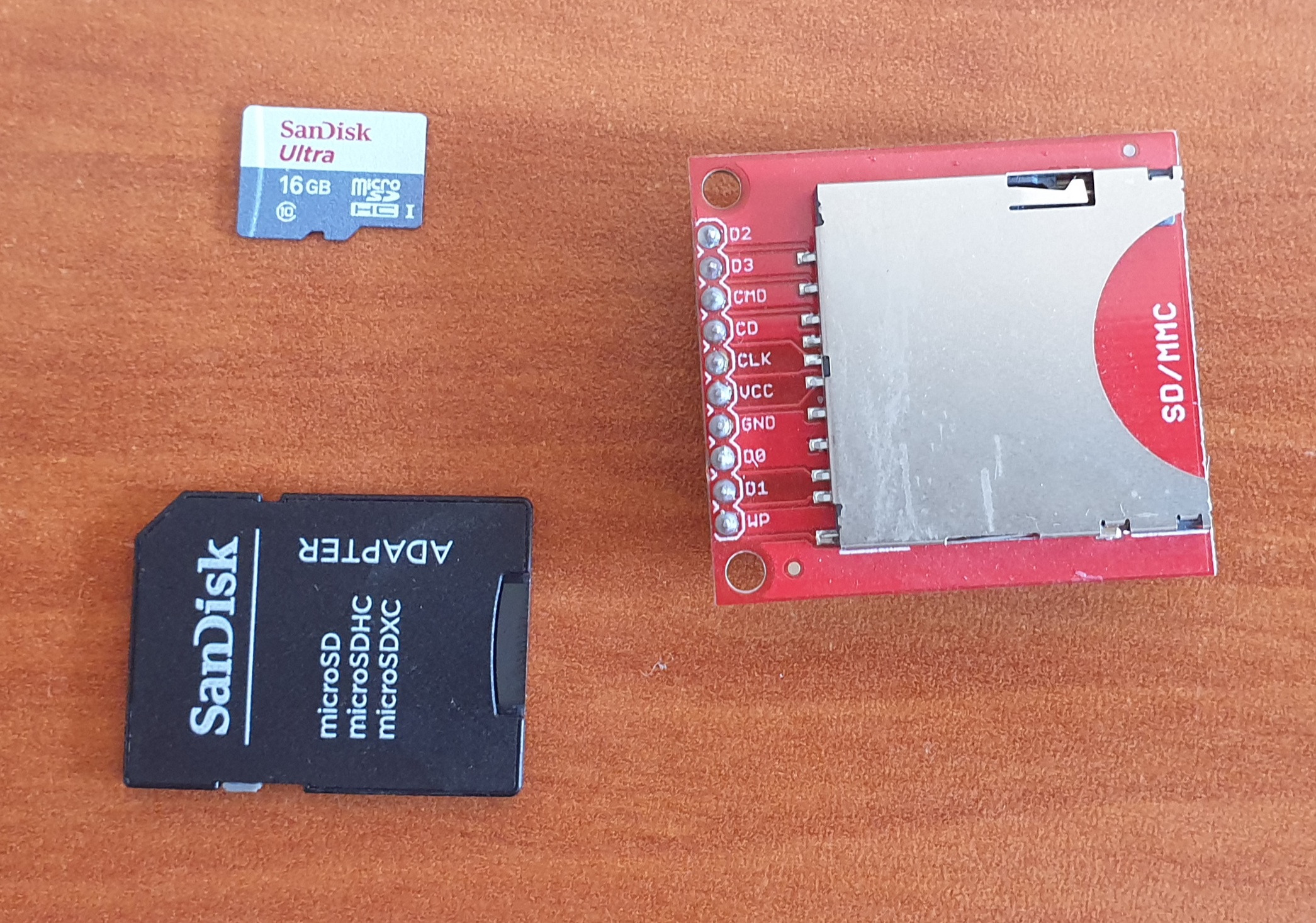

Sometimes I worry about myself. I could have just been normal and used an SD card in SPI mode like everyone. But, no, I had to be special and try to use an SD card in SD mode. Unlike every. single. other. person who has ever posted anything about using SD cards.
So this post falls somewhere between a plea for help and a tutorial on how to use an SD card in SD mode.

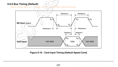

For example: When is data on the CMD line read by the card? Is it when the CLK transitions high-to-low or low-to-high? Or something else? It's on page 273 under bus timings. Like. I. just... AaaaghI only found that after a muddy version in a twenty year old SanDisk datasheet that clued me in on what to search for.
Incidentally, the answer is low-to-high. The SD card reads data on the CMD line when the CLK goes low-to-high. And the host must similarly read data on the CMD line (presented by the card) when the CLK goes low-to-high.

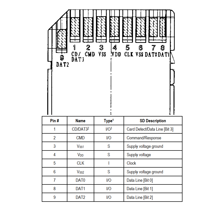

Speaking of CMD, below is an SD card pin-out:
With that out the way let the adventure begin with trying to initialise an SD card.

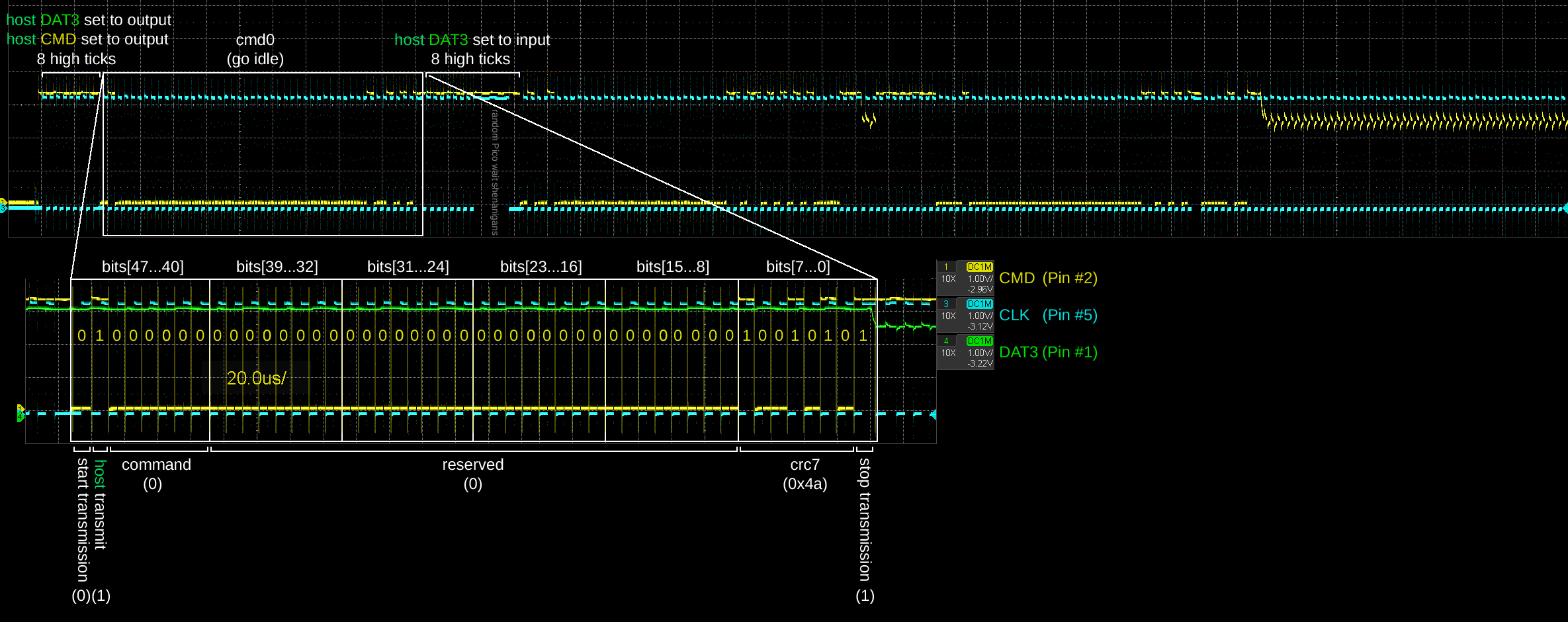

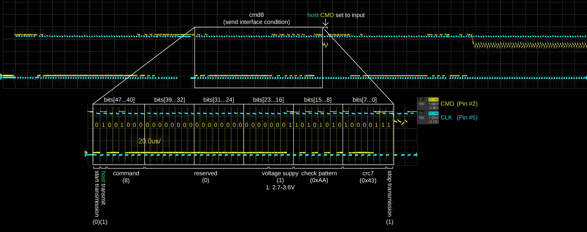

Next we're going to jump straight over how to send commands and take a look at what a successfully sent command looks like on an oscilloscope. A picture really is worth a thousand words.

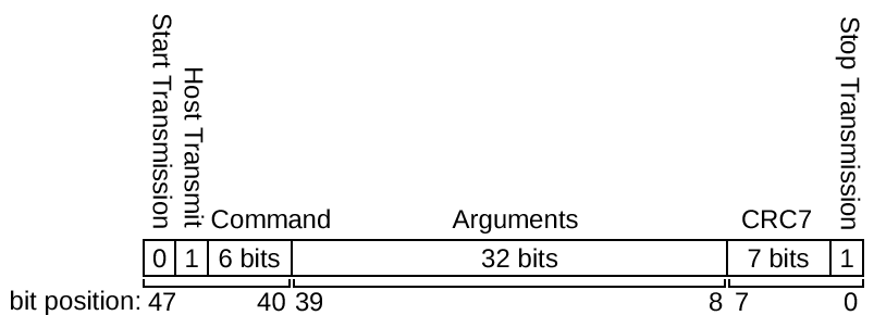

A SD card command has the following form:It is sent on the CMD line at one bit per CLK tick from the highest bit first, bit 47, until the stop transmission bit, bit 0. The stop transmission bit basically just leaves CMD high so that the next transmission start bit can be detected. With that said it has been suggested that CLK should be ticked 8 times after cmd0 has been sent to allow the card to initialise itself. Is it necessary nowadays? I don't know but I'm afraid to not tick the clock of the idle command now.
The argument bits to cmd0 are ignored but best practice is to send all zeros. It's also worth noting there is a bit of confusion around the internet on what the CRC of an SD card command is (either in SD mode or SPI mode). The SD card command uses a crc7 with the generator polynomial: x7 + x3 + 1. For the five cmd0 zero bytes 0x40 00 00 00 00 that 7 bit crc is calculated to be 0x4a. To bring it to 8 bits the stop transmission bit is appended to the end making the 6 byte for cmd0 0x95. 0x95 is not the CRC 0x4a is.

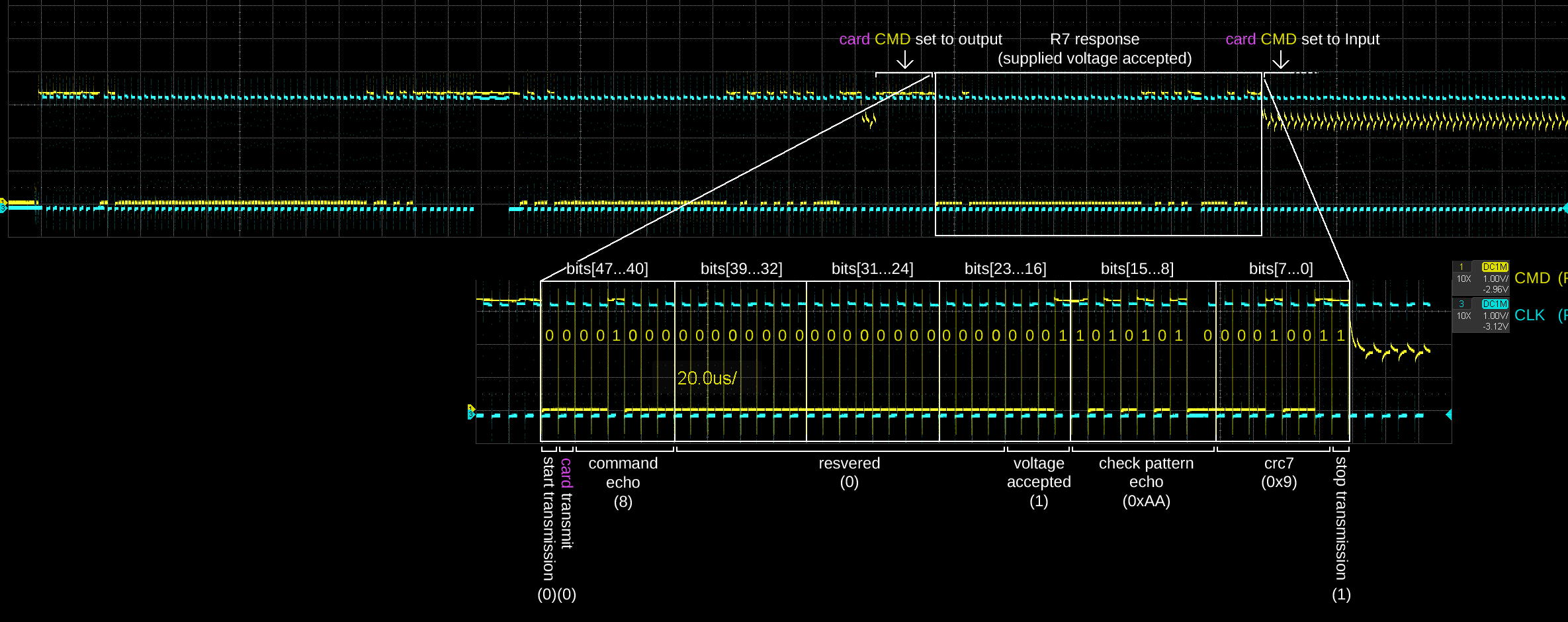

In the attached oscilloscope screenshot you might have seen that I hold the clock high for some time after I'm done ticking cmd0. That's not intentional, it is an artifact from the Raspberry Pi Pico I'm using to bit-bang out the signal. I suspect it has something to do with the debugger but having it attached or not makes no difference. The Pico pauses occasionally but very consistently.
After the SD card has been placed in idle mode with cmd0 (and there is no response to cmd0 so in SD mode so you just have to hope it worked); then cmd8 must be sent to select the allowed supply voltage. Practically there is only one voltage option so set command bit 16 to a one. Bits 19 to 16 are the voltage arguments but I think it might be best to steer clear of low voltage SD cards for hobby projects.
cmd8 is useful in that it also has a check pattern that will be echoed back in its response. I've used 0xAA but the choice of bits is entirely optional.
Once I'm done banging out the command the CMD line must be set to input as cmd8 expects a response. The line briefly goes to a noise high impedance state from both the Pico (the host) and the SD card. I did eventually swap out my pull-down for pull-up resistors.
Within two clock ticks after completing the command send the SD card has grabbed the CMD line and started driving it high.
A few clock ticks later and the SD cards transmission start bit (a zero) is seen on the CMD line followed by another zero indicating it is the card transmitting. CLK is still being driven by the Pico and is never set to be an input.
The most interesting thing to note here (apart from getting any response at all from the blasted card) is the the check pattern being echoed back. Bit 16 will also be set to indicate the card supports 3.3V. The long clock on the last check bit is, again, the Pico doing some random wait thing.

I used 47KΩ pull-up resistors but I should have used something smaller (10KΩ being the smallest suggested). They didn't pull-up fast enough so when I put the Pico CMD pin in input mode it immediately saw a low voltage and thought it was the start transmission bit from the SD card. The work around I'm using is to set the CMD pin as an input (i.e. high impedance) for 4 clocks ticks before I start reading from it and looking for a low. The SD card generally starts driving the CMD line around tick two and starts transmitting around tick 7 after the end of the command transmission.

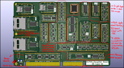

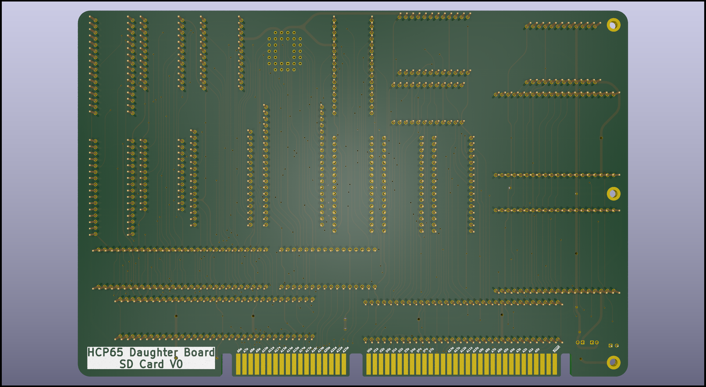

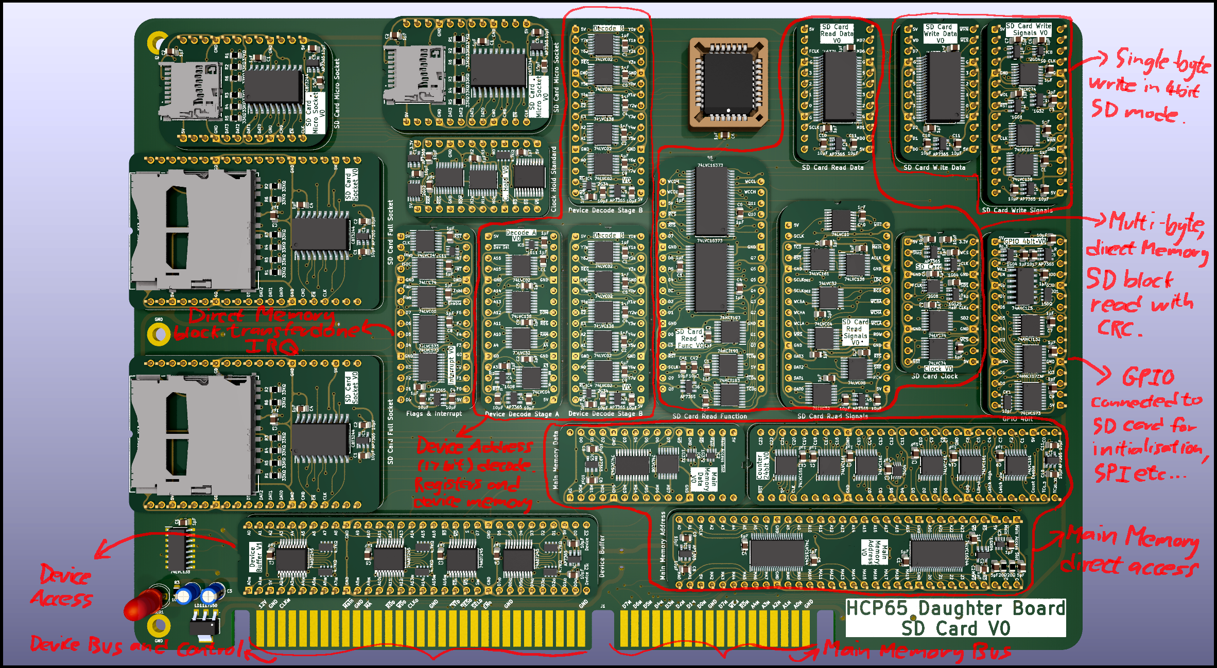

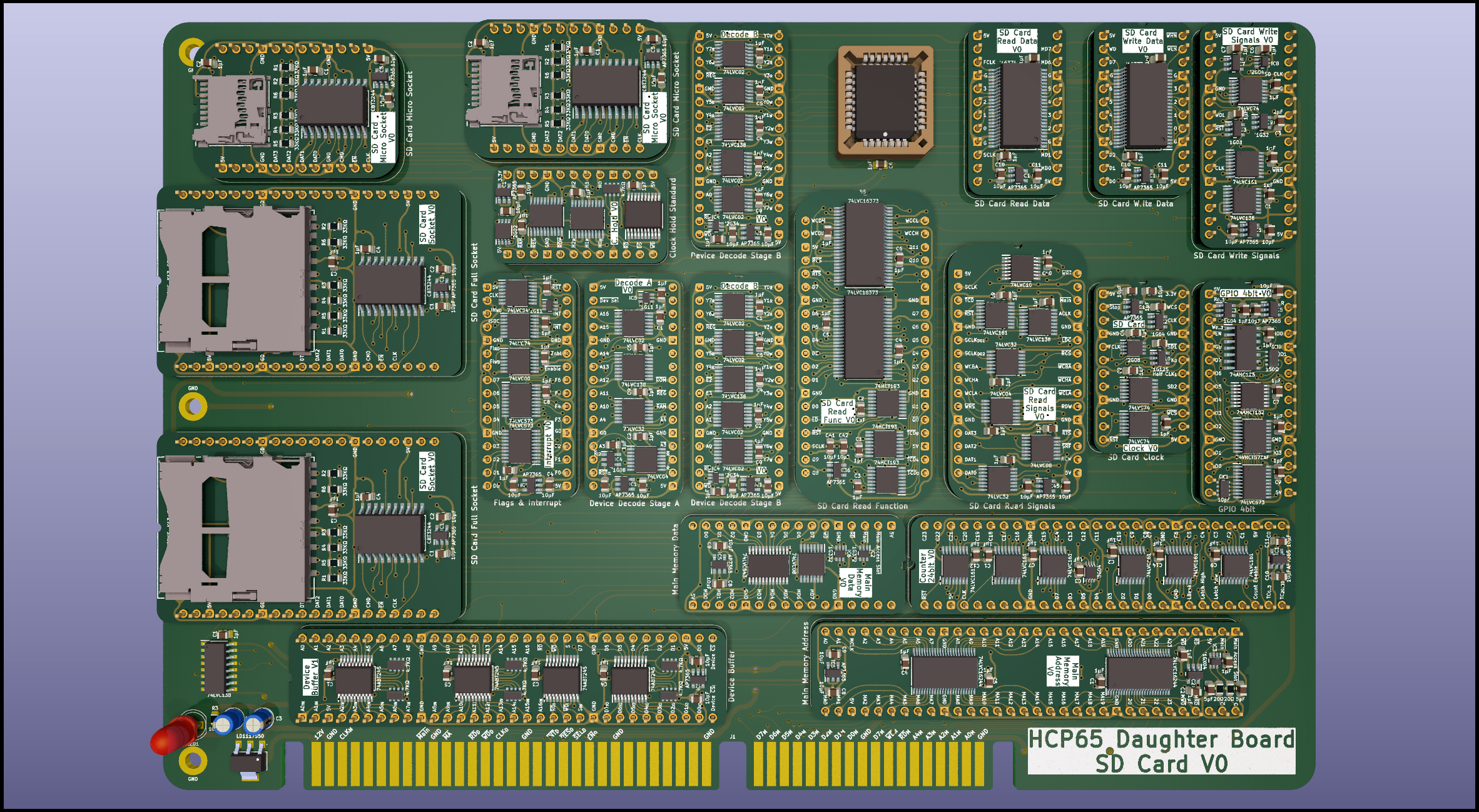

Low effort post incoming because I found myself with a a bit of time this afternoon as I lost my business analyst.
There's been a bit of discussion around SD cards so I decided to dump of where I am with SD card access so far. For those wondering I'm trying not to use programmable ICs and I'm accessing the SD card in 4bit SD mode which is where the absolute proliferation of 74 series ICs comes from.
Nope, no schematic or anything so profound. Proper low effort. The theory is that reads must be fast and should require no processor intervention once started. 512byte SD block reads are configured in the SD Card Read Function board as are the 16byte (? - I'm to lazy to check) CRC reads. They're ticked out into the W65C816s main memory address space by the 24bit Counter board.
The state of the read: waiting to start, reading data, reading the CRC or setting the done interrupt; are controlled by the SD card Read Signals board as well as whether the high or low nybble is being read from the SD card. Those nybbles are buffered and built into a byte in the SD Card Read Data board. The SD Card Clock board tries to control the madness and make sure that bytes are available to the main memory bus timeously. The CRC is ticked out of the SD card by the read circuitry but it is not checked for correctness.
Writes are much simpler as a byte is written to the device and then ticked out to the SD card over two clocks as the high and low nybble. The CRC must be calculated by the '816 and ticked out following the data bytes.
The Device Buffer board is a standard Device component that turns the 17bit Device address bus and 8bit device data bus on or off depending on the device select signal. It also handles device presence, enable, reset and interrupt signals. Device accesses always clock stretch the '816. How many cycles long the stretch is is controlled by the Clock Hold Standard board and depends on whether the device identifier ROM, onboard device RAM or device registers are being accessed.
The Device Decode A board decodes the device address into device identifier ROM select, device RAM select or device registers select. The Device Decode B boards decode 8 device registers each - split into read and write signals.
The Main Memory Data and Main Memory Address boards turn the main memory address buses on and off. Main Memory is access is never clock stretched. The W65C816 is taken off the bus when main memory access is happening.
The Flags and Interrupt board controls resetting the device as well as setting and clearing the device IRQ. The generic 6bit flags control which SD card socket is selected.
And somehow this has taken me 30 minutes to type already. So... happy sleuthing and kudos to you if you can work out what is going on from the pictures
(And the back of the board that has the important socket signals on it)
