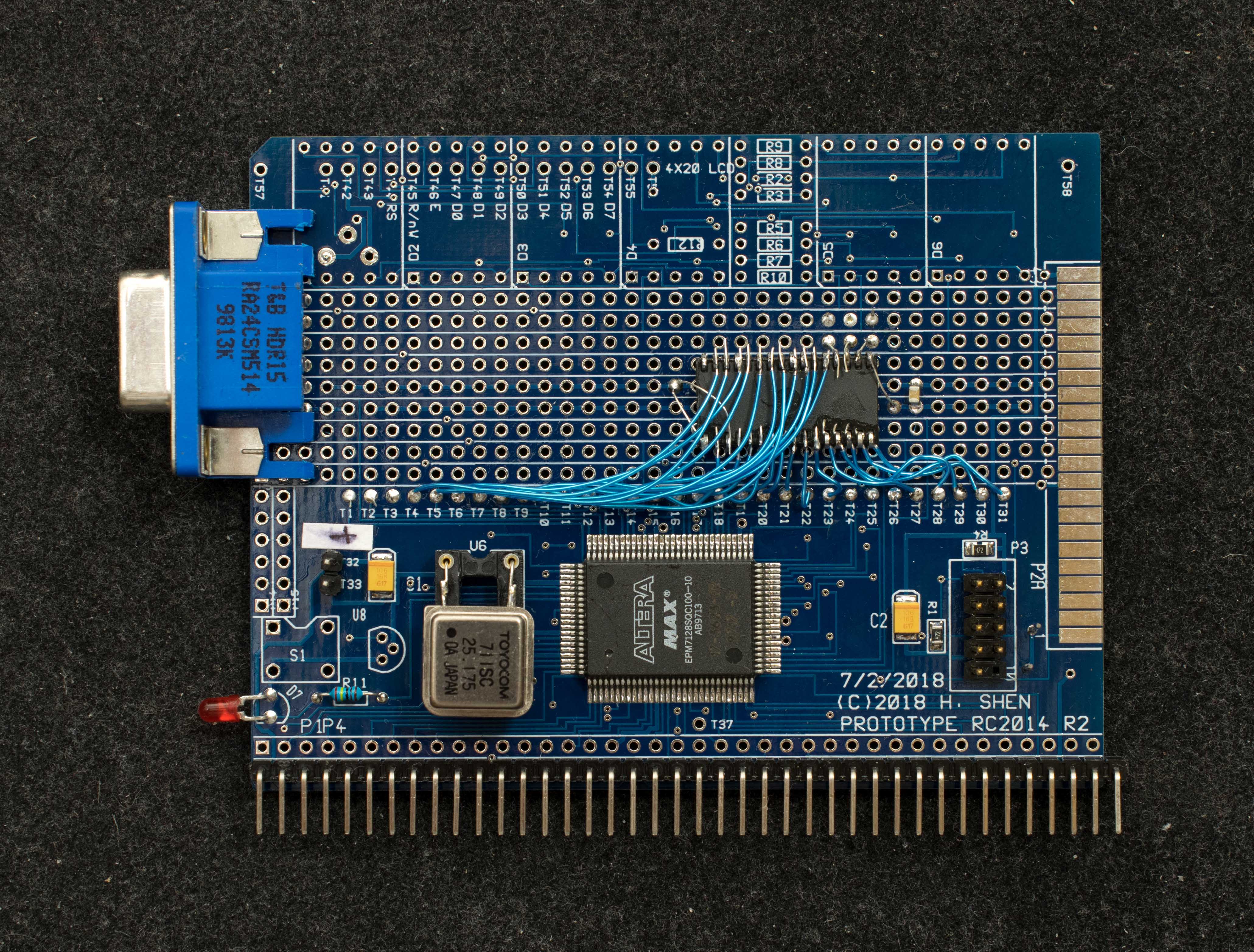

Chad's topic on VGA and Dual port RAM design has inspired me to take another look at Apple II style of multiplexing video RAM access with 6502 access. Apple II is 1MHz but we now have much faster W65C02 and faster RAM so this design uses 25.175MHz VGA clock and divides it by 2 to drive W65C02 with 12.6MHz. W65C02 can access the video RAM at high phase of the 12.6MHz clock while VGA controller has access at low clock phase.
The schematic is drawn in Altera Quartus tool. The top half of the schematic is similar to Chad's design where horizontal sync and vertical sync are formed from cascaded divided-by-800 and divided-by-525 counters. The bottom half is new, consists of a bank register that selects which one of the 32 banks will be accessed when write to memory window $C000-$CFFF; and a data multiplexer that presents high nibble of data to the video display at high phase of 12.6MHz clock and low nibble at low phase of 12.6MHz clock. The display format is 512x480 with 3 bits representing RGB colors.
The reason the video RAM is accessed via a 4K windows is because 512x480 3-bit data takes 122K bytes of memory. It will consume twice W65C02's available memory space if the entire video RAM is directly accessible like Apple II. So a 4K graphic window is a reasonable solution. The graphic data byte is packed so upper nibble data 7 to data 5 represent red, green, blue values of one pixel and lower nibble data 3 to data 1 are RGB value of next pixel. There is one more bit available, but I'm not sure what to do with it. It can possibly serve as 50% intensity control.
The design is simple to implement, just a fast (25nS) 128KB RAM and a modest CPLD, EPM7128S. The design needs significant number of I/O pins that's why CPLD in 100-pin QFP is needed. It plugs into a RC6502 backplane controlled by a 6502 SBC.
Topics I want to explore with this hardware are:
* Combined text-based VGA with graphic VGA
* More color depth, e.g., 3-bit red, 3-bit green, and 2-bit blue
* Reduced resolution, e.g., 320x240 for faster screen repaint.
* How to add sprites.
Top_scm.pdf [27.5 KiB]
Downloaded 82 times

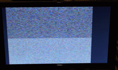

You are correct that each 4K windows will draw 16 lines on the screen. I have not centered the image, yet. I just want to make it work first without muddying the water.
Attached is an animated GIF of three test patterns. I can write the video image anytime, but it still takes a while to fill 128KB of image with 12.6MHz 6502, about 1/2 second per pattern. This is where smaller sprites can produce smooth moving picture.
I'm also looking into the "snowing" effect as the images are updated. I believe the correct image is written into RAM and there are no conflict with VGA controller's read access, but I'm dealing with an analog system so digital noises can cause the snowing effect. This is where 4-layer PC board with separate analog section may be necessary to get best image.
Sprites, layering, mixing text & image, I predict I'll be spending lots of time playing with the video card.

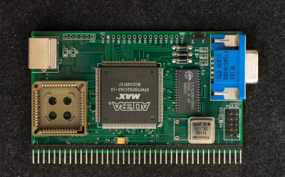

I continue to work on Apple II style of multiplexing video access with 6502 access. This is the pc board version of the prototype board with additional text-to-VGA dual-port RAM (not populated in the picture) and PS2 keyboard connector. I use a larger-than-normal CPLD, EPM7192S, to give me more room for experimentation. I believe I can overlay text over graphic background, but I'm also thinking about using the dual-port RAM as buffer for sprites that overlay the graphic background. The connector at bottom is for RC6502 bus and designed to interface with CRC65 SBC. In this configuration CRC65 is operating at 25.175/2=12.6MHz. The graphic memory is 128K with 512x480 display area. The color depth is limited to RGB plus 50% intensity bit.
Good thing about multiplexing video access with 6502 access is the graphic RAM can be access any time at full 12.6MHz speed. Below is a video of CRC65 @ 12.6MHz writing test patterns to 64KB out of 128KB of graphic memory. I want half of the graphic display stay in blue background while writing, as fast as possible, other half with test patterns to look for "snow effect". I'm happy to report that there is no "snow effect".
