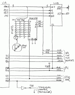

Hello everyone, my name is Chad, I'm very new here, this is my first big post (besides the Intro topic).
This will be my first computer. I'm designing a 65C02 uP + 62256 SRAM + 28C256 EEPROM+ 65C22 VIA computer, probably clocked around 1 MHz. My guidebook has been Garth's "potpourri" page:
https://www.wilsonminesco.com/6502primer/potpourri.html
With a configuration very similar to this one, I'm wanting to interface the 6522 with:
1) A 20+ button keyboard (16 plus some more for controls/options/etc)
2) A larger 128x64 LCD, 8-bit parallel input if at all possible for speed purposes.
3) A SPI interface for an SD card.
The keys could be put into whatever column-row configuration that is most efficient. 4x5 is easy but 2x10 is possible I think. I'm not picky about 20 keys exactly, but definitely 16 at absolute minimum.
I've been reading that PB's shift register won't work with the SPI interface (easily) and Garth's page recommends using PA to "big-bang".
I see also that the 128x64 parallel LCD's I'm looking at have 20 pins on them, though not all should be used. Here is something I'm looking at, there are a ton of these things, but this is just a basic idea to get us on the same page:
https://www.winstar.com.tw/products/gra ... aphic.html
So 8x Data pins, 2x Column Select pins, 1x Data/Instruction pin, 1x Enable pin, I think the rest do not need to be connected to the 6522.
Lets do a running total:
SPI -> 4 pins
LCD -> 12 pins
Keys -> 4 input pins, 5 output pins. Garth has a 16 key 4x4 configuration.
So, 4 + 12 + 4 = 20 pins, which is just at the max of the 6522.
An alternative is to write to the LCD using SPI or some other serial method, but I fear it not refreshing very well. I have zero experience with them, besides that my TI-83 has a quite terrible refresh rate. I'm wanting to be able to use it for small video games or demos, so the refresh rate is very important.
Recommendations about what should go where? SPI and Keys on PA, while LCD goes to PB? Would the shift register in PB be useful for serial LCD data transfer?
Lastly, I have never used a 6522, but by Garth's suggestion I'm trying to implement it in my design. It is an incredibly power IC but I don't know how to harness that all yet.
Thank you all for any suggestions!

PostPosted: Mon Oct 11, 2021 8:18 am
Posts: 8545
  • Two pins are for the LED backlight; so those won't need to go through the VIA.
  • One pin is for RST\, so you can connect that to the system's RST\.
  • One is for the viewing angle (called "contrast adjustment," but it's really to get the best contrast for the desired viewing angle, so I wish they'd just call it "viewing angle"), and that will typically go to a pot of some kind, although another way is to control it digitally through a D/A converter.
  • Electrically, it appears to be two LCDs in one, so there's an enable line for each. The R/W, RS (register select, ie, data versus instruction), data lines, and the others are all in common with each other.
  • I don't see anything telling about the VEE or the instruction set at the link. It says VEE is an output; but I suspect it's a negative voltage input for the backplane, as is common with supertwist LCDs, and that you'll have to supply a negative voltage. That won't come from the VIA either.
So the VIA connections would be identical to those of a 40x4 intelligent character LCD which is electrically like two 40x2's, one on top of the other, which I've used.
Here's one idea for connecting the things you want to a single VIA, with a little bit to spare:
There are 24 keys, electrically arranged as 8 rows by 3 columns. The 8 rows are fed by the '138. There's a Schottky diode in series with each keyswitch so there's never any contention. I forgot to draw in the pull-up resistors on the 3 columns. If you want more switches, one possibility is to make one of the keys a shift key, to double up on functions of the other ones. Keys will have to be debounced in software of course, and a shift key would never get auto-repeat, and maybe only cursor keys would get auto-repeat.
There are select lines for two SPI devices. If you want to put half a 74HC139 section in there, you could make it three (with the fourth combination meaning "deselect everything." You can't operate the SPI port at the same time you're scanning the keypad or feeding the LCD, but I doubt that will be any problem. There's probably a way to further multiplex things to get a printer port on the same VIA. What's another VIA though. I have three on my workbench computer; and if ever get around to building my next one, it'll have four.
The LCD's register-select input is on the same line with the I²C clock; but it should not be a problem as long as you don't try to feed the LCD while something is still selected on I²C. The I²C start condition is made when you take the data line down while the clock line is high. As long as you keep these things in mind, everything should play happily. The VIA's various registers let you do what you need.
The VIA's own hardware synchronous serial port, or "SR" for "shift register," is useful for interfacing to chains of I/O bits on ICs like 74HC595's, 74HC165's, 4094's, and 4021's. CB2, the data line, also enables the '138 when you want to scan the keypad. It should seldom if ever be a problem that you can't keep the SR port going while scanning the keypad. The beeper is one of those .015"-thick ones like you find in greeting cards. It's like a tiny brass speaker, using AC to drive it, not DC, so PB7, outputting a square wave, either under software control or toggling PB7 each time T1 in free-run mode times out, determines the beep frequency. I put the inverter and 470Ω resistor in there as a buffer, so the piezoelectric element's capacitive load doesn't cause problems.
I use T1 (timer/counter 1) in free-run mode on the same VIA to produce interrupts for my real-time clock for time of day, calendar, alarms, and timing various short intervals, and feed the beeper in software instead of from T1.
Hopefully I didn't overlook anything.

Thank you Garth, that is amazing. Simply amazing. And, just to be 100% sure, I'm attaching my addition of the pull-up resistors for the columns. Are they correct? It's attached at the bottom I believe.
So you are correct about that LCD. Apparently the one I grabbed is not like others! Some have two column/controller selects, some have none at all, but ALL of them have an enable. Can I ask why it's important to not simply ground R/~W? I have seen many configurations where folks ignore the reading of the LCD because it's mostly insignificant. Assuming I will have the 2 separate selects AND an enable, could I just replace the R/~W line with Enable in this layout? Attaching the ~RST to the 6502 was a great idea!
This is what I was using as my basis of understanding the 2 select lines:
https://www.engineersgarage.com/128x64-graphical-lcd/
Cool to have 2x SPI interfaces. Makes sense too! I'm definitely going to use something like this on one of them:

The data sheet is your friend. :D WDC has a description of each pin's purpose. 8) Inputs should not be left floating on any CMOS device. Outputs should be connected as needed, otherwise left unconnected.
But as for this DS1813 on NMIB, I am confused. That LM809 is actually supposed to be a DS1813 at this point, and it's connected to RSTB.
The LM809 is not a substitute for a DS1813. The DS1813 will respond to its output (the reset line) being grounded. The LM809 is only input-voltage-sensitive and will not respond to something grounding its output. In fact, doing so may cause damage.
So am I supposed to have a second DS1813 connecting to NMIB? What is the difference in comparison with RSTB at that point? I know they can start at different memory locations, but it sounds like the same functionality that a Reset button would do?
Again, the 65C02 data sheet is your friend—please thoroughly read it before you get too far along with your project.
NMIB (Non-Maskable Interrupt) is an active-low, edge-sensitive interrupt input, whereas RESETB is an active-low, level-sensitive input. Asserting RESETB starts the microprocessor (MPU) from scratch—RESETB must be briefly asserted at power-on for a proper start (note that all of this is explained in Garth's 6502 build tutorial).
Asserting NMIB interrupts a currently-executing program in a way that allows the MPU to later resume that program's execution once the event that caused the interrupt has been handled. Attaching a DS1813 (or similar device) with a push button to NMIB makes it possible to manually interrupt a running program when a logic error causes the program to put the MPU into an otherwise-unbreakable loop. In my systems, the NMI handler ultimately drops into the machine language monitor, which allows me to conduct a post mortem when something goes off the rails.
Sorry for the confusion, I'm new to this. I have never had times when I needed bacon to be saved yet!
Not to worry—wanting to save your bacon will frequently arise as you develop software for your machine. :lol:
/WE on the 62256 should be qualified with Ø2 to avoid a spurious write and possible corruption.
I really thought that I had done that. 74HC00C is ~A15 NAND Phi0, connecting to the 62256 ~CS port.
/CS and /WE are not the same thing. /CS (chip select) should be driven from the address bus decoding logic without clock qualification. /WE should be qualified by the clock and should only go low when Ø2 is high.
So I'm not using Phi2 because I'm using Phi0, as per the WDC guidelines to bypass Phi2 and simply use the external Phi0 instead. Am I wrong about that setup?
That is correct. When I use the symbol Ø2 I am referring to the clock in an abstract way, not to a specific signal. In this discussion, Ø2 means "two-phase clock" whose source in your circuit is your clock oscillator.
I'll be considering the feature creep, I don't want a project to be too overwhelming on my first go.
My mantra with this sort of stuff is learn how to fly a Piper Cub before you climb into a 747's cockpit and take off for Tokyo. :D
Oh, just checked on StarTech, and found something like this...I'm just weighing the options to either include or exclude something like this...
Having an interactive console is very useful during the debugging stages. I would never consider building a unit without that capability.
PostPosted: Mon Oct 11, 2021 11:14 pm
Posts: 718
BigDumbDinosaur, thank you for all of that information. Instead of quoting quotes of quotes, I'll summarize here.
Ok, got the idea with NMIB now, that makes a lot of sense. Thank you for reminding me of what I read before, with all of this so quickly I sometimes forget things too. Thank you for your patience with me.
As per Phi2 and 62256, I agree with your reasoning, that actually makes a lot of sense tying it into ~WE instead of ~CS. STILL, just to verify, my base model was Garth's "potpourri" model:
I am sure that I am seeing Garth put Phi2 on ~CS, not ~WE here. He did a big article about why he does this, and I was just following in step with mine. Again, your call to tie it to ~WE makes perfect sense, too! So, which should I go with? What is the difference?
Interactive console sounds super nice. Is this something that you would suggest?
https://www.electrodragon.com/product/r ... max232-ic/
PostPosted: Tue Oct 12, 2021 12:42 am
Posts: 8545
For someone going for the higher clock speeds, sure, get the RAM selects going early, and don't enable the write until phase 2 rises. I seem to remember you're only aiming for a MHz or two though, and SRAM will typically be the fastest thing on the bus, not needing the early select; so you can, in that case, get away with gating the select with phase 2. When you start pushing the speed limits, by all means, go with BDD's method.
I intend to address other things in your post further up when I get time.
