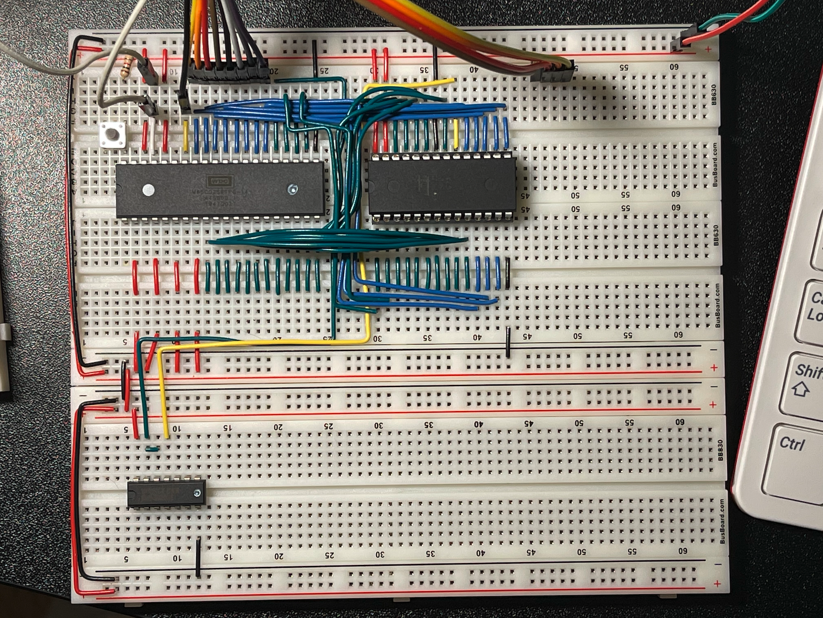

Pic of my circuit can be found here: https://imgur.com/a/V4fHCDu

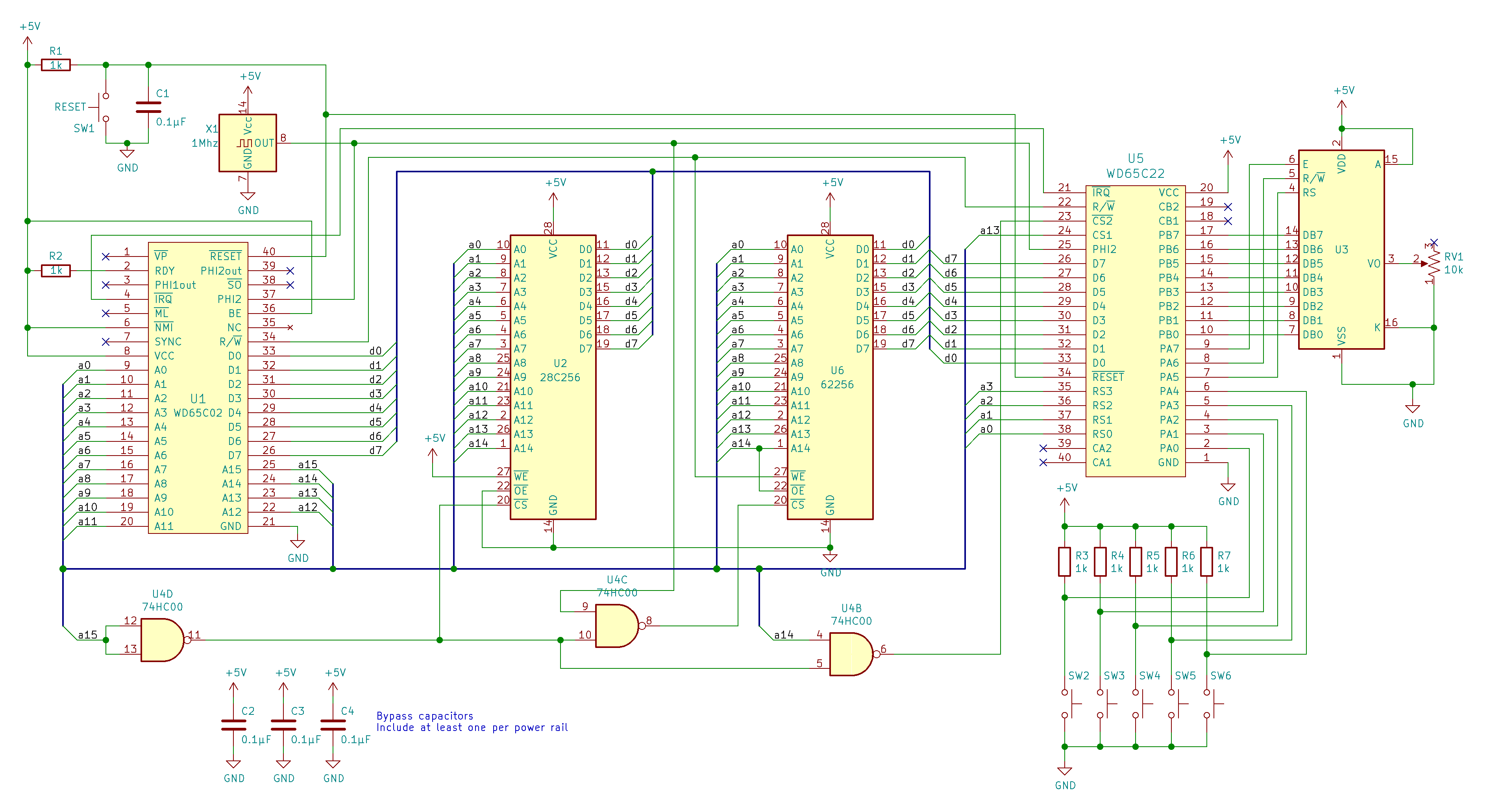

Lot of great replies, thank you!! Sorry for the image - I've attached an embedded image toward the bottom of this reply.

Reading your schematic diagram I found two mistakes. The OE pins of your RAM and ROM must be tied to the inverted R/!W of the 6502 nanded with the phi2 clock.
               _________               _________
               |      1|               |      &|
   R/!W -------|       |O--------------|       |
               |_______|               |       |O-------- !RD
   PHI2 -------------------------------|       |
The Write signal could also better synced with PHI2
                                       _________
   R/!W -------------------------------|       |
                                       |       |O-------- !WR
I hope this will help you any further.

Okay, so having had a quick glance at the breadboard, I do notice that there is a lack of decoupling/by-pass capacitors.
Normally it’s recommended to have one 100nF ceramic capacitor connected as close as practical to the +5V/VCC/VDD and 0V/GND pins of each chip. That’s one capacitor per chip.
It’s also a good idea to have a 10uF to 100uF electrolytic capacitor (bulk decoupling) on the board where the power supply connects to the board. On large boards, you would have a number of these distributed across the board.
You say that you are using a 555 timer for the clock. This chip, or at least, the bipolar version, alone needs a 47uF to 100uF electrolytic capacitor near it to counter the supply noise it generates when it switches it’s output and it’s discharge pin.
The NAND gate, it has unused input pins that are floating (not connected). This is not recommended. ALL unused inputs, even if the gate is not being used, should be connected to a known voltage. Either tied to 0V/GND or to +5V/VCC/VDD either directly or via a suitable resistor (depends on the logic family).
The reset circuit (65C02 pin 40) looks incomplete. I can’t see a capacitor there. The capacitor helps denounce the switch contacts. And where is the 0V/GND connection for the push switch?
Mark

The schematic is difficult to read because it's in color and is coming across as a gigantic image. However, I was able to note that SOB on the MPU is floating. That, like all CMOS inputs, must be positively driven to Vcc or ground, Vcc in this case.
Also, the 555 is a lousy clock generator. The output rise and fall times are much too slow. you should be using at the minimum a clock oscillator with CMOS output.

@1024MAK - The decoupling capacitors are what solved the issue and I'm ashamed at myself for taking THIS long to actually put them on the board. I have them on my clock module, which is providing power to the board with the 6502 circuit, but clearly they need to be widely distributed. Thank you!
