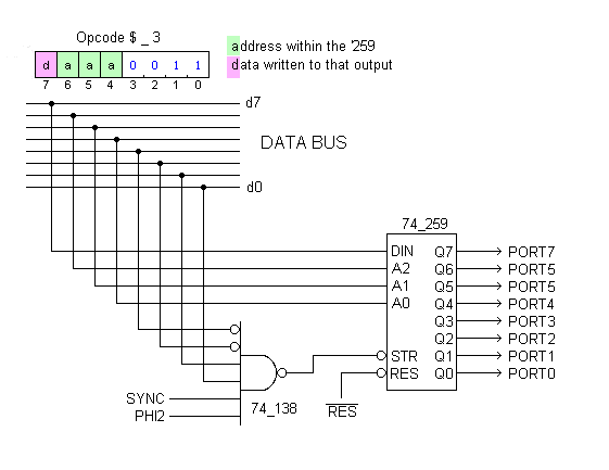

You may find an Ultra-fast output port using 65C02 illegal instructions helpful.
For starters, it'd be an extremely fast way to output horizontal and vertical sync pulses -- and, in regard to the horizontal sync pulse, you may welcome that extra speed. The horizontal retrace period is fairly brief, and during that time you'll also have other housekeeping to manage (such as updating the value in your zero-pg pointer).
More intriguingly, you could tap into the same "illegal instruction" circuit in order to derive a the cue for the shift register to load. Possibly there'd be an advantage to getting the cue that way, instead of generating it based on access to a certain portion of the address space.
One disadvantage of getting the cue that way is, the illegal instruction consumes a cycle... and you may or may not be able to afford that, depending on whether the LDA (z-pg),Y is expected to generate a page crossing.

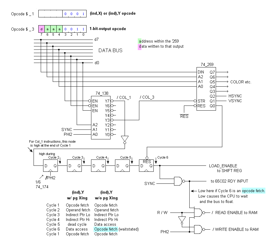

Alright, here's my followup to the "illegal instruction" VGA plan. But firstly some background... Earlier I mentioned the Ultra-fast output port using 65C02 illegal instructions, and I have edited that post to include a new option, one which also plays a role in the VGA idea. As shown below, the new arrangement provides 8 one-bit ports, each of which can be individually written using a 1-byte, 1-cycle NOP from Column 3.
74_259 approach allows 8 individually writable bits
Ultra-fast_65c02_output_port using a '259 .png (5.9 KiB) Viewed 82832 times
Adding to that, the circuit below also responds to opcodes in Column 1. (These are not illegal.)
The opcodes in Column 1 are all either (z-pg,X) mode or (z-pg),Y mode, and it's the latter that appear in Bill's little ditty:
LDA (z-pg),y
INY         ;the 2-inst'n sequence repeats 80 times to generate one line of 640 pixels
The LDA (zp),y opcode -- or any other (zp),y or (zp,X) opcode -- will cause the /COL_1 signal to go low at the end of the cycle during which the opcode is fetched. This gets inverted, and a one-cycle high subsequently makes its way through a delay line that's formed by 5 sections of a 74_174 hex D flipflop.
Referring to the cycle description included at the bottom of the diagram, we see that only cycles 5 and 6 will vary according to presence of a page crossing.
  • With a page crossing, cycle 5 is a CPU "internal operation." Cycle 6 is when the data access occurs and cycle 6 is when the Video Shift Register loads.
  • Without a page crossing, cycle 5 is when the data access occurs. Bus capacitance preserves this data for an extra cycle because on cycle 6 the data bus floats. Cycle 6 is when the Video Shift Register loads. The CPU is trying to fetch the next opcode during cycle 6, and that's why SYNC goes high... floating the bus and pulling RDY low for a single cycle.
There are some incidental details to attend to. The altered behavior of (z-pg),Y instructions exactly suits our needs for video, but we need a way to turn off the new behavior when not dealing with video. I've connected Q0 of the '259 so that a 1-byte, 1-cycle NOP can enable or inhibit the special response to Column_1 opcodes.
Q1 and Q2 of the '259 are shown as VSYNC and HSYNC outputs, and all the other bits remain available for whatever. They could be used to select colors, for example. Or... by adding another gate or two they could cause various other entire 64K regions to be activated during cycles 5 and 6!
Because it decodes instructions, this "video" scheme provides a potential means to let you read and write data of any kind from several, perhaps dozens, of other 64K banks at will.
I'll develop this idea further in a separate post, perhaps. But for now let me point out a highly pertinent point, and it is this: instruction decoding lets us know when the special memory access will occur. That's a crucial contrast with ordinary banking schemes, which rely on address decoding to tell us "when." :!:
If the "when" question ceases to rely on address decoding then you eliminate the regrettable need for the "window" -- a peephole within the 64K space -- that'd be necessary to trigger the address decoder. Instead of accessing the beyond-64K region as a series of peephole-sized chunks, you can access it in units which are each a full 64K. Peepholes suffice for some applications, but if you care at all about treating the new memory as a linear space (containing very large arrays, for example) then 64K units (similar to what the the 65816 uses, BTW) will perform a lot faster and give you fewer gray hairs than working through a peephole, IMO.

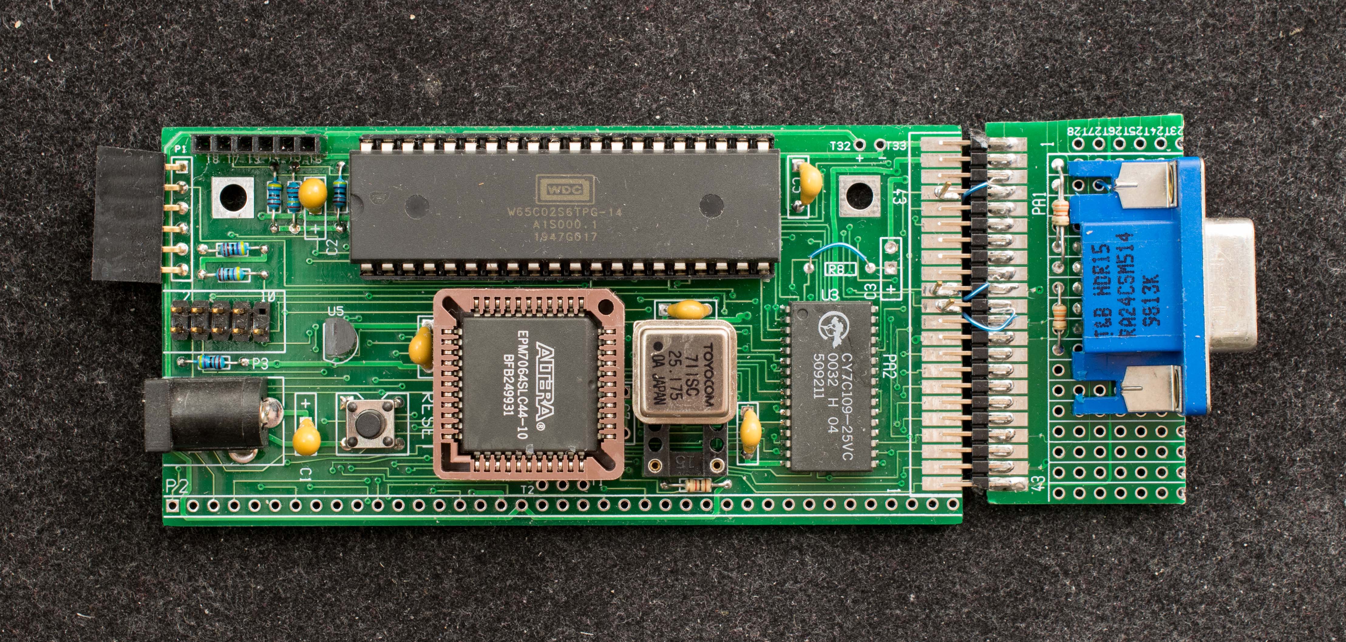

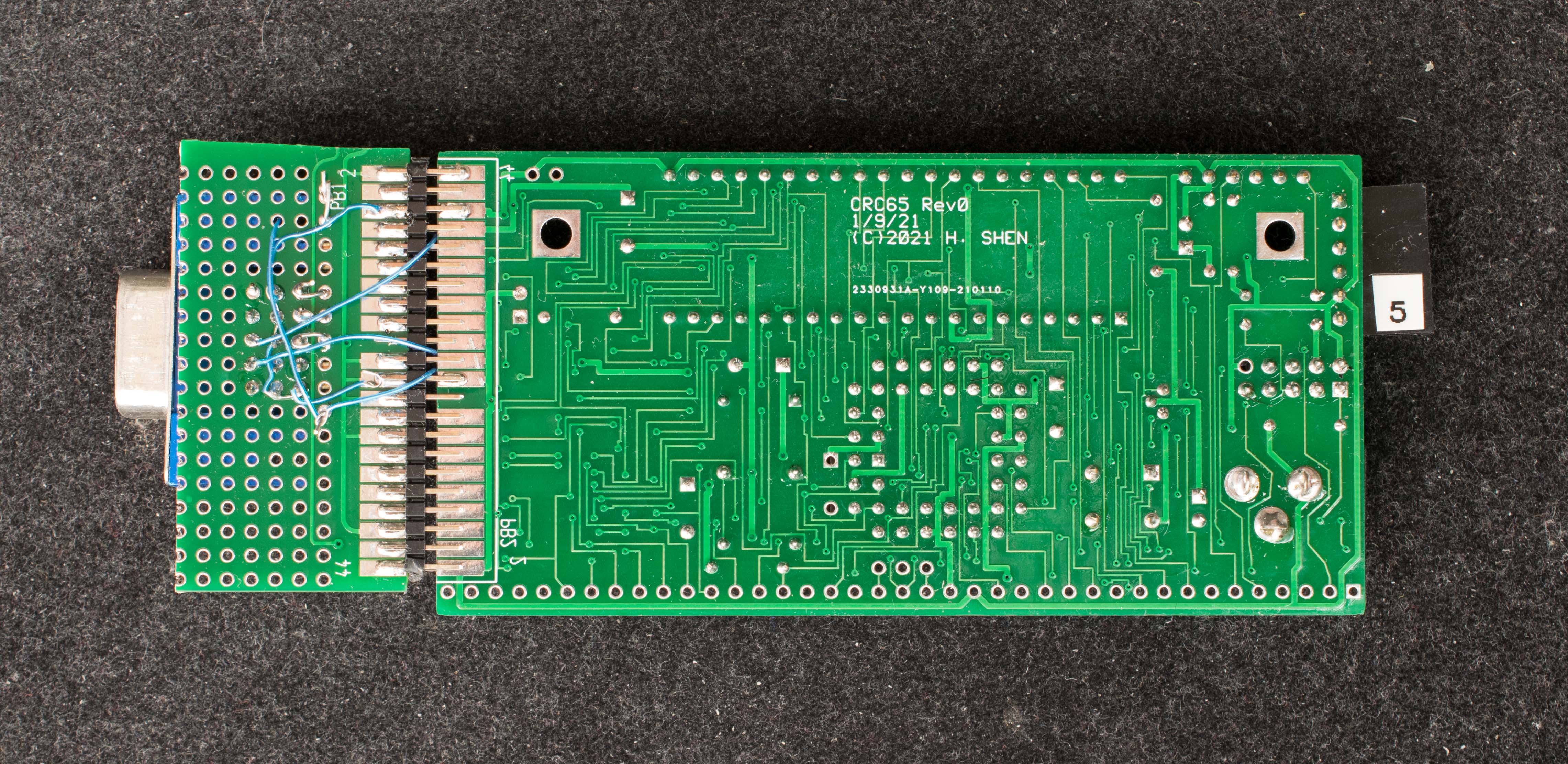

I modified a CRC65 SBC:
* 25.175MHz CPU clock
* Replace CF interface signals with VGA's Hsync, Vsync, Video out
* Replace CF adapter with a 15-pin VGA connector
* CPLD changes:
- Smaller, 32-byte CPLD ROM that can only bootstrap serially
- 8-bit pixel shift register capture and shift data bus in address range 0x4000-0xEFFF
- 2 latches for VSync and HSync
Program is located in 0x0-0x3FFF. It basically toggle horizontal sync on and off followed by 80 set of
.byte 3		;col-3 illegal instruction
LDA ($b0),y
INY

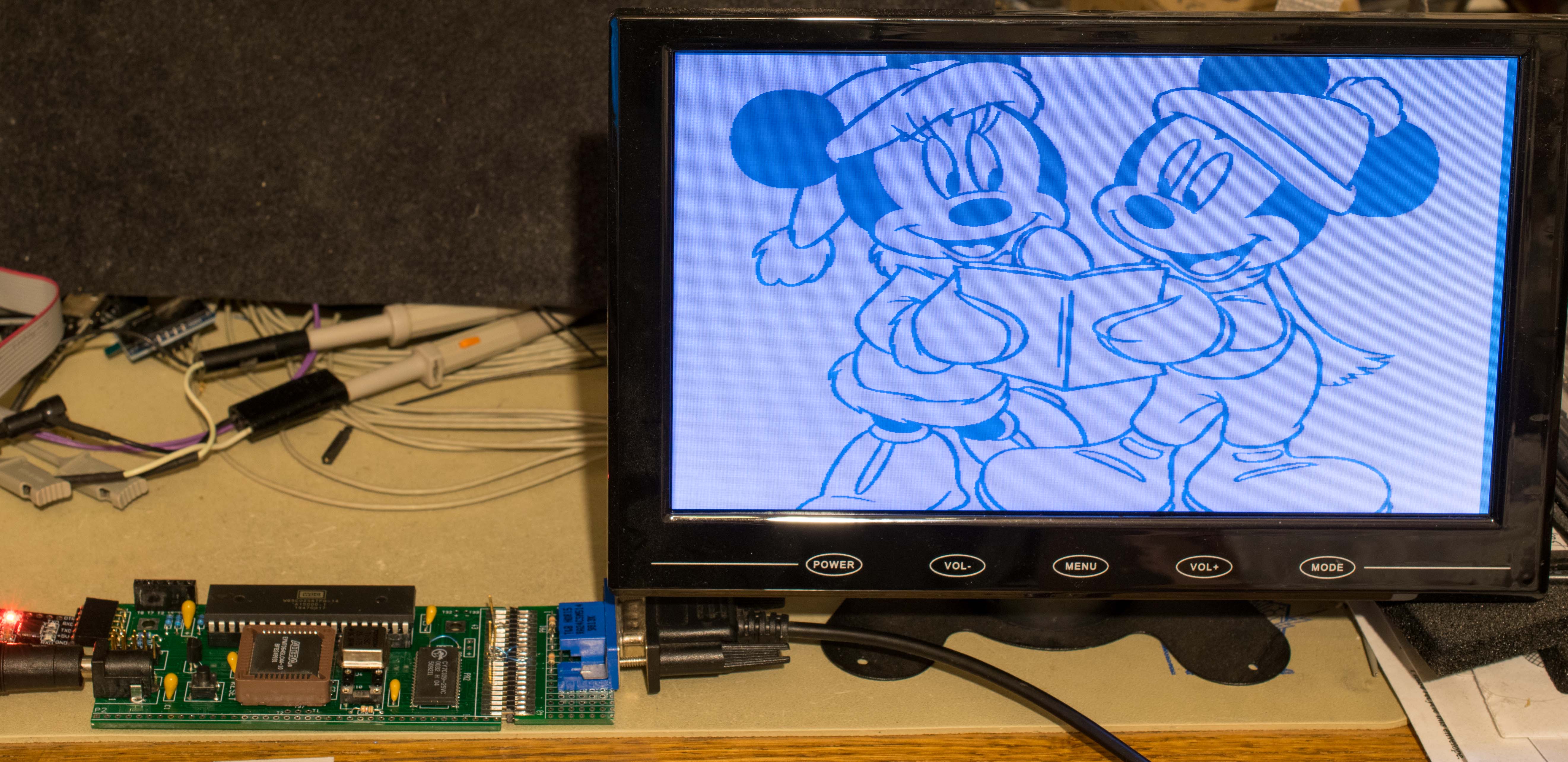

After 480 lines, it continue to generate HSync, but blank out the video output for 45 lines. It also generates vertical sync during the 45-line video blanking period. After every power cycle, program is loaded serially with the help of TeraTerm macro.
After much fiddling around, I'm able to generate stable video output suitable for display on a small 9" LCD VGA monitor. The problem is the software-generated HSync and VSync MUST be exactly the same or the display will flicker or even not lock in. That restriction is not too difficult to meet during the 480 lines of active video, but during vertical retrace where real work is being done, the requirement of generating precise horizontal sync is difficult to do, at least for newbie programmer like myself.

This picture can be displayed with software generated Horizontal Sync and Vertical Sync, but the program is tightly constrained because the HSync must be exactly the same, all the time, even during the vertical retrace interval. By using a 10-bit counter in CPLD to generate HSync as well as an interrupt to 6502, the 6502 software only need to provide 80 bytes of data per horizontal scan during the active video portion. During the vertical retrace period, 6502 is free to do other tasks, such as manipulation of graphic data, without having to deal with the tight timing constraints of generating horizontal sync. At 60Hz frame rate, the vertical retrace time is 1.4 millisecond per frame or 86mS of free time per second. That may seem very little time, but since 6502 is running 25.175MHz, it can perform the task of a 2MHz 6502 in 86 milliseconds.
Attached is the top level CPLD design in schematic. The CPLD contains a 115200 baud serial port, a small (32 bytes) bootstrap ROM, address decode for RAM, serial port, video register, modulo-800 horizontal sync generator, vertical sync register, and parallel-to-serial pixel shift register. This 64-macrocell CPLD is actually over 110% utilized; the initial macrocell utilization was 71, but reduced to 64 macrocells after optimization. It fits, barely.
The picture data file is generated with 'image2cpp' which can convert an image to black & white and generate the correct data format suitable for displaying.
