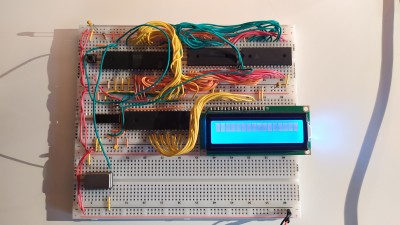

I built Ben Eater's 6502 breadboard computer, but something strange is happening:
When I try to turn the computer on it just turns on the LCD backlight and I need to plug it in and out a lot of times so it can show the text on the screen.
Can this problem be fixed?

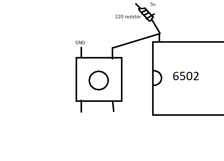

The LCD is fine I have used it before in other projects, but I have noticed that the reset switch doesn't work. I have checked the schematics and it seems like everything is OK.
I've attached how I wired the reset switch.
A simple schematic.
A simple schematic.
Re: Really strange 6502 computer problem
We might have to wait for some people with more experience. The problem is that mechanical switches are very indecisive: they bounce lots of times before settling. So the 6502 will see a whole series of reset pulses. What's important is that the final contact just before it lets go is long enough to work.

We need some photos of your project, please. :) This is important -- can be very helpful. And tell us about the CPU you're using -- was it purchased new from a reputable dealer, or is its origin somewhat doubtful?
Also, do you have a voltmeter or DMM available? (What about other gadgets, such as a 'scope or logic probe?) I suggest you use the meter to measure between Gnd and pin 40 (Reset). Please verify that the voltage is normally 5V, and that it goes to 0 when you hold the button down.
Uhhh... to be clear, what is it you're plugging in and out? The LCD? The power cord for your PSU? Something else, perhaps?
Edit: is that resistor in your diagram really 220 ohm -- not 2200 ohm, perhaps?
Right. It might be worth having a look at Garth Wilson's Reset Circuits page for some ideas on improvements you could make to the reset circuit. You probably don't have a DS1813 handy in your parts box, but you may have a 74xx14 or something else with a Schmitt trigger input. Even just a cap and resistor might help clean up the reset signal enough. I notice that Ben Eater's schematic uses a 1k resistor and 0.1 μF cap.

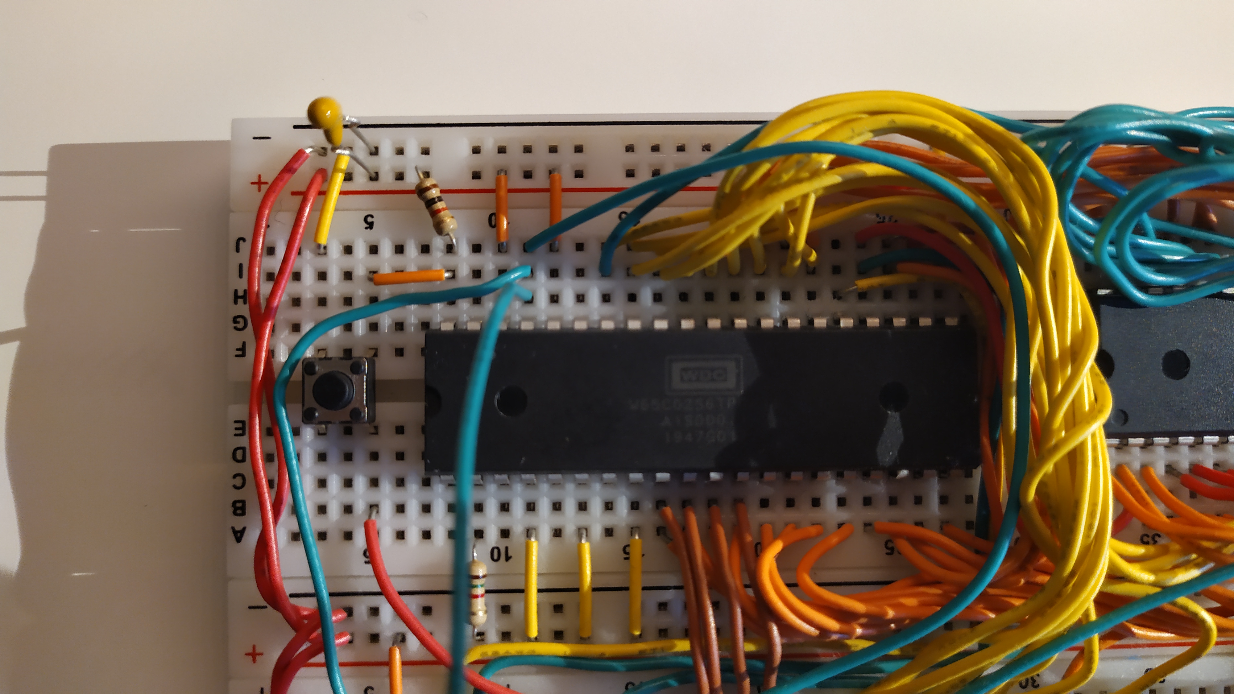

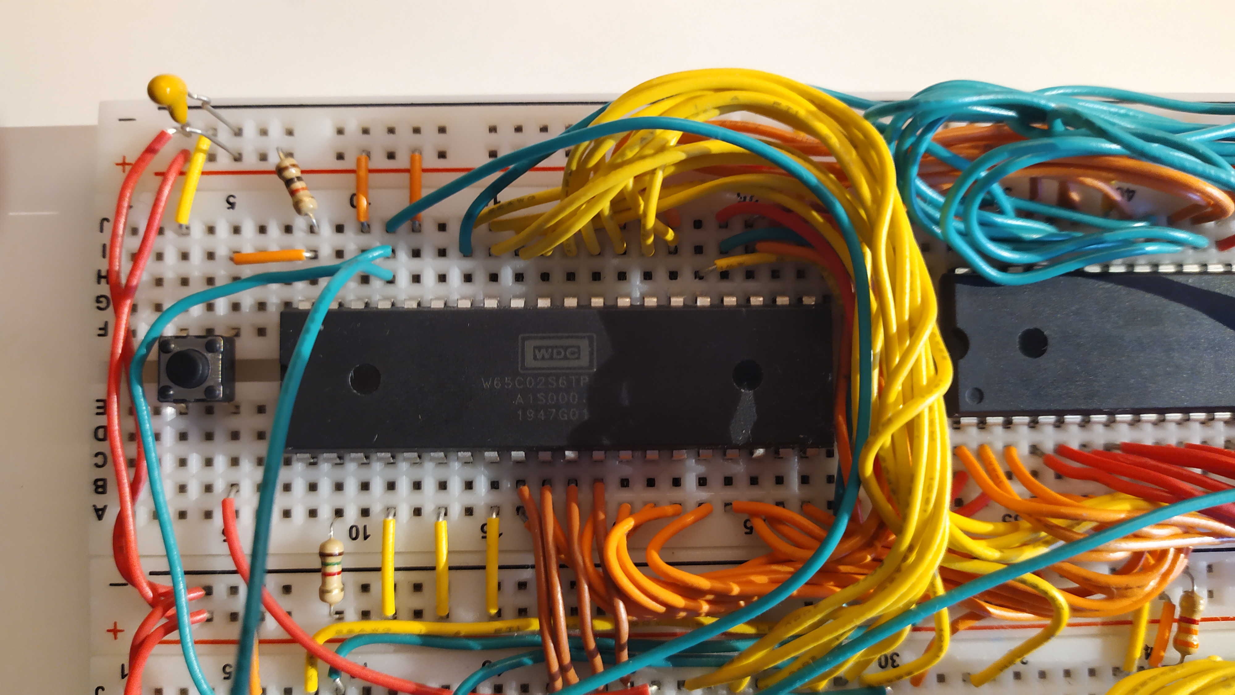

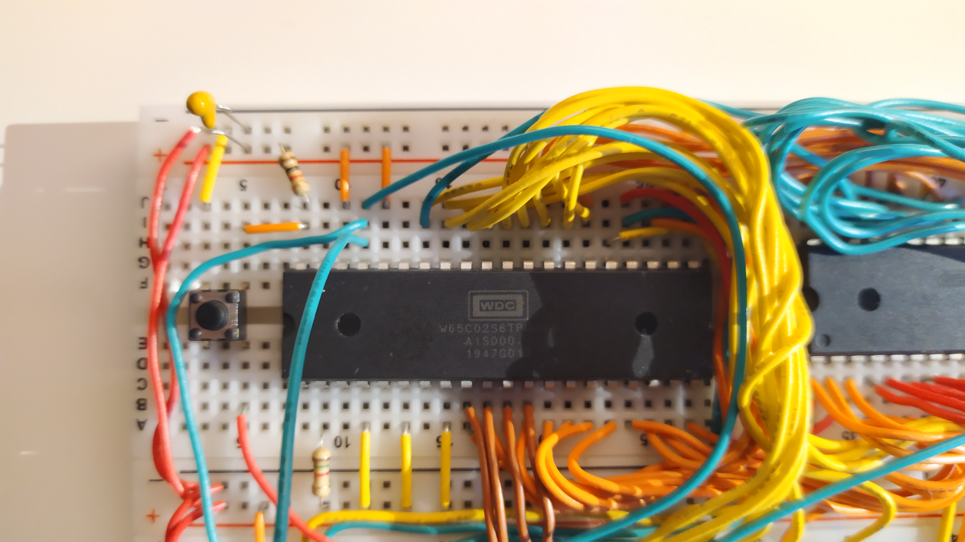

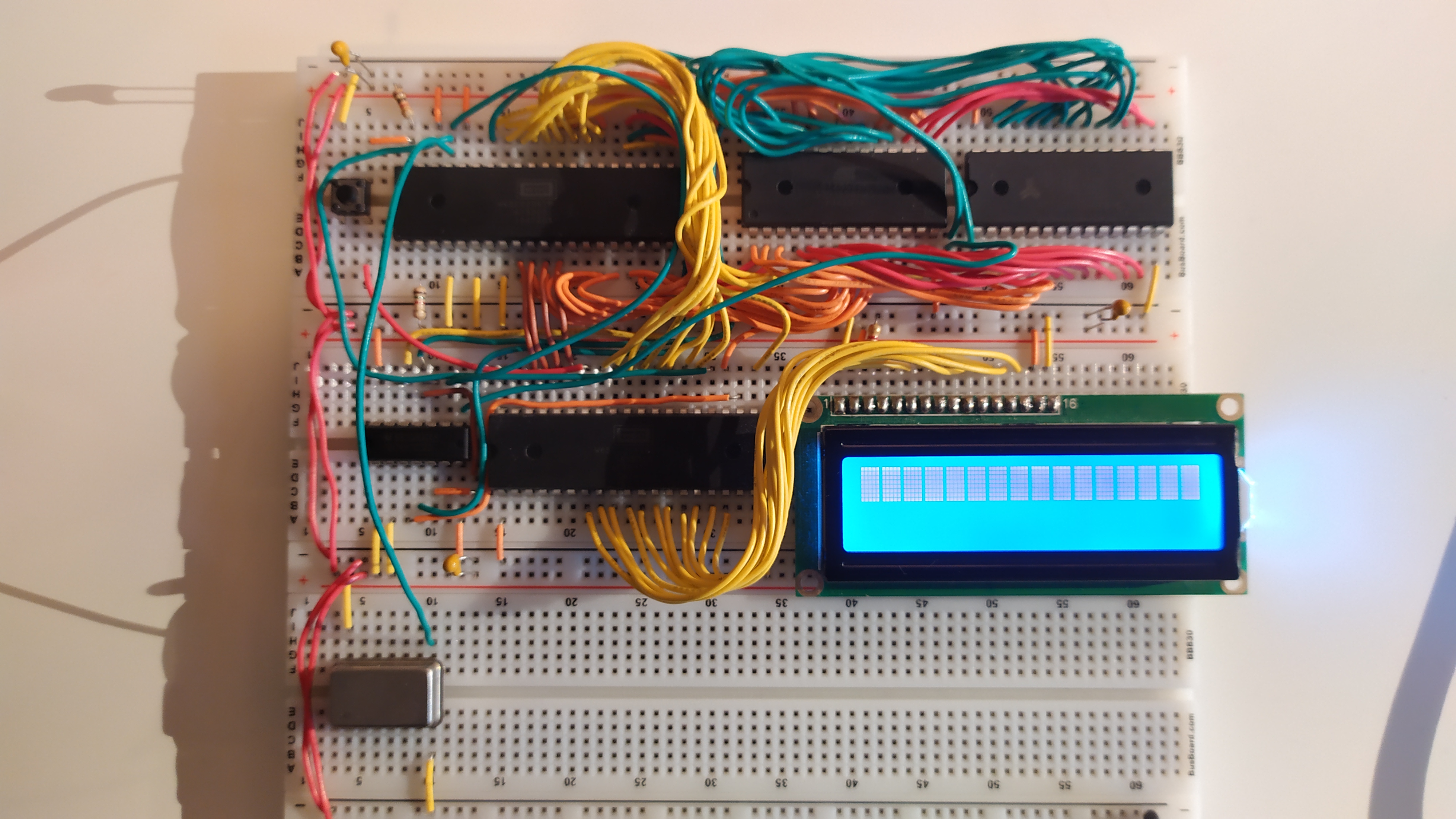

I also attached some pictures of my project:

The CPU is compleately new from Mouser electronics. The resistor is 1k I have typed 220 ohm by mistake. I have a voltmeter, checked the voltage - everything looks OK. I have to plug in/out the power plug.

Thanks for the photos!
When you say the capacitor didn't work, do you mean it didn't fix the problem?
So, you need to power-cycle the whole machine - reset isn't enough. Is never enough, or is usually not enough?
Have you any way to tell if it's just the LCD display which isn't coming up - can you read off activity on SYNC for example, or on address lines or data lines?

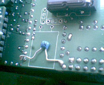

Some manufacturers' 65c02's had a Schmitt-trigger Reset input, allowing a slowly-rising signal from a capacitor to ground. I don't see anything in WDC's datasheet about it though. This however is a problem with solderless breadboards that I cannot emphasize enough, about the inductance of the connections and the fact also that they can act not only as transmitting antennas but also receiving antennas. A computer that controlled a product we sold for 13 years had a capacitor going to a 74HC00 (non-Schmitt-trigger) input, whose output went to an R65C02's reset input. Noise getting into the reset line from the clock signal was enough to keep it from working until we put another capacitor from the reset pin to ground. Even then, this arrangement was not good enough (I know it looks like it's not connected on the left end; but it was):

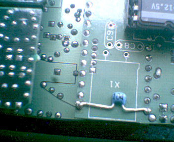

but this one worked and never gave us any trouble:
Note the difference in lead length. Yes, that little bit made all the difference between not working, and never having any problem. I could have laid out the board again to fix it, but the cost of first article was too high back then, particularly for multilayer boards.
I don't know/remember whether the Rockwell part had a Schmitt-trigger reset input. If it did, the size of the hysteresis was too small. If it did not, the gain of the CMOS input was high enough that a slowish-rising reset signal was ok as long as it was not noisy.
If you go by what's in the 6502 primer, you won't have any trouble.

It's usually a question of diagnosis. Quite often we might find, by careful review and inspection, that some wire is in the wrong place, or not quite making contact.
It's also possible, but less likely, that some component is defective - more likely, it is not quite connected, perhaps because of tarnish, or dirt.
What diagnostic equipment do you have? Multimeter? With frequency readout? Logic probe?
With patience and guidance you can learn a lot with just an LED and a logic gate or two - but while it's possible there is a quick fix, it might take some diligence.
It's a bit like software: rarely does a newly written program have no bugs. Learning to debug is an essential part of learning to program. It's like that with hardware too - unless you're lucky!

Druzyek
Posts: 367
Joined: 12 May 2014
Post by Druzyek »
What are the other chips you have in the circuit? If any of them require 5v, you might want to check the voltage at the power pin of each chip and the LCD individually. Depending on the breadboard and wires you're using, it could be dropping significant voltage, though it looks like you're using the breadboards that Ben Eater recommends
