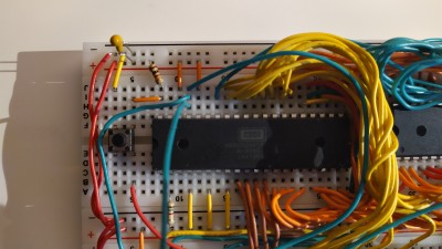

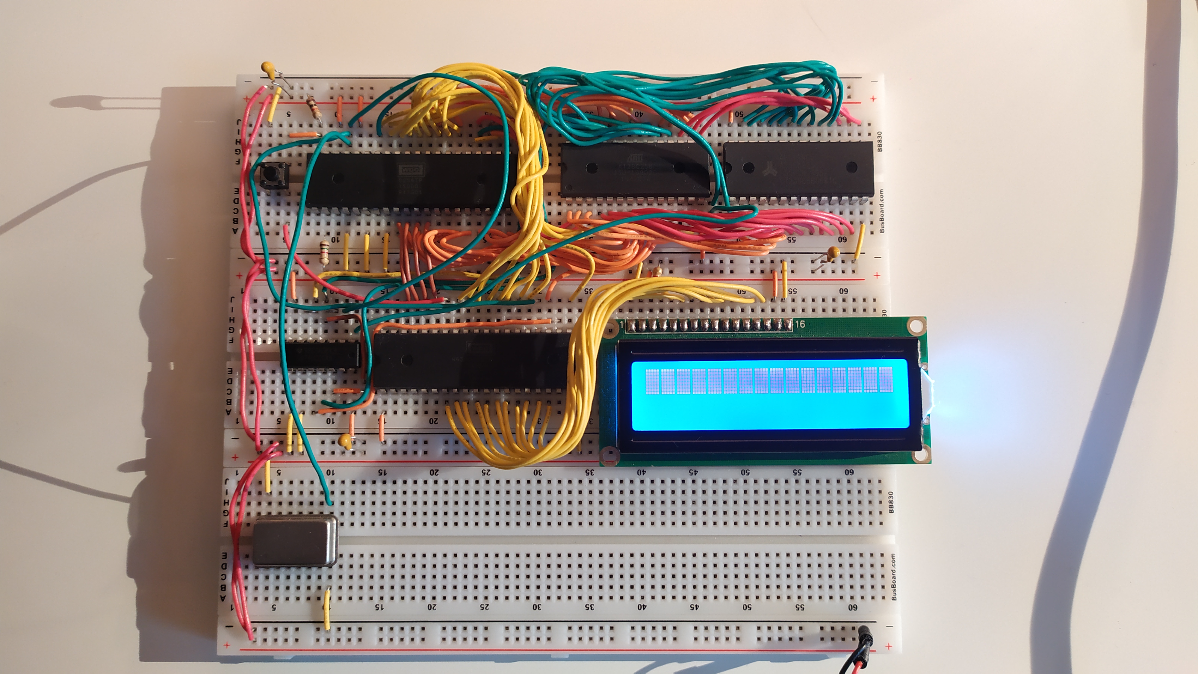

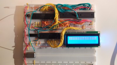

I built Ben Eater's 6502 breadboard computer, but something strange is happening:
When I try to turn the computer on it just turns on the LCD backlight and I need to plug it in and out a lot of times so it can show the text on the screen.
Can this problem be fixed?

PostPosted: Mon Jan 11, 2021 9:46 am
Joined: Sun Jan 03, 2021 7:22 pm
Posts: 13
Unfortunately I don't have any other parts that I can use. The capacitor on the reset switch doesn't work, I tried it.
I also attached some pictures of my project:

The CPU is compleately new from Mouser electronics. The resistor is 1k I have typed 220 ohm by mistake. I have a voltmeter, checked the voltage - everything looks OK. I have to plug in/out the power plug.
