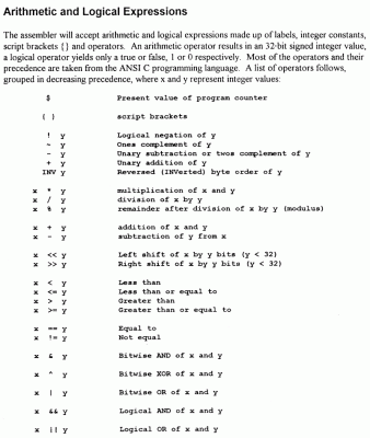

Re: What assembly syntax is good to support in an assembler?
The C32 assembler I use uses { and } for grouping things. What you show however does not need any grouping. JMP offset_label + $ is perfectly valid in all the assemblers I've used, and they don't need ( ) unless you want it indirect.
I used that as an example, i meant any expression in brackets in general.
Using other brackets for me would be problematic though, as my current syntax uses {} to explicitly specify bit width of a value.
Some (many? most?) assemblers do that with the "<". So for example, for the C32 assembler I use, if I'm programming for the 65816 and have the index registers in 8-bit mode and want an 8-bit LDX immediate, I might say LDX #<$1F, because without the "<", it would lay down a 16-bit operand.
C32 does shifts with << and >>. If there's any chance of confusing < for a "less than," you could put it in the brackets, like 2*{<foobar} (although that one should be clear without the brackets). I'll scan and post the list of operators. I've never found any problem with them (even if I'm not fond of some of them).
