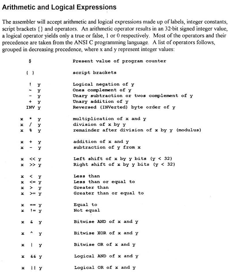

Some (many? most?) assemblers do that with the "<". So for example, for the C32 assembler I use, if I'm programming for the 65816 and have the index registers in 8-bit mode and want an 8-bit LDX immediate, I might say LDX #<$1F, because without the "<", it would lay down a 16-bit operand.

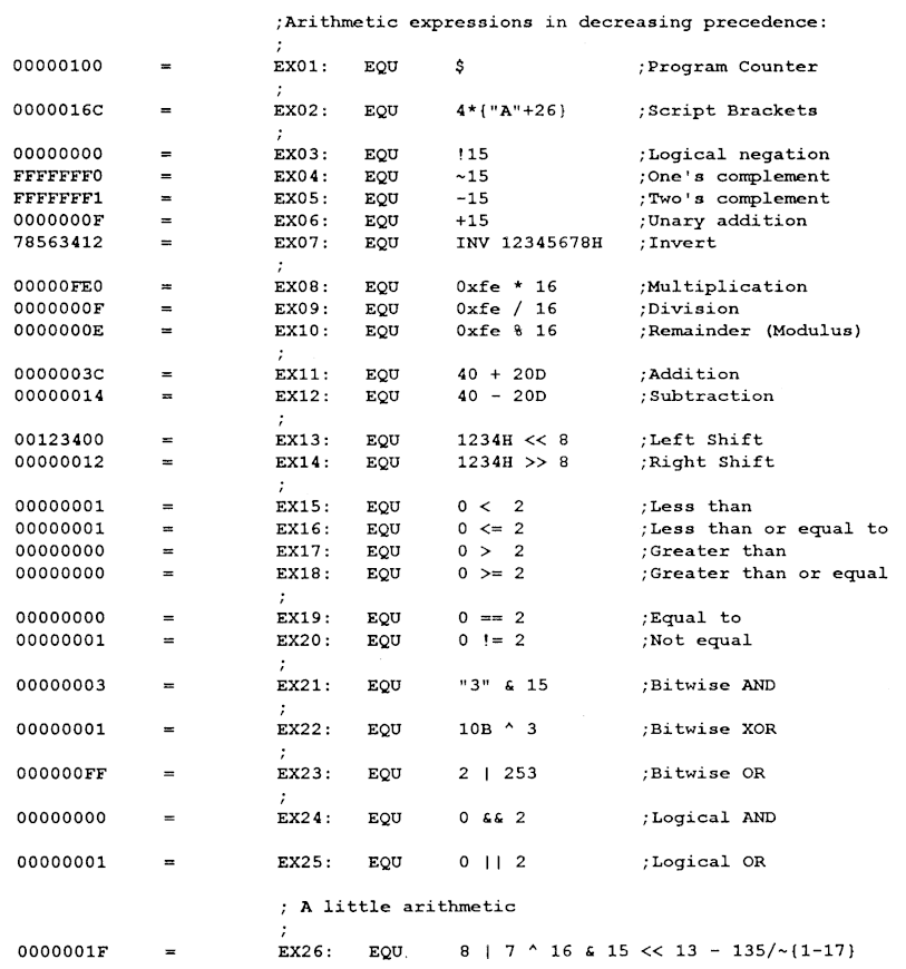

C32 does shifts with << and >>. If there's any chance of confusing < for a "less than," you could put it in the brackets, like 2*{<foobar} (although that one should be clear without the brackets). I'll scan and post the list of operators. I've never found any problem with them (even if I'm not fond of some of them).
PostPosted: Thu Oct 22, 2020 2:30 am
Posts: 8510
