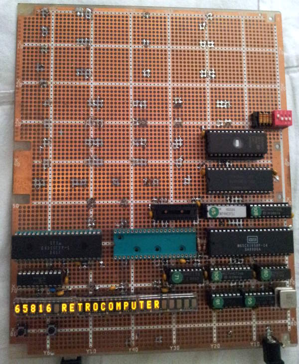

Hello!
Long time member, but without writing anything.
Once upon a time (that's very long ago...) I had an AIM-65 as my first factory built computer. Now, growing old and tired of all the new ever changing crap I got an interest in retrocomputing.
I have start building a machine that is intended to, among others, run the slightly modified firmware from AIM- 65. This one is far from an electrical replica. I'm using the 65816 with RAM up to 512K and I/O at high addresses.
In addition to I/O changes, this arrangement makes some functions require modification. As the expected end of RAM never comes, it needs to be explicitly told a top address. That's easy where I have the source, but ran into problems when trying to start BASIC.
I'm not sure if it hangs in a never ending search for end of RAM, or f.ex. try to test keyboard directly or by an unfixed routine. Using my own software single step it get into some weird un-initialized memory fill. Billy Boy has outsmarted me on this... I have found some kind of source files, but they are cluttered with conditionals, making them unreadable.
As time passed my AIM got heavily modified, all software in RAM, and it worked. All ports at original locations. Everything worked perfectly. The answer now is not a hardware circuit to make a memory "hole". I want to fix the root cause in the firmware.
Now to my question: Can You please tell me something usefull about the BASIC initialization routines and/or "dirty" hardware access in that firmware? Pressing "5" just hangs before any output is given.
Thanks in advance for any help.
Edit: SOLVED!
As more I looked into the code, as more ridicolous it appeared. This can't be right, and it proved wrong!
The guy running this site http://retro.hansotten.nl/6502-sbc/aim- ... -software/ has made a mistake and swapped the rom images... The image he says is for c000 begins with two jumps, that makes sense. Prepared a new combined file, loaded and magic happened. BASIC started and runs perfectly...
Sorry for asking before thinking. I will of cource twy to write him a note about the error.

Here is a photo of the project. I think it's quite disappointing, still far from what the AIM was. It will never get a themal printer, but it will get the screen AIM never had. The unpopulated socket is meant for a 6345 CRTC and then there will be a few :wink: other sockets added for the rest of it. I like this solution better than a terminal over TTY.
The VIA has one of its ports connected to a 16F1459 that gives it keyboard input and file storage from my PC via USB. Linux of cource and the software in GCC. It's thought to work with the original casette commands, but instead save and read from a direcory on the PC. There are still a bit of work to do on that, but the winter is long...
The displays are HP matrix LED with integrated drivers, but no chargen. It uses the chartables intended for the printer and output through the VIA's shift register.
Almost all of this stuff was available at the time of the AIM, except that the logic was 74LS, not HC. The biggest difference is the RAM. Then I had two large cards with very expensive HM6116 chips to get just 60K (64 minus I/O space) of RAM. Now I have just one cheap chip that gives 512K.
Never say never.
Depends on how much you want it...

Nice display!
Those are very nice! They're also very expensive, but may be well worth it when you're only making one unit for yourself. For anyone else interested, you can find them and their data sheets at https://www.broadcom.com/products/leds- ... -interface . (The line was initially made by HP, then Avago, and now Broadcom.)
