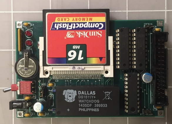

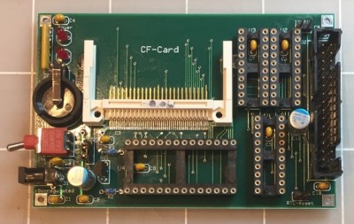

I finally finished the design for a compact flash and RTC adapter for my C02 Pocket SBC. PCBs came in today, so I put one together. As of now I have zero code written for it, but with all of the parts installed and powered up, the C02 Pocket SBC still boots up, so at least there's nothing shorted as far as I can tell. I also have the PLD programmed and installed, so that seems to have it's output lines correct as well.
I plan on spending a bit of time later this week starting to write some routines to access the CF-Card first, then will look at doing the same for the RTC. The latter has 256 bytes of non-volatile RAM which is accessible via two I/O ports (one for address offset and one for data). I plan to use this NVRAM for holding configuration data, which will free up some EEPROM space.
Here's a few pics attached.... hoping this will be a success. Once a BIOS is completed, I'll be looking to write a translation layer to use FLEX (BillG working on this).

I started to write some test routines against the adapter today... pretty simple so far:
For the RTC:
1- I can ready and write the 256 bytes of NVRAM. This was pretty simple, just following the datasheet.
2- I can read the time/date from the RTC. Also pretty simple, following the datasheet.
3- I can set the time/date to the RTC, again... fairly simple following the datasheet.
For the CF-Card (configured in True IDE mode):
1- I wrote a couple routines that test for drive ready and wait for drive busy first which are working.
2- I wrote a routine that resets the drive (it uses the first two routines) which is working.
3- I wrote a routine the runs the internal diagnostics (also uses the first two routines) and it's also working.
For both routines, the drive status finishes up as ready and the error register shows as 01h (no error). The Diagnostic routine does result in a flash of the drive access light when executed. So it's a definite that the CF-Card is responding.
Needless to say, I've got a ways to go on both devices... before I can declare the adapter as working properly. Hoping to get most of this done over the next couple of weeks (in between other projects).

Some additional progress today:
I added a couple routines for the Compact Flash card. I'm using the SanDisk documentation for writing these routines. My hardware design does route the IRQ line from the CF-Card through a MOSFET to trigger the IRQ line on the 65C02. The MOSFET is required as the IRQ from an IDE controller is active high (65C02 is active low). As I'm not actually servicing this IRQ as part of my ISR (as of yet), I was getting some wonky results, basically an intermittant lockup on the board. So the routines to access the CF-Card now start with a SEI instruction and end with a CLI instruction. This makes everything stable using polled I/O mode. I'll integrate this into the BIOS later and extend the ISR to handle the IDE controller properly.
The new routines are:
1- Drive Identify (command code ECh): This provides a 512-byte block of information which tells a lot about the device. It includes basic parameters like LBA count, CHS details, other specific settings, serial number, Vendor device name, etc.
2- A Block read routine: As the Identify command requires reading a block of data, this routine reads the block from the CF-Card and places it into a buffer (at $0400 - $05FF). This is also a nice test for the hardware design, as I implemented a bidirectional latch for reading/writing the upper 8-bits of the interface, so it uses 16-bit data transfers. This also verifies more of the ATF16V8 PLD programming. Also, one needs to swap the high and low byte for each 16-bit read, so that's done in the block read routine.
Here's the basic IDE routines I've come up with so far... none are optimized and more testing is required:
The block of data from a 16MB Sandisk card looks like this:
The "01 EA" bytes at address $0402-$0403 are the number of cylinders in hex (490 decimal). The format is documented in the SanDisk documentation... most of the 512 bytes are reserved and are zeros. LBA count is also shown, as a 32-bit count.
The next routines will be polled I/O as well... read any given block and write any given block... as I'm only planning to use LBA mode, not CHS addressing. Still a long way to go.
