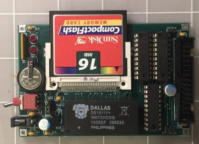

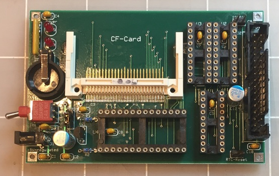

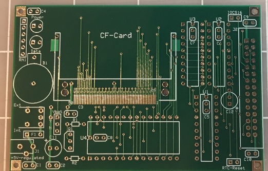

I finally finished the design for a compact flash and RTC adapter for my C02 Pocket SBC. PCBs came in today, so I put one together. As of now I have zero code written for it, but with all of the parts installed and powered up, the C02 Pocket SBC still boots up, so at least there's nothing shorted as far as I can tell. I also have the PLD programmed and installed, so that seems to have it's output lines correct as well.
I plan on spending a bit of time later this week starting to write some routines to access the CF-Card first, then will look at doing the same for the RTC. The latter has 256 bytes of non-volatile RAM which is accessible via two I/O ports (one for address offset and one for data). I plan to use this NVRAM for holding configuration data, which will free up some EEPROM space.
Here's a few pics attached.... hoping this will be a success. Once a BIOS is completed, I'll be looking to write a translation layer to use FLEX (BillG working on this).

I started to write some test routines against the adapter today... pretty simple so far:
For the RTC:
1- I can ready and write the 256 bytes of NVRAM. This was pretty simple, just following the datasheet.
2- I can read the time/date from the RTC. Also pretty simple, following the datasheet.
3- I can set the time/date to the RTC, again... fairly simple following the datasheet.
For the CF-Card (configured in True IDE mode):
1- I wrote a couple routines that test for drive ready and wait for drive busy first which are working.
2- I wrote a routine that resets the drive (it uses the first two routines) which is working.
3- I wrote a routine the runs the internal diagnostics (also uses the first two routines) and it's also working.
For both routines, the drive status finishes up as ready and the error register shows as 01h (no error). The Diagnostic routine does result in a flash of the drive access light when executed. So it's a definite that the CF-Card is responding.
Needless to say, I've got a ways to go on both devices... before I can declare the adapter as working properly. Hoping to get most of this done over the next couple of weeks (in between other projects).
