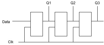

As an example, here is simple two FlipFlop chain, my goal is to divide the clock input by 4. ( Q1 out into Q2 in)
(If the logic is wrong, I will learn that and fix it on my own. My issue here is that it is telling me these extensions are not known, even though they are... something to do with making it know to use "registered" mode ??)

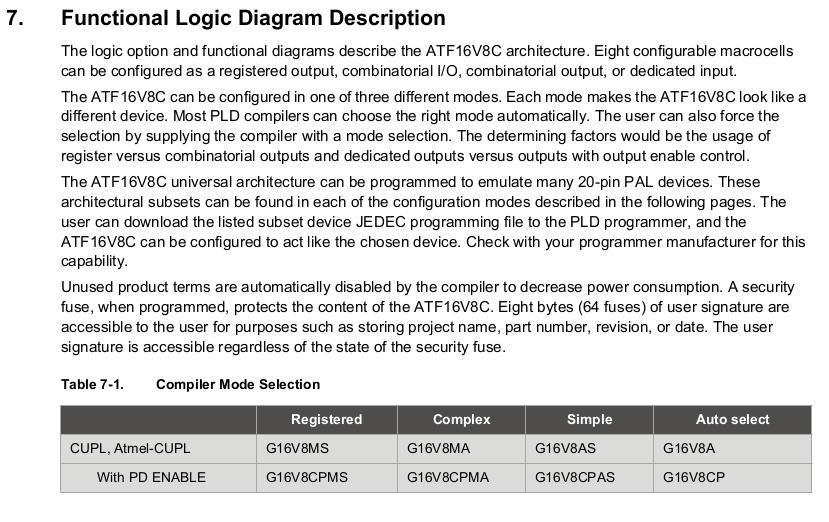

If I look at the ATF16V8C datasheet (dated march 2014 - the devhelp file looks -OLD-), it describes the 3 programming modes possible, and the correct 'model' of 16V8 to declare in WINCUPL. IIRC, for the 16v8 there aren't any extensions to use, they are intrinsically activated.
here's the said PDF.
ATF16V8C.pdf
(951.3 KiB) Downloaded 122 times
If you look at page 12 you see a fairly simple explanation.
This is how I managed to (finally) get my head around pretty much the same problem when I started out on the same road. Hope it helps.

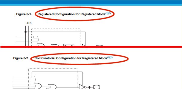

I saw that table, and thought I now have the answer. Except it's still not working. I tried with "g16v8a" and "g16v8MS"
(By the way, what is "Registered Configuration for Registered Mode" versus "Combinatorial Configuration for Registered Mode" ? Its' something else not explained or in the table in section 7 )
Looking at the digital block diagram, I see the CLOCK line is all connected together. So I realize now that I can't make a divider. So I tried to make a simple shift register. Something like this:

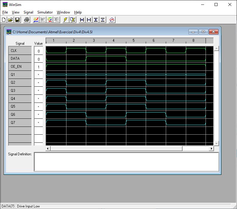

And this is the code:
Name Div4 ;
PartNo 00 ;
Date 4/26/2025 ;
Revision 01 ;
Designer Engineer ;
Company me ;
Assembly None ;
Location ;
Device g16v8a;
Pin 1 = CLK;
Pin 2 = DATA;
Pin 11 = OE_EN;
Pin 12 = Q1;

Okay, except the PDF file, although I'm not sure what it means, does, or what all the statements are, I can see that it says Q1 is an INPUT. Here is that segment.

And the simulator is not giving me FlipFlops. More like latches.
The clock transition latches the high on BOTH Q2, 3, 4, 5 at the same time. Then not sure what the deal it with Q6 and Q7 being on the negative transition.
Any additional advice is appreciated.

Not to discourage you, but you should consider using the ATF22V10C instead of the 16V8.  Although the former is in a somewhat larger package than the latter (24 pins vs 20), you will have a significantly more flexible part at your disposal.  In WinCUPL, I use the g22v10 device type with the 22V10, permitting the use of both combinatorial and registered logic in the same design.
That limitation, and others, is why CPLDs replaced GALs in many applications in the days before FPGAs started to take over.  Microchip’s ATF1502 and ATF1504 CPLDs take up scarcely more room on a PCB than a 22V10, yet offer far more design options, especially when using buried logic.  You can have multiple clock inputs or use buried flip-flops to act as clock dividers.  Combinatorial logic can be much denser and you can implement transparent latches—something not possible with a GAL.
The ATF18V8 was part of a learner kit I bought years ago, then set aside. Now I've dusted it off and started over.
So after doing a part search and reading some data sheets, I thought the ATF750 would be a good unit for the final project. I picked up a hand full of them (in case I do a brain dead error and fry one).
Then I discover the VP-290 that was part of the kit 1) isn't even made any more and 2) its older brother doesn't support the ATF750! So now I have to decide whether to invest a lot more $$ in a larger programmer for this... a small educational task.
Or in baby steps, get a slightly bigger PLD. But my programmer doesn't support the ATF22 either. So there is still that issue.
And if the 16V8 says it's got FlipFlops (as it does all over the data sheet) and I can't make it happen, I'm not confident can I make FlipFlops work in the ATF750.
