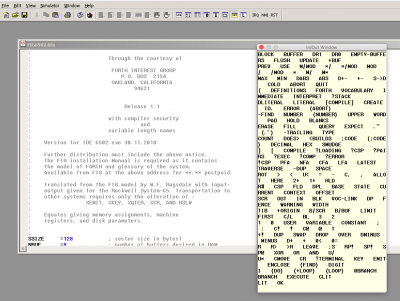

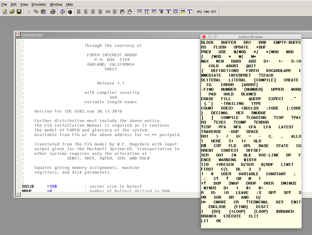

Maybe someone is interested. I ported FigForth to Michal Kowalski's 6502 IDE and emulator (http://www.exifpro.com/utils.html).
Have fun!
--Dietmar
Have fun!
--Dietmar

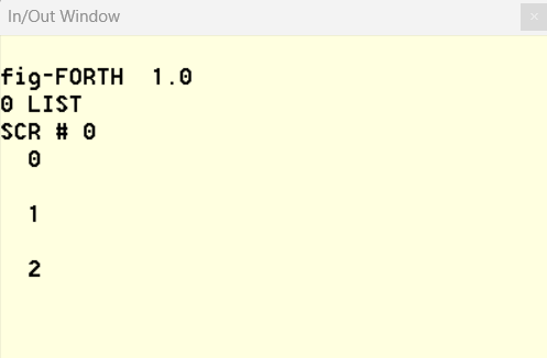

Hi All,
I am a big fan of and have Tali running on my sbc fine.
However, FIGFORTH has always interested me. I've brought a couple different venison's up on my SBC, worked through tutorials with it and so on, but could never get screen listings to work. I had always assumed it had something to do with my setup, but I see the same issue exist in the simulator, thus I must be missing something.
As in the screenshot, I would expect a 0 list to list 16 lines but it crashes at line 2. I know this crash is happening when in routine L3030 / DDISC and that I have no disc attached, but I have thought I could use a RAM disk as described in the 1979 installation manual.
The section of the installation manual "fig-FORTH_Manuals_May79" I refer to, page 4 reads as:
RAM DISC SIMULATION
If disc is not available, a simulation of
BLOCK and BUFFER may be made in RAM. The
following definitions setup high memory as
mass storage. Referenced 'screens' are then
brought to the 'disc buffer' area. This is
a good method to test the start-up program
even if disc may be available.
HEX
4000 CONSTANT LO ( START OF BUFFER AREA )
6800 CONSTANT HI ( 10 SCREEN EQUIVALENT )
: R/W >R ( save boolean )
B/BUF * LO + DUP
HI > 6 ?ERROR ( range check )
R> IF ( read ) SWAP ENDIF
B/BUF CMOVE ;
Insert the code field address of R/W into
BLOCK and BUFFER and proceed as if testing
disc. R/W simulates screens 0 thru 9 when
B/BUF is 128, n the memory area $4000 thru
$6BFF.
An online version of the manual is at https://github.com/BillRagsdale/fig-FOR ... 20good.pdf
I have tried this several ways, but basically, I enter the above R/W definition and get an OK, then I do the following "which is probably wrong":
' BLOCK R/W !
' BUFFER R/W !
I will then try list and it will show a line or two and crash. I have also tried not doing anything but starting figforth and 0 list, as well as only defining hi and lo.
If anyone can give me a new idea I would appreciate it. I do know if I connected up my SD card routines it would likely work much better, but I wanted to get thru playing with a ram disk first to make sure I understood what to do with read sd card access.
I do have Tali working well with my sd card solution, but FIGFORTH seems a little less straight forward to setup for me.
Thanks,
Don

Re: FigForth in 6502 IDE
Don, this is maybe a long shot, but does LIST rely on U* ? I haven't the time to check right now. But perhaps you'll be glad to learn of the UM* (multiplication) bug in common 6502 Forths anyway.
The R/W routine is in page 69 of Ragsdales manual. You have to replace it with the RAM disc code above and then it will work fine.
Be aware, that in FIG FORTH screens 1 & 2 are reserved for the error messages.
Dietrich
Dietrich
My system: Elektor Junior Computer, GitHub https://github.com/Dietrich-L
' BLOCK R/W !
' BUFFER R/W !
' BLOCK R/W !
' BUFFER R/W !
Yes, it is. My FIG-Forth is a little rusty. I think ' (tick) returns the address of a word's PFA .
You are getting the PFA of BLOCK then calling the new R/W then getting the PFA of BUFFER and calling the new R/W .
Remembering ' (tick) before R/W and swapping the order of BLOCK and R/W will not work because R/W is not the first word in the definition of BLOCK or BUFFER .
If you don't want to rebuild the FIG-Forth system, you could try locating where R/W is used in BLOCK and BUFFER then replace them with the new definition.
' R/W CFA ADDR1 !
' R/W CFA ADDR2 !
ADDR1 is the location of R/W within BLOCK and ADDR2 is the location of R/W within BUFFER .
If that seems daunting, this might work:
First, save the PFA of the original definition of R/W.
' R/W
Enter the new definition of R/W.
If memory serves, the name in FIG-Forth for EXIT is ;S
With the PFA of the original R/W still on the data stack, do the following.
' R/W CFA OVER ! \ CFA of the new R/W is stored in the first cell of the original R/W
' ;S CFA SWAP ! \ CFA of the word to exit high level Forth words is stored in the second cell of the original R/W
The original version of R/W should now be patched to run the new R/W then exit.
I can not test this. The only version of FIG-Forth I have is for the Commodore 64 and it is on a cartridge.
Don't FORGET the new definition of R/W .
Personally, I'd rebuild the system. FIG-Forth doesn't have deferred words, if memory serves, so here is a technique from Scott Ballantyne's Blazin' Forth.
: (R/W)
<define R/W here>
: R/W
(R/W) ;

2) Convert this number to a decimal value
3) Instruct my sd card to open and read the related file, in this example 1.fth
4) Populate the buffer 4FF location with this data
With a flush, I do something very similar, creating separate files for each block named by their block number.
For FigForth I was hoping to achieve something similar, and thought a good start would be to get the ram disk working and from there figure out what I needed to do.
In the simulator, I can enter the colon definition in this thread and patch block and buffer with the new R/W as given, and this works. I have further tested it by creating words to clear the appropriate memory and also to write some characters to specific places to see that they show at on the respected screens at the right places. This work great.
However, once I alter the figforth 1.0 source as mentioned above, the simulator will crash on a 1 list command for example. I cannot determine where it crashes either. I have tried breakpoints, however, even before I make modifications, it appears R/W and/or RSLW are never executed. This is hard for me to follow, because if I enter a 0 load, although it passes thru allot of garbage, that does not crash and is reading memory from "somewhere" thru some routine.
Thanks !
