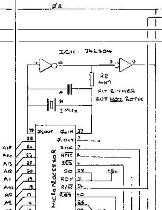

Hello,
I'm working on a work-alike build of an Acorn System 1, which had an NMOS 6502 running at 1MHz. I've got a fistfull of Rockwell 6502s to hand, but the 1MHz crystal was a bit more bother. It seems they only exist in the big HC-51 package, which is too big for my board, so I'm planning on using an 8-pin DIP oscillator instead.
Attached is an extract of the System 1's circuit diagram:
(As can be seen, the System 1 supported using a capacitor instead of a crystal for industrial applications where timing was not critical.)
I'll be connecting the DIP oscillator directly to Phi0in, and removing the resistor and crystal/capacitor. That'll leave me with Phi2out passing through a pair of inverters on its way to fee the rest of the board. Are the inverters needed? The only benefit I can foresee is that using the 74LS04 to drive the board's clock may be preferable to using the 6502, and that there are two extra gate delays on the Phi2 clock. If these weren't needed, why wouldn't the designers have taken Phi2 direct from the 6502 and foregone the second inverter? Or would this mean the other devices connected to Phi2 would affect the crystal's timing?
Looking at Garth Wilson's primer on clock generation, he suggests a different crystal-based circuit, where Phi2 goes directly to the board, and isn't used in the clock generation. (This is the style of circuit used by Acorn in their later BBC Microcomputer.) This suggests that the double-inversion isn't needed in my case.
If the two inverters are no longer necessary, I may repurpose them for something else.

I do find that confusing! You could regard the board's "phi2" clock as being a twice-delayed phi2(out), or you could regard it as an inverted phi0. Which, right now, makes little sense to me! I look forward to being enlightened.
The issue 3 circuit diagram here does retain the pair of inverters from the Phi2 output.

Leave them in. Why?
1) Depending on how many recipients require PHI2 the CPUs output may be too weak.
2) The circuit has worked in its original form, that means the overall timing was OK. If you now change that timing it may cause trouble.
3) If you got everything working fine you may try to omit these two inverters and check whether it still works flawlessly.
Regards

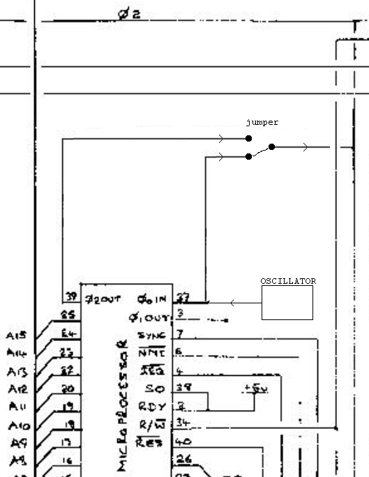

Picking Dr. Jefylls idea of a jumper and replacing the two LS04 inverters using noninverting gates (like LS11 e.g.) a 4-way jumper could give you 4 possible timings to choose from. And three of them can osc, gate 1, and gate 2 should manage the load as they are equal or more powerful than the LS04.

Here (below) is a setup you might consider. I suppose if the jumper were 3-way then you'd have the double-inverter option, too.
That diagram (and GaBuZoMeu's additions) look interesting. As my LS04 will be socketed, I may connect the socket to a breakout board and experiment with the timing once the board is built.

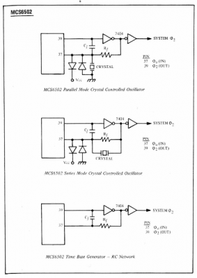

Looking at the 6502 data sheets over in the documents section, the MOS/Commodore 1976 version gives three different example clock circuits (series crystal, parallel crystal and RC) which are similar the System 1's layout: bridging Phi0in and Phi2out, with an extra inverter to give the system clock. By comparison, the Rockwell 1987 version gives the same clock circuit as Garth, with two inverters on the Phi0in size and the Phi2out completely independent.
Acorn were using MOS chips (the prototype was built with a white ceramic MOS 6502) so it seems very likely that they worked from the datasheet's circuit for their prototype and System boards. For the Atom they may then have left the double inverter in "just in case".
I wonder why Rockwell would have suggested a different circuit: did they make any changes to their NMOS 6502 design?
