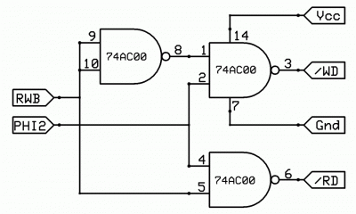

The 'reference design' noted by GaBuZoMeu is the place to start. The schematic as provided by BDD is:
Connect /WD to RAM /WE.
Connect /RD to both RAM and ROM /OE.
If you still have a problem, then we can look at the CPU delay to remove any propagation delay. The propagation delay trick is still new and relatively untested and, if valid, should only be needed where extreme speed is encountered, so we should go with the proven architecture first.

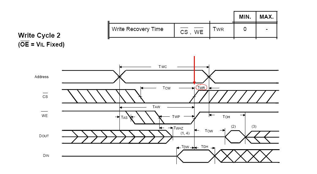

BillO wrote:
I don't like /CE going high before /WE. In the other thread this was identified as an undefined condition.
Whoa, wha? I'm still getting up to speed on that second datasheet! :oops: Are we talking about the same thing -- is it this TWR spec that's at issue? I think the reference point (red arrow) is intended to mark the end of the write operation, which is to say the point at which either /WE or /CE has gone high. They could've included a second diagram in which it's /CS rather than /WE which is first to go high, but it's unsurprising they skipped that. For me, the meaning of the TWR spec is, "you need to keep the address stable until the write ends, but not afterward."
Edit to add: TDW and TDH (near the bottom) use the same reference point, and I just noticed TDW is "Data Valid to end of write" and TDH is "data hold from end of write."

When I look at that diagram I see those hash marks. I'm inclined (being the lazy sot that I am) to believe they are that way for a reason. There are no hash marks beyond the rise of /WE. This leads me to believe that what their limited text on the matter means is, that /WE should rise either coincidental with /CE or sometime before - but not after. Otherwise they would have included the hash marks after the rise of /WE too.
I don't know what the circuitry in that particular chip is actually like, but in my experience these are the functions of those inputs:
A low level on /CE will enable power to the I/O and dynamic circuitry of the chip.
A low to high transition of /WE will enable latching of the data present at the transition.
From that, and the way the diagram is offered, if /CE rises before /WE, it turns off power to the I/O before the data can be properly latched.
Yup. It halts the copying that had been in progress, the "transparent" write (like when a 74xx373 is following the input data).
Yes, and a high level on /CE stops whatever might be happening (including a write).
So did I misunderstand by supposing it's TWR that concerns you? Not sure I'm following you. Beyond what I already said I can only elaborate that the reference point with the red arrow has the words "end of write" associated with it -- and the Truth Table tells us what a write is. It's the condition defined by /CE and /WE both being low.
You're certainly right about this datasheet having "limited text on the matter." :roll: :) A look at datasheets for comparable RAM products, or better yet an Application Note, might shed a clearer light.

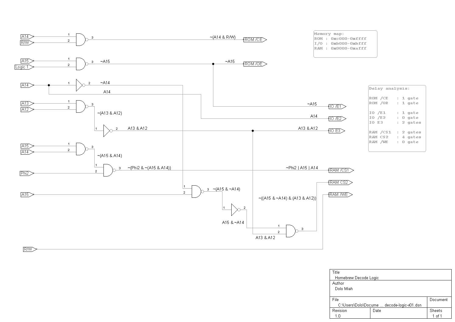

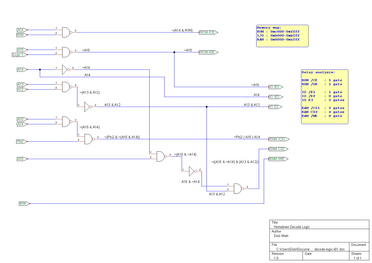

Hi Folks. Sorry for the delay, solid week at work and then away for a long weekend. I have converted my logic notes in to a diagram - see the attached mess which is realised by two 74XX00 NAND and one 74HCT04 (I have both LS and HCT NAND devices :shock: )
I hope I have transcribed this correctly, as I know it works of course. I have included a couple of notes re the memory map and how many gates propagation delay to come up with the decode. The maximum is 4 gates of delay, which I guess could be in the order of 28-36ns. Also see that Phi2 is not used to qualify ROM or IO activation, only for RAM access.
I'm conscious that I haven't done an optimal job on this - I came up with this more than 3 years ago now (time flies) and it was my first go and more or less worked except I was using Phi2 for IO which I fixed after advice on this forum (only remembered now!).
The RAM device is a UM 621024 70ns device with the following control truth table (which I think is normal for many RAM chips):
/CE1 high or CE2 low is standby
/OE and /WE high is output disabled
/CE1 low, CE2 high, /OE low, /WE high is read
/CE1 low, CE2 high, /WE low is write (/OE don't care - in fact I have tied /OE low due to this)
The faster device is a UM 61512 15ns device, same truth table as above and same manufacturer (UMC). Did I mention that with the fast RAM, I can clock the 6502 at 5.38Mhz, 2.68Mhz or even 1.34Mhz and it is very glitchy. So this might be confirming theories that the RAM is too fast for a breadboard set up?
In addition: When the 3 enable lines to the 74xx138 select an IO device, Phi2 is then used for further qualification. For the 6551 and 2 times 6522, this is simply the same Phi2 as fed to the 6502. For the TMS9918, I have yet more logic to get a /CSR and /CSW signal.
In answer to a query about the clock frequencies - this has been dictated by my choice of using a TMS9918a which requires a 10.738Mhz clock. I have a 21.7727Mhz crystal and hence used this to divide by 2 for the TMS9918 and by 4 for the 6502.
I hate not being able to know definitively what is going on here - but maybe I have now given enough information for someone to work it out. However, if not, I will need to put it down to things like slew and breadboard noise - I need to move on with other things on my project!
As always, any views and advice welcome.

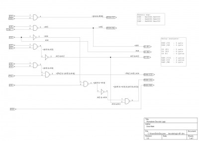

Please post a monochrome version of your schematic for the benefit of your color-challenged readers (that would be me). :D

As I think has already been noted in this thread, failing to qualify /OE with Phi2 could easily lead to glitches on the RAM output. Looking only at truth tables is problematic; you must also consider *when* input signals become valid and follow the chain of causality.
For example, with the ROM I would use ~(A14 & A15) which is valid early in the 6502's cycle, to drive /CE which typically has a relatively long latency to valid output, then use ~(Phi2 & RW) to drive /OE which typically has a much shorter latency. You can lead the same /OE signal to the RAM without needing to qualify it further, and this doesn't consume any extra gates - in fact, as you already use ~(A14 & A15) elsewhere, it saves one gate.
Your RAM /CS1 and CS2 logic also seems overcomplicated. I would generate a mask signal for your I/O area at $Bxxx (A15 & ~A14 & A13 & A12), and use that both as a pre-qualifier for both your I/O selectors and as one of your RAM chip-select signals. Feed the other one with (A14 | A15) or its complement, depending on which polarity is more convenient for the I/O mask.
In short, in general treat chip-select lines as address logic, and wire address decoding logic to them; treat output-enables and write-enables as control logic, and wire clock-qualified control signals to them.

Also, assuming HCT logic, there could be as long as 48ns-88ns from address valid until the RAM is selected, then add to that the RAM access time of 15ns. I don't think this is a great situation, especially at 5.3MHz.
Also, as has been pointed out to me recently in a different thread, tying RAM /OE to ground can cause contention at the best of times - the faster the devices the more likely that is to occur.
You should seriously attempt to incorporate the 'reference design' that has been shown here for /WE and /OE (/RD).
In addition make some effort to simplify the /CE logic as much as possible and/or use faster gates to implement it.
Update: Monochrome version on schematic for BDD.
