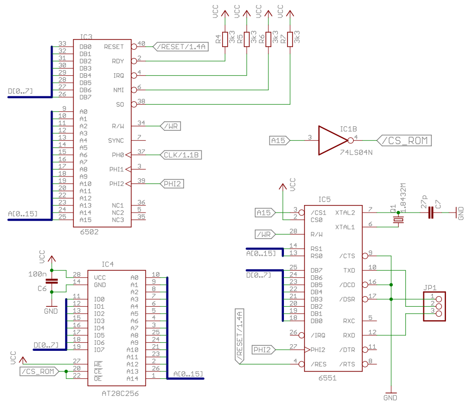

Below is the connection from the usb ft232 to 65c51 chip. I've also grounded CTS pin on the 65c51 to enable the transmitter.
USB -> 65c51
Rx--->TxD
Tx--->RxD
DTR--->DSR
CTS--->GND
As for the software side,
I am aware of the Xmit bug in the latest 65c51 chip, and I'm following floobydust delay routine to get it working with my 1Mhz computer with 1.8432Mhz on the ACIA. The code is shown below..

As for the wiring I'm following exactly with Grappendorf's connection http://www.grappendorf.net/projects/650 ... world.html, which inverts the A15 to choose between the upper 32k (ROM) lower 32k (ACIA) and the 2 LSB for register select as shown above. I'm still not getting any outputs on my terminal screen (putty), any help would be greatly appreciated.
