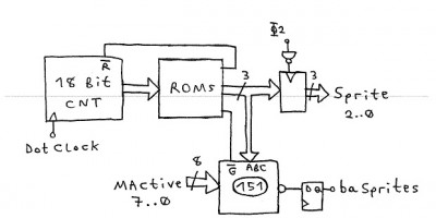

Some years ago, I did build my own (monochrome) TTL CRT controller, D04.
(Scroll down the page.)
Because generating the display address plus the control signals tend to take a lot of TTL chips,
I had decided to use a 27512 EPROM containing a "lookup table" instead.
The 8 MHz dot clock was divided down to 1 MHz by using a 74163 counter.
A 15 Bit counter (built from two 74393 counters) running at 1 MHz provided a 15 Bit address for the EPROM.
The EPROM then generated one 16 Bit word per microsecond which contained display address and control signals
(including sync signals and a RESET signal for the 15 Bit counter).
I'd say, that this trick also should work when it comes to building a TTL implementation of the VIC-II.
As a thumb rule, we could expect that the EPROM (one big EPROM or some small EPROMs)
would have to generate about 6 Bytes per microsecond.
Ok, maybe I had missed some control signals in this diagram...
on the other hand, the refresh counter value doesn't have to be generated by the EPROMs,
one could use a 74393 counter plus an inverting buffer like the 74240 instead.
Because when inverting the outputs of an up_conter, it _looks_ like a down_counter.
Because of the Y scrolling (and the 3 Bit comparator related to it),
the ROW and COLUMN counters would have to be implemented by using TTL chips, sorry.
BTW: we have 40 characters per line, that's $28 hexadecimal.
Interesting question is if we only need a latch for Bit 9..3 in front of the COLUMN counters.
When adding another address line to the EPROMs, one could have a switch on the front panel
to select for PAL or NTSC timing (that signal would have to go to the clock generator, too).

Re: TTL VIC-II, some ideas
If we would be building the BA logic for the sprites like in FPGA64,
this probably would take one page of schematic with conventional TTL chips.
The interesting question here is:
If we would generate the Sprite2..0 signals one PHI cycle ahead with the EPROM,
would it be possible to generate the BA signals for the sprites with
a 74151 8:1 multiplexer by tapping into the sprite enable Bits ?
For the rest of the circuitry, we would have to delay Sprite2..0
by one PHI cycle, of course.

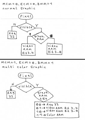

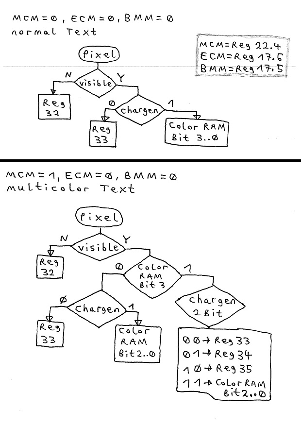

VIC-II has 5 valid display modes
(and 3 invalid display modes in which the screen is supposed to be blank).
Tried to do sort of some flow diagrams about what to do with the pixel data
at the output of the video shift registers.
BTW: "visible" in those flow diagrams means the pixel isn't inside the border
(and the pixel isn't inside the retrace blanking periods).

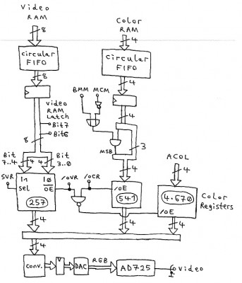

Now for some thoughts on generating the video signal...
Oneironaut sure did some nice basic research in his Lazarus-64 project.
BTW: I agree about his use of notebooks.
Another interesting source might be the Apple 2 Redbook.
Unfortunately, all this only covers NTSC, and for PAL the game is a little bit more complicated.
Of course, we could be cheating and just use the AD725.
For resolutions with more than 320 horizontal, a composite video signal isn't quite the thing,
S-Video might give a better picture.
SCART accepts analog RGB what would be best.
Electrically, that SCART connector seems to be nicely engineered. Mechanically... well... err...
Nowadays TVs (2017) still seem to accept S-Video and/or SCART,
but I'm not sure if this still is the case when somebody eventually has success in building
Same thing for analog VGA.
BTW: for "simple" analog VGA, the horizontal frequency is about 30kHz,
about twice as much as for a TV video signal.
In theory, if one would be running the VIC-II at a 16 MHz dot clock frequency (and a 2 MHz PHI clock)
for generating the video at twice the normal speed and display every raster line twice,
it might be able to drive analog VGA, but this won't be timing compatible to the original C64.
That's why the 'scan doubler' was invented.
The basic idea is that one raster line is stored into RAM, then put on the screen
two times at twice the original frequency.
Original C64 has 16 colors, 1 Nibble is 4 Bit.
8MHz dot clock, 64us per scan line (PAL)...
that would be 64*8=512 dot clock pulses (PAL) per scan line. 4 Bit per clock pulse.
Double buffering required, what would make 512*2 = 1kNibbles.
Double buffering a full field then would take ca. 312kNibbles (PAL).
Hmm... in theory, with >1.22kNibbles of RAM, one could grab the pixel data
which "drops out of the hot end" of the VIC-II, then stitch 4 pictures 320*200
together to one 640*400 picture to be displayed on a VGA monitor...
I just doubt that this would be too useful... or too software compatible to anything...
If analog video signals eventually are extinct, there still might be chips like the
TFP410 TI PanelBus DVI transmitter.
But as usual, it's hard to tell how long they would be in production... again.
And I'm not sure if you might need something like a scan doubler when aiming for DVI...
but probably... yes.
The flow diagram for the 8 Bit to 10 Bit conversion in the DVI specification looks a bit evil,
if anybody would try to roll his own binary RGB to DVI "display port IMHO" it calls
for something like a bit_serial implementation plus a fast counter,
and I'm not sure if simple TTL would be going to be fast enough...
but back on topic.
It's a pity, that the EF9369 color palette chip (mentioned above in this thread) is out of production,
same thing for all the other RAMDACs.
Ok, so my advice would be to build a color palette (like in the C65) by using fast SRAM,
feeding three 4 Bit DACs for generating RGB, then to feed this into an AD725 for generating
a video signal.
This way, you won't have to worry about generating the chroma clock for the VIC-II.
Of course, to be on the safe side I'm suggesting to make quite a few test runs with the
AD725 before actually using it in a design, and I'm also suggesting to have the color data
which goes into the palette, the digital RGB data which comes out of the palette,
clock signals etc. available on some connectors, so that others could build something
different for generating the video signal if required.
The problem when using a color palette here is, that the palette won't be initialized
after power_up, and in the worst case this would turn the picture on the screen unreadable.
So one either would have to patch the C64 Kernal for initializing the palette...
or to have some ROM in parallel to the palette RAM, the ROM then overrides the RAM
after a hardware RESET and generates the digital RGB until the CPU makes the first
palette write or such.
Now about pushing the envelope of the colors:
IMHO nothing speaks about making the color RAM and the color registers 8 Bit.
In theory, together with digital 4 Bit RGB this would give us 256 out of 4096 colors...
a video signal.
Now for the "hot part" of the design:
The circuitry that converts parallel video data to serial 4 Bit pixel color data.
Schematics are just provided as a concept of what to do with the data,
nothing more, nothing less. And it all probably contains some errors...
Notation looks a bit odd... mainly because I did this stuff in 2016,
before trying to dig into FPGA64, I just found the time to clean them
schematics up a little bit...
Note that 74670 'color register' block starting at $D020 in memory,
first color register would be Register32 of the VIC-II.
(One probably won't be building it by using 74670, but... well...).
Also note that 4 Bit address bus labeled ACOL3..0 for selecting the color register.
The block labeled 'Conv.' "somehow" converts the 4 Bit color data to digital RGB,
could be a ROM, a palette RAM, or both.
