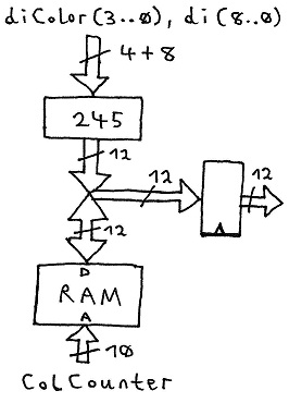

In the C64, we had a 1K*4 SRAM (2114) as color RAM, and 64kB DRAM for "the rest" of the video data.
The C65 had two 64kB blocks of DRAM, IIRC in the lowest resolution color RAM was in block 1
and "the rest" of the video data was in block 0.
The address bus was partially split for both blocks, and the data bus was 16 Bit.
This brings up an interesting question what would be better:
To go for a C65 like concept by having two 8MB blocks of memory with something like a partially split
address bus and a 16 Bit data bus, placing the color RAM somewhere into the odd 64kB pages.
Or to stick with the C64 concept, what means one 16MB RAM block with 8 Bit data bus,
then to use a 512kB SRAM as color RAM (as in "256 pages of 80*25 color RAM should do for everybody").
// I'd vote for the C64 like concept.

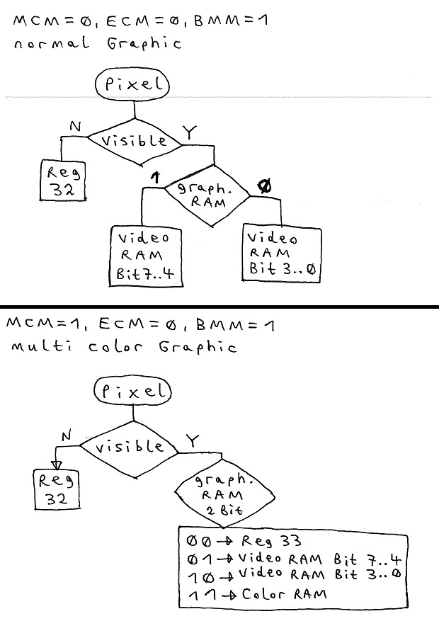

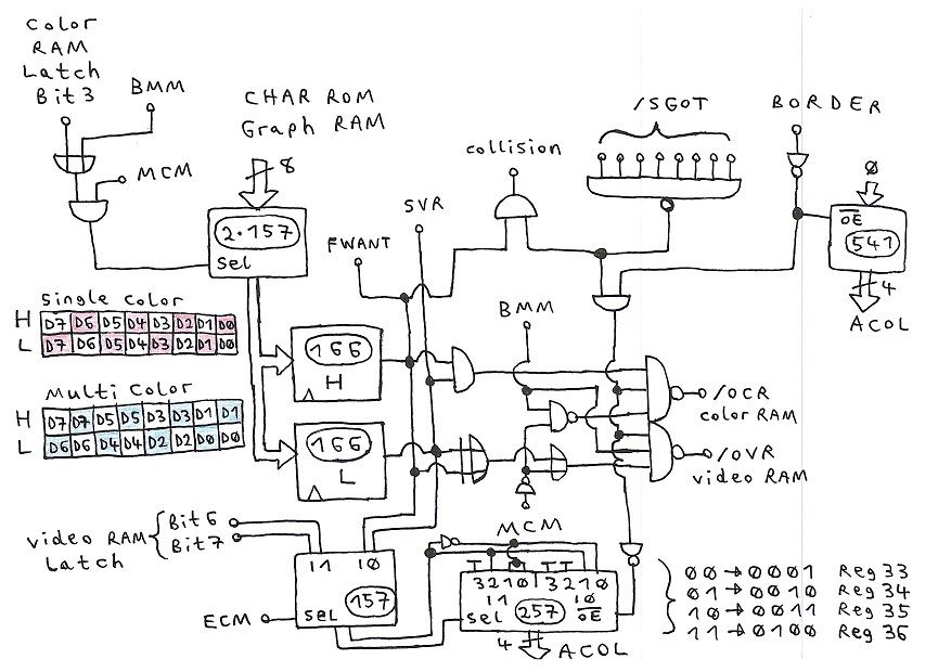

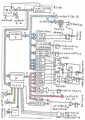

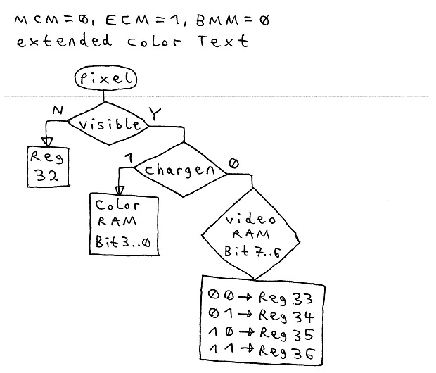

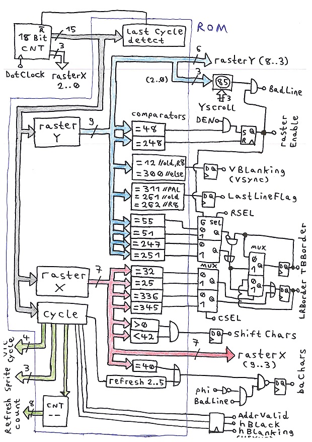

Some years ago, I did build my own (monochrome) TTL CRT controller, D04.
(Scroll down the page.)
Because generating the display address plus the control signals tend to take a lot of TTL chips,
I had decided to use a 27512 EPROM containing a "lookup table" instead.
The 8 MHz dot clock was divided down to 1 MHz by using a 74163 counter.
A 15 Bit counter (built from two 74393 counters) running at 1 MHz provided a 15 Bit address for the EPROM.
The EPROM then generated one 16 Bit word per microsecond which contained display address and control signals
(including sync signals and a RESET signal for the 15 Bit counter).
I'd say, that this trick also should work when it comes to building a TTL implementation of the VIC-II.
As a thumb rule, we could expect that the EPROM (one big EPROM or some small EPROMs)
would have to generate about 6 Bytes per microsecond.
Ok, maybe I had missed some control signals in this diagram...
on the other hand, the refresh counter value doesn't have to be generated by the EPROMs,
one could use a 74393 counter plus an inverting buffer like the 74240 instead.
Because when inverting the outputs of an up_conter, it _looks_ like a down_counter.
Because of the Y scrolling (and the 3 Bit comparator related to it),
the ROW and COLUMN counters would have to be implemented by using TTL chips, sorry.
BTW: we have 40 characters per line, that's $28 hexadecimal.
Interesting question is if we only need a latch for Bit 9..3 in front of the COLUMN counters.
When adding another address line to the EPROMs, one could have a switch on the front panel
to select for PAL or NTSC timing (that signal would have to go to the clock generator, too).

Dang: I just noticed that there seemed to be nothing about generating that AEC signal in FPGA64.
So the AEC generation is missing in my drawings, too.

Another thing is, that the VIC-II internally stores video data and color
for one line of text inside sort of a "shift register", that's 40*12 Bit.
Would suggest to use two SRAMs instead, with their address lines fed by the COLUMN counter.
Interesting side effect would be, that the text video plus color data for a complete frame
would be stored inside the RAM, what might be useful when it comes to interlaced...

Now about horizontally\vertically "pushing the envelope".
A problem when trying to increase screen resolution is compatibility.
Since the picture requires more memory, and the VIC-II only can generate
a 14 Bit address, one would be forced to tinker with the generation of
A14 and A15 for the VIC-II memory address at some point if the picture
requires "too much" memory.
In the C64, the color RAM is 1kB in size, starting at $D800.
If the color RAM would be bigger than 2kB in size, it would conflict
with the Kernal ROM which starts at $E000.
When the picture takes more memory, it's also an interesting question
at which place in memory the sprite pointers will show up...
It would be nice to at least try to be compatible with "something",
and that's why I had to add a link to the C65 documentation at the start
of the thread.
Increasing the horizontal resolution from 320 to 640 doesn't look too complicated.
For 320, we have a ca. 8MHz dot clock and a ca. 1MHz PHI clock (I'm simplifying things).
A 74163 working as a 3 Bit counter (those three Bits also go to the sprite X comparators)
divides the dot clock down to ca. 1MHz for that 15 Bit counter feeding the control ROM
address inputs.
When doubling the horizontal resolution to 640, we need a ca. 16MHz dot clock,
and the external bus has to run with a ca. 2MHz PHI clock for feeding the shift registers.
If the 74163 works as a 4 Bit counter, we still could run the 15 Bit counter for the
control ROM with ca. 1MHz.
Sprites are still displayed like in 320 mode, so the sprite shift registers
still are clocked with ca. 8MHz, and the uppermost three Bits of the 74163
have to go to the sprite X comparators.
The COLUMN counter would have to run at PHI speed (ca. 2MHz), and needs to have an additional Bit.
Increasing the vertical resolution from 200 to 400 does look complicated indeed,
because we need to go interlaced.

VIC-II has 5 valid display modes
(and 3 invalid display modes in which the screen is supposed to be blank).
Tried to do sort of some flow diagrams about what to do with the pixel data
at the output of the video shift registers.
BTW: "visible" in those flow diagrams means the pixel isn't inside the border
(and the pixel isn't inside the retrace blanking periods).

Now for the "hot part" of the design:
The circuitry that converts parallel video data to serial 4 Bit pixel color data.
Schematics are just provided as a concept of what to do with the data,
nothing more, nothing less. And it all probably contains some errors...
Notation looks a bit odd... mainly because I did this stuff in 2016,
before trying to dig into FPGA64, I just found the time to clean them
schematics up a little bit...
Note that 74670 'color register' block starting at $D020 in memory,
first color register would be Register32 of the VIC-II.
(One probably won't be building it by using 74670, but... well...).
Also note that 4 Bit address bus labeled ACOL3..0 for selecting the color register.
The block labeled 'Conv.' "somehow" converts the 4 Bit color data to digital RGB,
could be a ROM, a palette RAM, or both.

I'm just going to need to post two more schematics pictures now to prevent some details from "slipping from my brain".
ttlworks
Posts: 1464
Joined: 09 Nov 2012
Re: TTL VIC-II, some ideas
Post by ttlworks »
The bad thing when trying to implement the video data shift registers is,
that they shift one Bit per clock cycle when there is no multi_color,
but two Bits at every second clock cycle when there is multi_color.
An approach "according to the school books" would tend to result in quite some circuitry,
the circuitry probably would look a bit ugly, and it won't be too fast.
Inspired by the Air inlets of the SR-71, I decided to tinker with a concept
that pre_formats the 8 Bit data stream from the external data bus by using
two 74157 multiplexers into a 16 Bit bus, feeding two 74166 shift registers
(labeled H and L for a reason I don't exactly remember now) for shifting
the 8 Bit data.
IMHO this simplifies the circuitry fed by the shift registers a lot.
I'm not sure, if that AND gate for data\sprite collision detection
is placed correctly there, you better check.
/SGOT are signals from the 8 sprites, indicating that the sprite got display priority.
That 74257 feeding ACOL3..0 just increments a 2 Bit value by 1.
(74283 probably would have been slower... and without output enable.)
