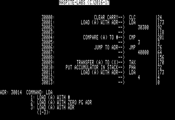

.......NOPE... your wrong. When I started learning assembly.. I couldn't take the hex, so I built an assembler that
did everything entirely in decimal... and then has my Assembler.. in basic.. poke the values of the assembly code
I translated from hex... its actually quite a good assembler (for me anyway)... there are also provisions for typing in
other peoples code by putting $ infront of the number and it converts it to decimal for me... can I show a pic here?

Seems we are not talking the same language. Mike was spot on saying you were using base 10 (decimal) and showed an example how it would look like in base 16 (hex). People on this forum definitely need to improve their reading skills! :shock: :roll:
I admire his spirit. Nail, meet sledgehammer.
There's something to learn here when someone decides creating an assembler is easier than learning a new number system.
As a note, I appreciate that it's like near impossible to get an output of an assembler in anything but hexadecimal (in terms of the assembler listing, and the addresses and op codes and what not), unless, of course, you're running on a PDP-* or something.
However, most any assembler will happily take decimal arguments:
        .ORG 10000
