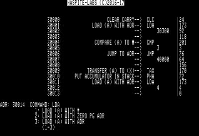

.......NOPE... your wrong. When I started learning assembly.. I couldn't take the hex, so I built an assembler that
did everything entirely in decimal... and then has my Assembler.. in basic.. poke the values of the assembly code
I translated from hex... its actually quite a good assembler (for me anyway)... there are also provisions for typing in
other peoples code by putting $ infront of the number and it converts it to decimal for me... can I show a pic here?
Just curious, why could you not "take the hex"?
PostPosted: Thu Sep 07, 2017 6:03 pm
Posts: 1004
I admire his spirit. Nail, meet sledgehammer.
There's something to learn here when someone decides creating an assembler is easier than learning a new number system.
As a note, I appreciate that it's like near impossible to get an output of an assembler in anything but hexadecimal (in terms of the assembler listing, and the addresses and op codes and what not), unless, of course, you're running on a PDP-* or something.
However, most any assembler will happily take decimal arguments:
        .ORG 10000
START   LDA 30001
        BNE TOOBIG
        LDA 30000
        CMP #16
        BCS TOOBIG
        ; 30000 is less than 16...
TOOBIG  ; 30000 is to big...
That's perfectly valid code, using decimal values and arguments. The listing, however, will be in hex.
