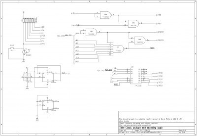

I've been trying to get IRQ working with this RTC for a couple of weeks but with no luck. What happens is that when I power on my SBC the RTC drives IRQ low despite the fact I've disabled IRQ in the init routine of the chip.
I've connected IRQ to the MPU (WDC65C02 1MHz) and it is pulled up (measured resistance between pin 5 on RTC and VCC and it is 3.3 kOhm). KS and Vbaux are grounded and PWR and RST are pulled up and not connected to anything else.

If you can, please post your schematic.
Attached. I see now that the direction of /PWR is wrong. It should be an outgoing signal (not that it matters, it's pulled high).

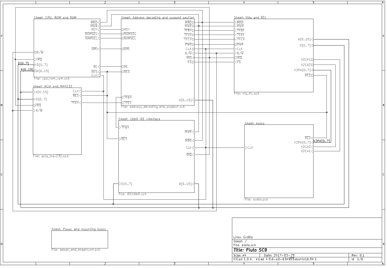

In monochrome, please, and if possible, the entire schematic, not just the 1511's connections. :D There must be some blue or something in there. It appears to me that information is missing.
Yes, the data bus is blue. So here's the schematics in good old black and white (OT I remember the joy of my parents buying a colour TV in 1976). :)
The RTC and two VIAs.
Daryl Rictor's address decoding logic.
MPU, ROM and RAM
Sheet layout
Mind you I have changed the schematics so the /KS pin is pulled high. I haven't tested if that fixes the problem though.
Two things I noted:
  1. I see a 74LS138 decoder in the system. That part should be a 74AC138 or 74HC138 (which is not very fast). You should avoid mixing logic types. In particular, the 'LS138 outputs will not pull all the way up to Vcc when the corresponding devices are not being selected, which could cause some really weird problems to randomly occur.
  2. It appears that you have the MPU's SO input marked as a no-connect. SO must be pulled up to Vcc, even if not used for anything. As a general rule, CMOS inputs should never be floated, as noise can cause device instability.
Well, all 74xx ICs are HCT. There are very few HC/HCT 74s in the KiCad libraries I've got.
[*]It appears that you have the MPU's SO input marked as a no-connect. SO must be pulled up to Vcc, even if not used for anything. As a general rule, CMOS inputs should never be floated, as noise can cause device instability.
Oops, missed that one (and it is also missed on SBC v2.5). OK pulled high now and the /IRQ pin is still low.
