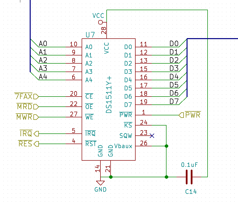

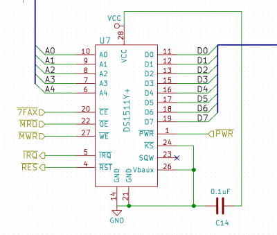

I've been trying to get IRQ working with this RTC...KS and Vbaux are grounded and PWR and RST are pulled up and not connected to anything else.
The DS1511Y data sheet says this about KS:
    Active-Low Kickstart Input. This pin is used to wake up a system from an external event, such as a key closure. The KS pin is normally connected using a pullup resistor to VBAUX. If the KS function is not used, connect to ground.
Despite what the data sheet says, KS should be pulled up to Vcc through a suitable resistor. That may be where your problem is located.
BTW, to continue with Jeff's line of thought, is the RTC really mapped in at $7FA0? That seems like an odd address for I/O hardware.
If you can, please post your schematic.
Huh, will try that tonight.
Yes, I'm using Daryl Rictor's SBC 2.5 address decoding logic which places IO at $7FXX. So the memory map looks like:
    $0000-$7EFF RAM
    $7F00-$7FFF I/O in 32 byte blocks
    $8000-$FFFF ROM
I've also triple checked that all wires goes to the right place on the MPU.
Attached. I see now that the direction of /PWR is wrong. It should be an outgoing signal (not that it matters, it's pulled high).
In monochrome, please, and if possible, the entire schematic, not just the 1511's connections. :D There must be some blue or something in there. It appears to me that information is missing.

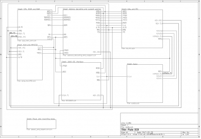

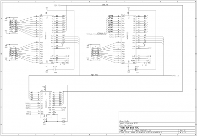

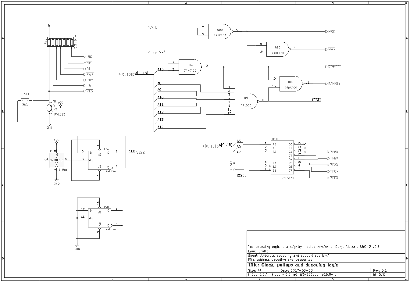

PostPosted: Wed Jun 21, 2017 6:15 pm
Joined: Thu Sep 15, 2016 1:52 pm
Posts: 60
Location: UK
Yes, the data bus is blue. So here's the schematics in good old black and white (OT I remember the joy of my parents buying a colour TV in 1976). :)
The RTC and two VIAs.
Daryl Rictor's address decoding logic.
MPU, ROM and RAM
Sheet layout
Mind you I have changed the schematics so the /KS pin is pulled high. I haven't tested if that fixes the problem though.
I hope I haven't missed anything and thank you so much for taking time to look at this.
Two things I noted:
  1. I see a 74LS138 decoder in the system. That part should be a 74AC138 or 74HC138 (which is not very fast). You should avoid mixing logic types. In particular, the 'LS138 outputs will not pull all the way up to Vcc when the corresponding devices are not being selected, which could cause some really weird problems to randomly occur.
  2. It appears that you have the MPU's SO input marked as a no-connect. SO must be pulled up to Vcc, even if not used for anything. As a general rule, CMOS inputs should never be floated, as noise can cause device instability.
Two things I noted:
Well, all 74xx ICs are HCT. There are very few HC/HCT 74s in the KiCad libraries I've got.
  • It appears that you have the MPU's SO input marked as a no-connect. SO must be pulled up to Vcc, even if not used for anything. As a general rule, CMOS inputs should never be floated, as noise can cause device instability.
  • Oops, missed that one (and it is also missed on SBC v2.5). OK pulled high now and the /IRQ pin is still low.
