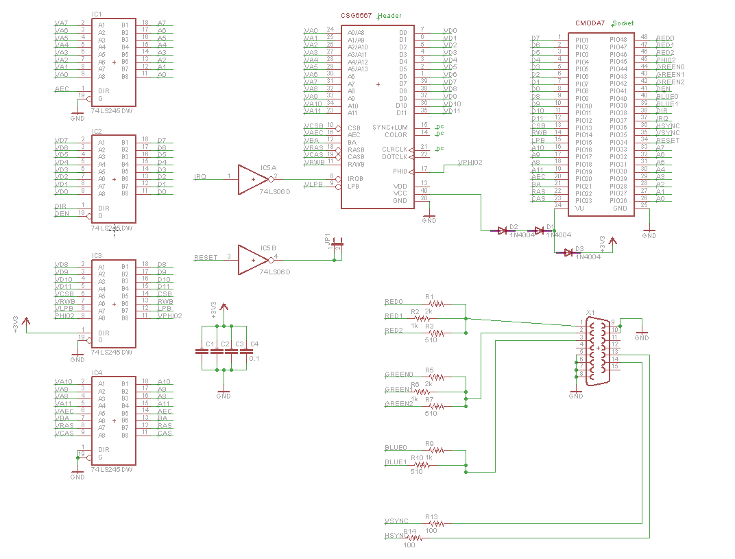

Re: FAL6567 back-burner project
Made up a schematic for FAL6567. Depends on an CModA7 FPGA module, but it would work with any FPGA module with enough I/O and resources onboard. Note it really needs more I/O's. Every single one is used and only eight bit VGA is supported.
The "LS" parts in the schematic are really LCX parts which can be powered by 3.3V and tolerate 5V on the I/O's. The 3.3V supply isn't critical so it's generated from 5V via some diodes. Floating point co-processing is under consideration. It's the kind of thing that only requires registers mapped into the memory space.
Revised schematic, noting that 2 I/O's on the CMod are analog. Down to 6 bit VGA.
Sorry, I did not realize that color would not come across.
