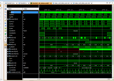

I just spent three hours trying to figure out why the raster 'Y' counter was updating at only half of the horizontal frequency only to realize I was looking at the wrong horizontal sync pulse and it was working after all.
Made some progress on the 'back burner' project in terms of developing the RTL logic. I wrote a wrapper that wraps up the FPGA64 video core to make it look like a VIC-II chip. It incorporates timing signals and a scan convertor. Got the memory access setup to use page mode for sprites. It's about 3,000 LUTs and 80k block ram. (Should fit into a Xilinx 7a15)
File comment: FAL6567 timing#1

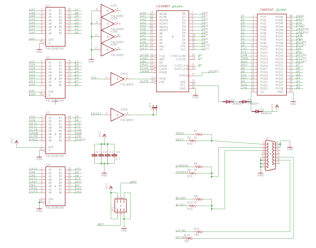

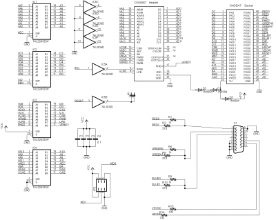

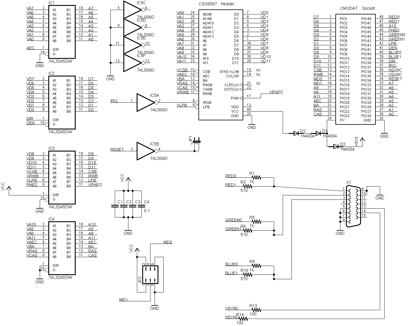

Made up a schematic for FAL6567. Depends on an CModA7 FPGA module, but it would work with any FPGA module with enough I/O and resources onboard. Note it really needs more I/O's. Every single one is used and only eight bit VGA is supported.
The "LS" parts in the schematic are really LCX parts which can be powered by 3.3V and tolerate 5V on the I/O's. The 3.3V supply isn't critical so it's generated from 5V via some diodes.
File comment: FAL6567 board schematic ver1

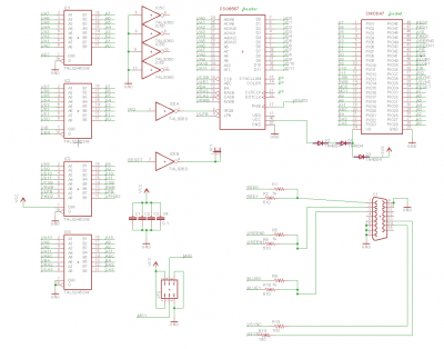

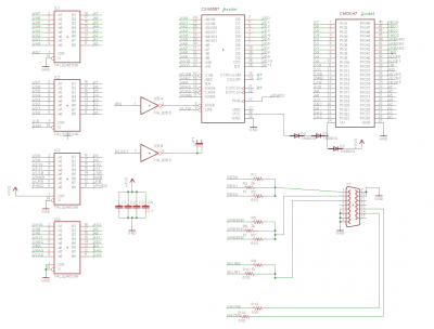

PostPosted: Wed Aug 10, 2016 11:21 pm
Posts: 449
Revised schematic, noting that 2 I/O's on the CMod are analog. Down to 6 bit VGA.
File comment: FAL6567 Schematic #1 revised
http://www.finitron.ca
PostPosted: Thu Aug 11, 2016 4:56 am
Posts: 8198
Can't read it because of the colors. :(
PostPosted: Thu Aug 11, 2016 5:07 am
Posts: 449
Sorry, I did not realize that color would not come across.
File comment: FAL6567 Schematic Monochrome
