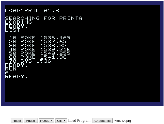

Printing $41 via the BSOUT ($FFD2) kernel subroutine will display an 'A'.
Sounds like a good worked example. I'll use easy6502 to assemble and to get a listing:
Address  Hexdump   Dissassembly
$0600    a9 41     LDA #$41
$0602    20 d2 ff  JSR $ffd2
$0605    60        RTS
To run this using SYS we'll need to convert the program to decimal bytes and POKE them in. (Easy6502 defaults to producing code at $600 and always disassembles from there, so I've left that as is. In this case the code isn't sensitive to where it's placed)
POKE 1536,169
POKE 1537,65
POKE 1538,32
POKE 1539,210
POKE 1540,255
POKE 1541,96
SYS 1536
and it works as expected:
Screenshot from http://www.thomasskibo.com/6502/pet2001/
