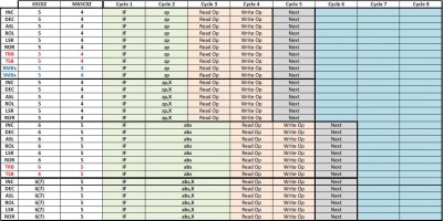

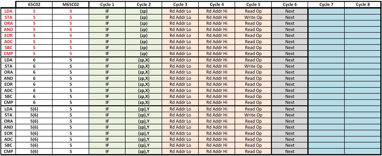

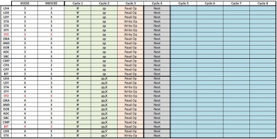

I don't agree with your conclusion regarding the number of cycles that may be saved by an unpipelined '02/'816. I have pasted in two instruction timing tables below. The first shows the instruction cycles for the simple ZP read-only and write-only addressing modes, and the second shows the instruction cycles for the ZP read-modify-write addressing modes. The column labeled Fetch and the column labeled Next represent the memory/instruction cycles than can be overlapped. As can be seen from the first figure, the M65C02 and the 65SC02 are able to overlap most these cycles to report the same number of memory/instructions cycles. The 1 cycle difference reported for the zp,X and zp,Y addressing modes comes from the fact that I included a separate address generator in my implementation of the '02/'C02 ISA that allows the M65C02 to make the indexed calculation directly as the next output address is being generated. (This approach works well in an FPGA using high-speed asynchronous memory, but not so much with synchronous RAM.) In neither addressing mode is there an opportunity, in a von Neumann memory architecture, to save two instruction cycles for ZP variables. This is more obvious in the second figure which highlights the instruction cycles for ZP read-modify-write operations. In the second figure, the M65C02 has eliminated one "dead" cycle, and can perform an operand read immediately followed by a ALU result write cycle. A standard '02/'C02 must perform the ALU operation after the operand read cycle, and therefore creates a "dead" memory cycle. (The most significant improvement between the '02 and 'C02 is that the 'C02 reads the source operand address during the internal "dead" cycle instead of writing to the destination address twice as is done by the '02. This improvement, in general, allows the RMW instructions of the 'C02 to be used with R/W control registers of memory-mapped I/O devices. Again, this is not a generally recommended programming practice for memory-mapped I/O devices. Since the M65C02 does not include the dummy read cycle, its RMW instruction behavior can be used with R/W control registers of memory-mapped I/O devices.)
M65C02 zp; zp,X; and zp,Y Instruction Cycles
M65C02 RMW zp; and zp,X Instruction Cycles

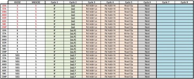

Edit: the following figure was inadvertently loaded rather than the preceding figure. MAM
M65C02 (zp); (zp,X); and (zp),Y Instruction Cycles

cr1901
