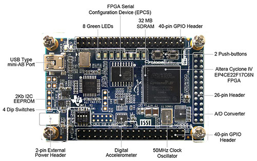

John Kortink ('windfall' here) has brought the Terasic DE0-Nano board to our attention: it's Altera based, with a 32MByte SDRAM on a 16-bit wide bus, total of 72 GPIO on two 40-pin connectors.
It's USB-powered at 5V but the I/Os are 3V3. One of the demos in the User Manual (pdf) has the memory clocking at 100MHz.
http://www.digikey.co.uk/product-detail ... ND/2625112
http://uk.farnell.com/jsp/search/produc ... ku=2076463
