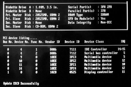

A Splash screen showing the BIOS information, and possible user commands.
http://img.tomshardware.com/us/2007/10/ ... _00ghz.png
Then it loads your IDE drives and then figures out what services are available on the bus as well:
And that information goes onto a table in RAM to allow the software to be written without prior knowledge of the system for the program to run.
BIOS doesn't handle user commands; that's a monitor's job (also known as a "shell").
Not always. See CP/M for an example BIOS which didn't enumerate anything. And, see Tandy 1000 computers for an example which had MS-DOS in ROM, and thus never booted from any storage device.
And, you don't need a BIOS for this to happen either :-) -- see the Commodore-Amiga for an example where the most of the OS was packed into ROM, but yet still satisfied hardware-independence so well that it took Microsoft another 12 years to compete reliably with Amiga's "AutoConfig" system, and 10 years for Intel to catch up with the founding of the PCI SIG. Apple and IBM was also late to the party, with the release of NuBus-based Macintoshes and Microchannel-based PS/2 machines each a few years after the introduction of the Amiga.
