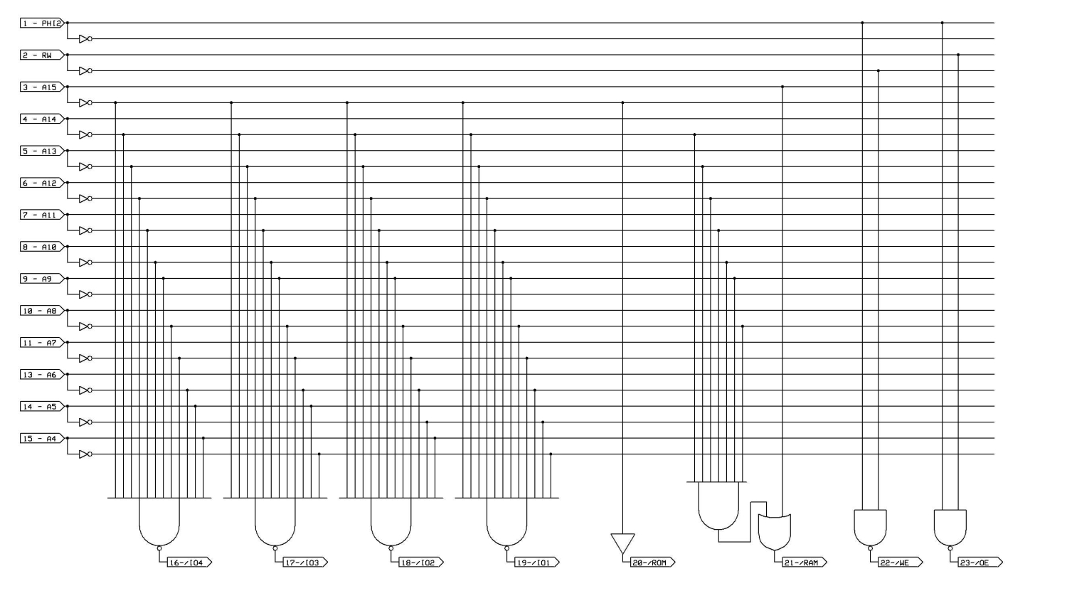

I have come up with a simple memory decoder that can be used as a building block for computer builders.
It consists of a 24 pin 0.3" wide DIP Lattice 22V10 GAL chip programmed to provide chips selects to a 32K ROM, 32K SRAM, and four IO Devices. It will also take the RW and PHI2 pins from the 6502/65816 and produce a /OE and /WE signal for the memories.
This one chip can be used to replace several standard logic chips and also provides flexibility in assigning IO addresses.
The standard map will look like this:
$0000-$01FF - RAM
$0200-$020F - IO Device #1 (16 bytes)
$0210-$021F - IO Device #2 (16 bytes)
$0220-$022F - IO Device #3 (16 bytes)
$0230-$023F - IO Device #4 (16 bytes)
$0240-$02FF - unassigned (can be externally decoded for use)
$0300-$7FFF - RAM
$8000-$FFFF - ROM
Since the device is programmable, custom maps can easily be created.
Options include adding a second RAM chip select to allow for more RAM and less ROM, i.e. 48K RAM and 16k ROM.
The propagation delay is 10ns.

If you move the outputs to pins 15 to 22 and use pin 23 as an input then the decoder will also fit in the 20V8 device.

Good suggestion, Lee.
However, those chips will not support ANDing A15 through A4 for the IO device selects as each output can have only 8 product terms.
The 22V10 supports up to 16 product terms per output. (it varies for each output)
However, a system that could have each device occupy 256 bytes would work. i.e.,

I'd forgotten that the 20V8 only allows 8 terms but in the past I've not found it a problem if outputs can be reused (remembering the increase in propagation delay).
E.g if you have ROM as $8400 to $FFFF then by using !ROM and A15 you still have six terms for other address lines, R/W and phase 2.
Lee.

I have compiled the logic for the default configuration for a 22V10.
Here is a schematic picture of the equivalent circuit:
Each output will have a maximum of 10ns propagation delay from the inputs.
Daryl

Maybe I misunderstood your statement regarding anding terms but this is as far as I know: Each product term in a 20V8 is essentially a 32-input AND gate. Allowing you to create AND equations featuring every combination of all inputs to any one of the 8 product term (OR) inputs. You should have no problems creating very complex address schemes using a 20V8 device, or a 22V10 for that matter.
Edit: Which you already knew as I could see from the source code. Never mind my comment :oops:
/Pontus
