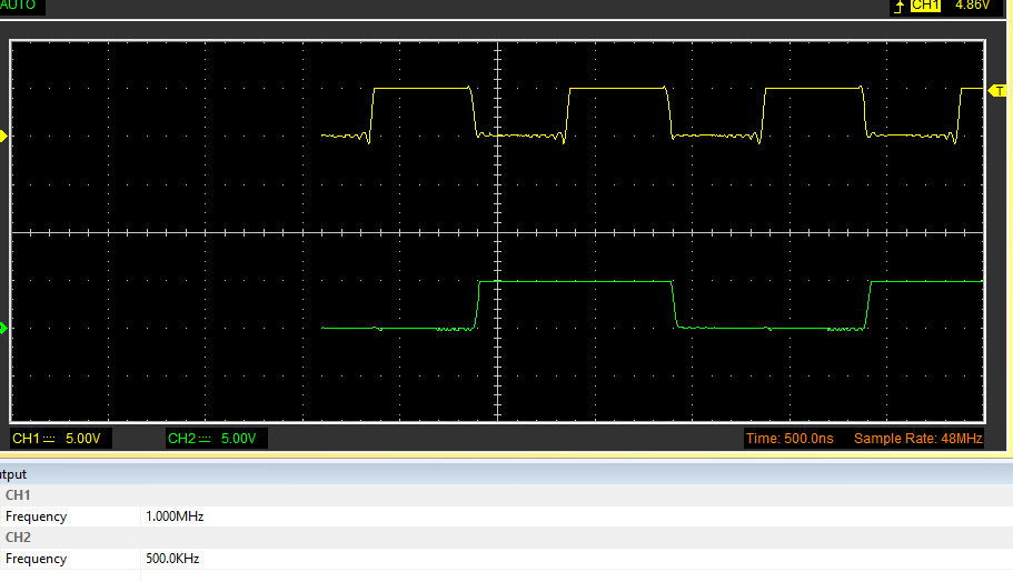

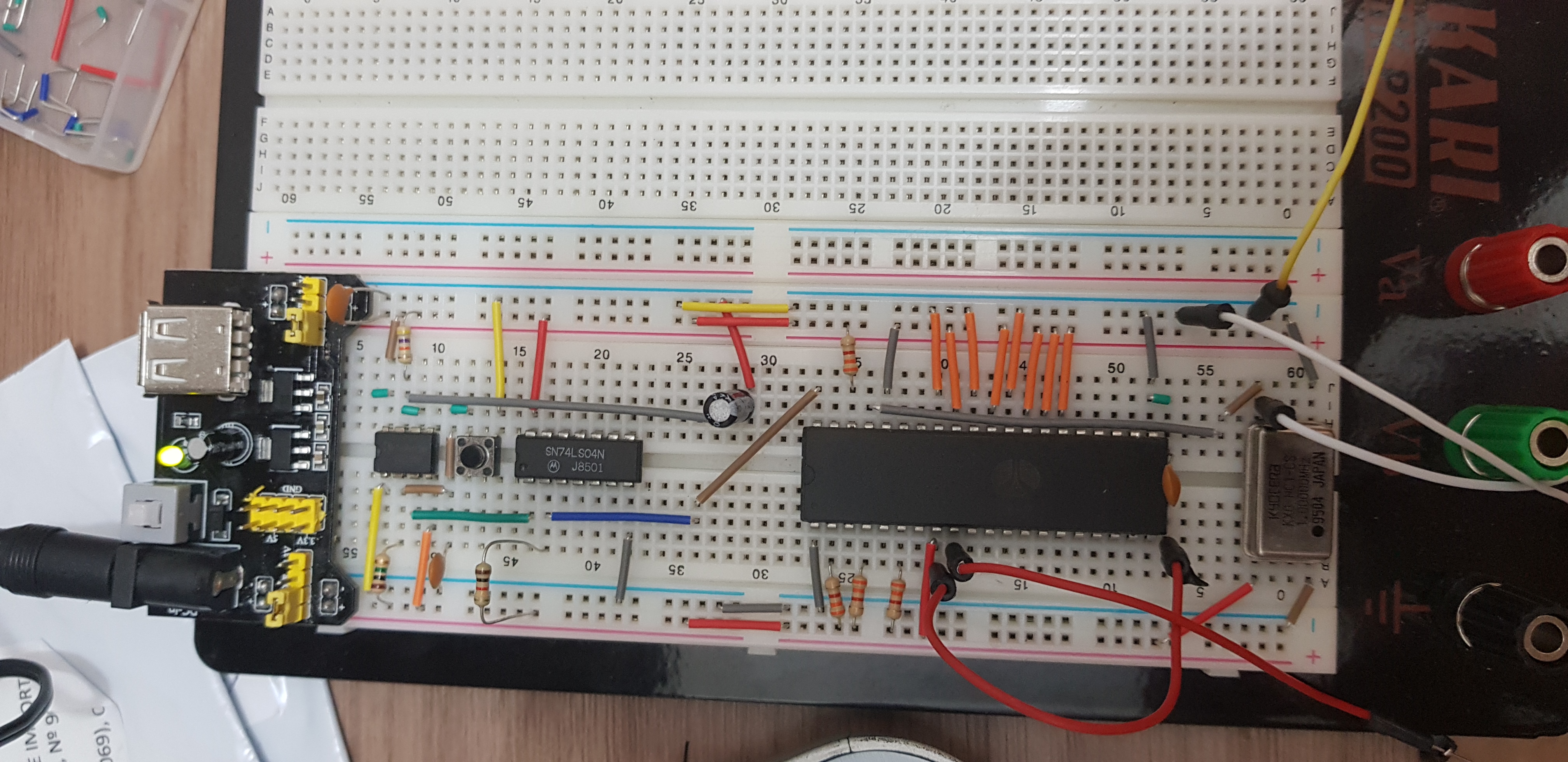

Hello guys.
It's me again and I'm just totally stuck. I reset all my circuit and simply when I set up the data bus to run NOP forever, A0 stays at 500 Hz. That is, it is not consuming 2 CPU cycles. Is it possible for this processor to have a "cache" of execution?
If you can also put a link where I can buy an original 6502, I thank you immensely.
Below are images.
Below are images.

Re: Writing in EEPROM and reading by 6502
hitlp wrote:
whartung wrote:
So, for laughs, is A1 half of A0, and A2 half of A1?
It would be interesting to change the EA to a branch code, and discern what an address pin might look like over time, and see if that matches.

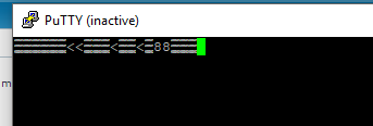

Hello guys,
I have some news about my project. While I can not get a real 6502, I'm using 6507 taken from an old Atari. The processor is responding correctly, for example when I use the data bus as "EA" (NOP). I made the connection to the EEPROM and it worked correctly.
Now, following the project http://www.grappendorf.net/projects/650 ... world.html [/ url], I called the ACIA and a FTI232 to receive a string (Hello World) via serial.
It turns out that I only receive garbage according to the attached image.
My schematics is:
Since the 6507 has only 12 bits of address, my code used is:
Segments
Principal Code:
Any tips?
Regards.
My schematics is:
Segments
So - a 6551. Exactly which 6551 is it? The "latest genuine" WDC parts have a nasty hardware bug, though I don't think that's what you're seeing here.
Also, 19200 baud is near the limit of the 6551's capabilities. Usually 9600 or 1200 baud are better choices for initial tests.
Make certain both ends are set to the same speed for both transmit and receive (many UARTs can set TX and RX parameters independently). It looks like you're receiving more characters than you sent, which may indicate the receive speed is set too high, or the transmit speed too low. Note also that the values you need to poke into the 6551 depend on the clock speed attached to it (usually a UART has a standard-frequency crystal dedicated for this purpose).

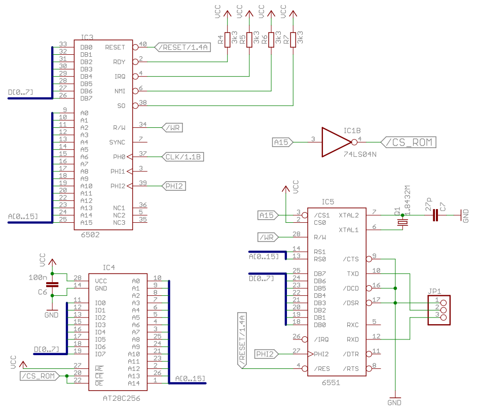

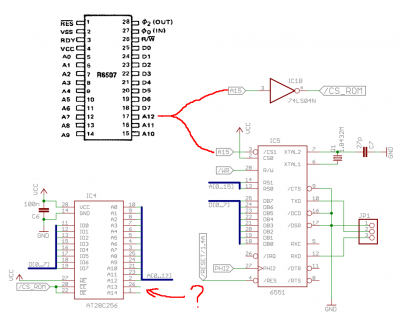

How have you modified the circuit? The 6507 lacks several signals noted in the original diagram (which is intended for 6502).
I think the connections formerly driven by A15 can connect to A12 (as shown). But other wiring questions remain. Also, some of the values declared in the program may need to be changed.
First, please tell us what you've done with the wiring.
cheers
cheers
Hello guys,
Well answering the questions, I tested with baudrate of 1200 and 9600 and kept getting trash on the way out. I am using as clock source, a crystal of 1.8432 MHz connected in pins 6 and 7 of 6551.
Answering Dr Jefyll, since the 6507 only has addressing up to A12, I connected this port to 6551 as if it were the A15 of 6502. Another replacement I did was that, instead of the AT28C256, I'm using the AE29f2008-12 which is a memory flash removed from a PC BIOS. The pinning is very similar to the AT28C256.
The other ROM address pins are disconnected, as A13, 14 and 15.
What can be wrong?
What can be wrong?
The unused ROM input lines must be tied definitely either high or low, not left floating. This is generally true of all CMOS inputs, even of spare gates on a multi-gate 74-series chip. Having not done that, there is a good chance the ROM is confused about what addresses the CPU is requesting.
