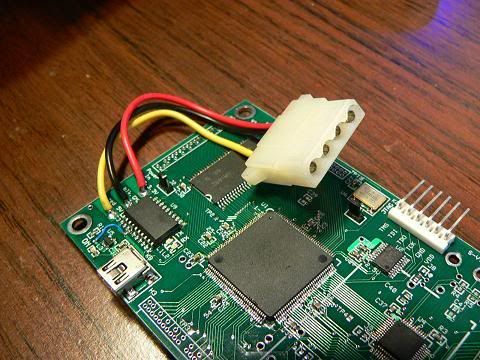

Ok, spent the free time I had over the last 2 weeks putting together a board for Arlet and this morning I have finished!!! I applied power and iMPACT saw the FPGA PROM and the Spartan 6. I programmed it with my current progress and the TFT cleared screen and C'mon's dash prompt appeared. Success! Tomorrow I can mail it off. And so now I go back to concentrate on getting the I2C core to work...
Here's some close-ups of the soldering which you can see isn't at all perfect, but it works!
TOP
BOTTOM
TOP
BOTTOM

For the old ATX12V 400W power supply I am using, I had labelled the colors according to the voltages, but the 4-wire female connector I spliced in on the power side (meant for HDD's/CD drives) doesn't have 3.3V (orange). I haphazardly matched the wires from the power supply to what was needed on the board. In the end pay attention to the DC Voltages spec'd on the board itself, not the colors. And thanks for pointing that out! I am making many notes for V1.2...

I've checked and re-checked, and I found I had left out R19&R20, the 4.7K pull-up resistors for I2C. The board has now passed "my QC"
Arlet, one final note: I guess they are the impedance matching? resistors on the video outputs. The datasheet says to either use 75 ohms or 300ohms. If you are not sure either, I will include 3 of each resistor value, 1 for composite (R6) and 2 for S-Video (R4,R5). And speaking of S-Video, if you do get around to soldering that connector (Digi-Key #CP-2240-ND), it goes on the bottom with the composite RCA connector.
