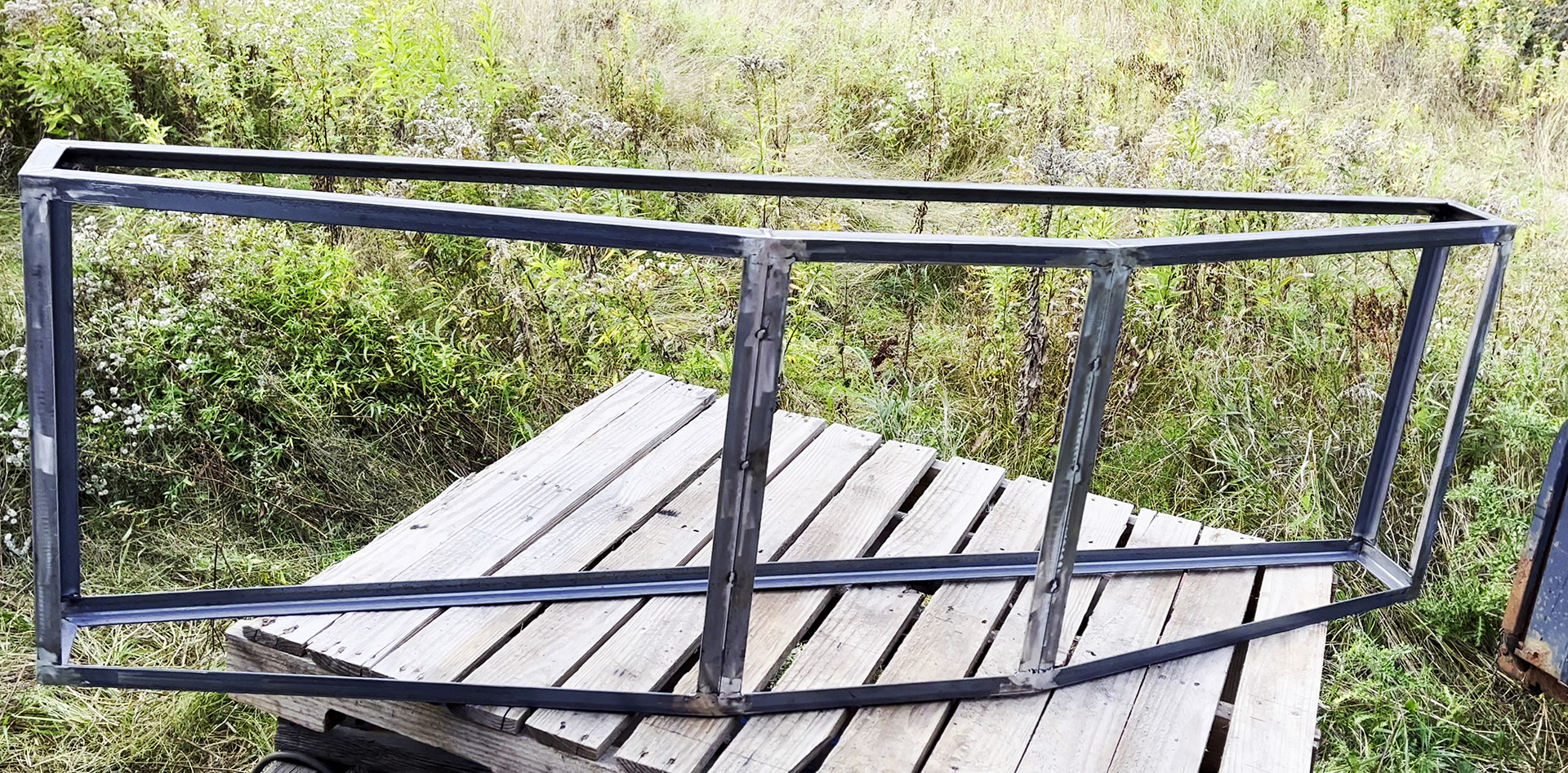

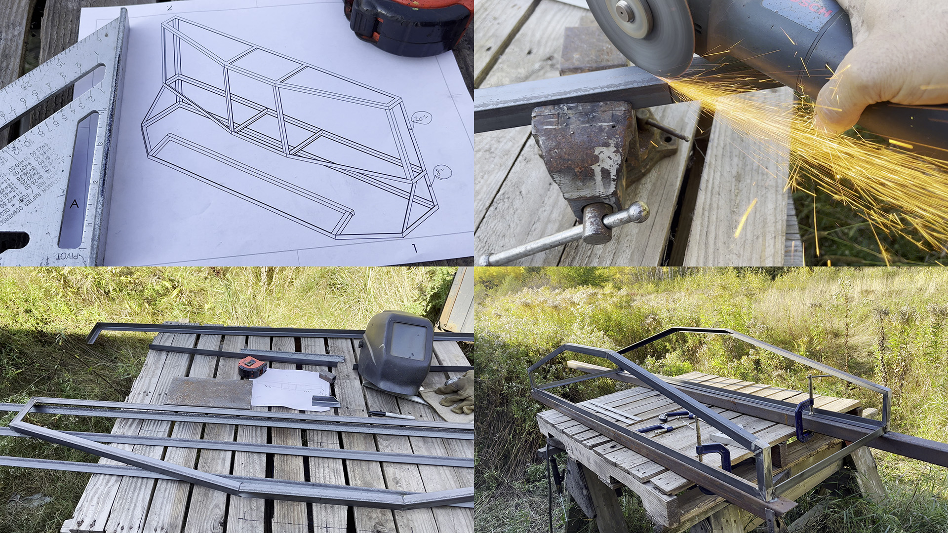

Wow, it has been 6 years since I did any real form of accurate welding, but it came back to me after a while.
Last thing I built with any real precision was my electric tractor, and that was in 2018.
I had half a day to spend in the old shack out back and managed to get the entire top segment of the frame together.
Welds are not complete or smoothed out yet, but it makes the project feel real to finally see it come together.

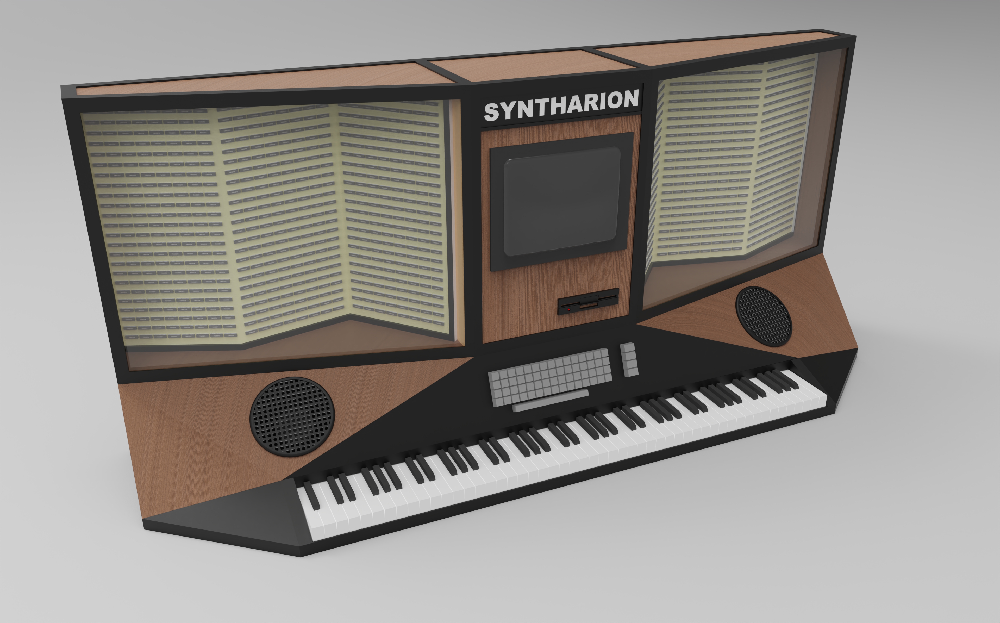

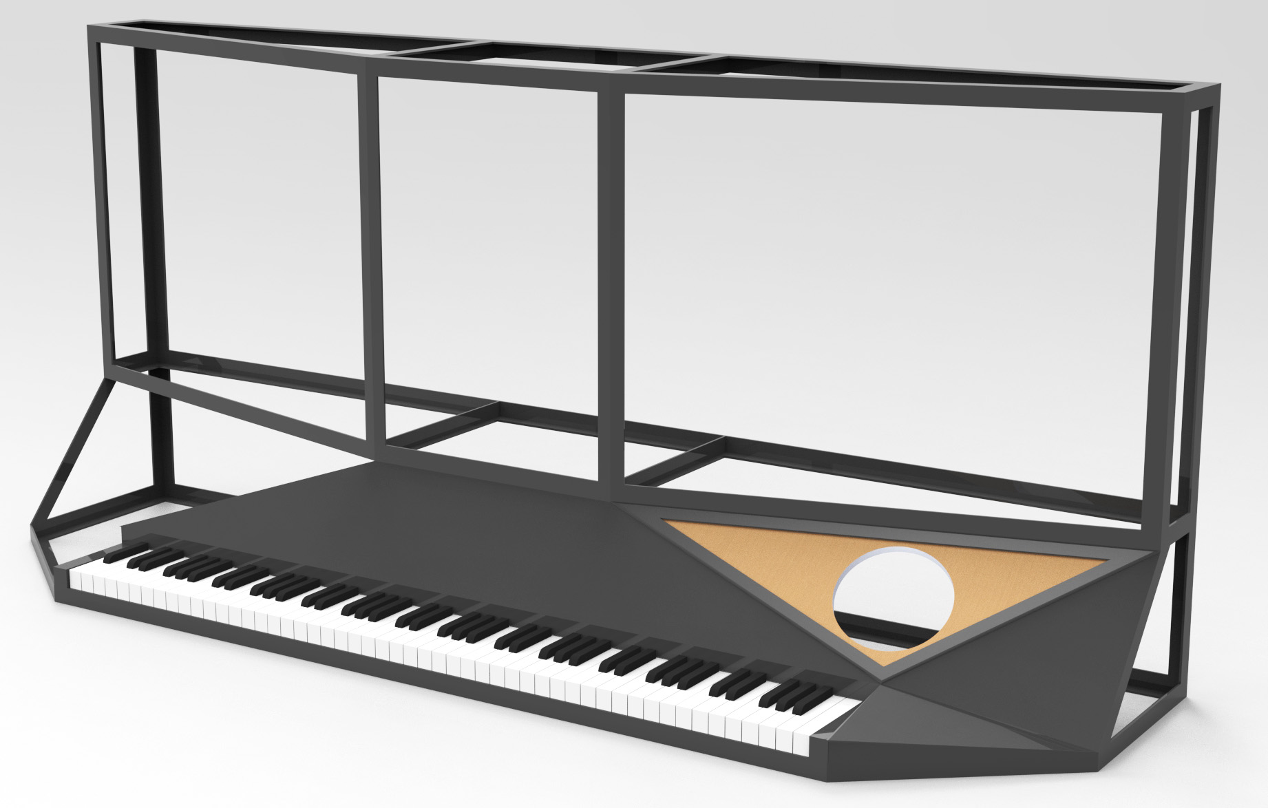

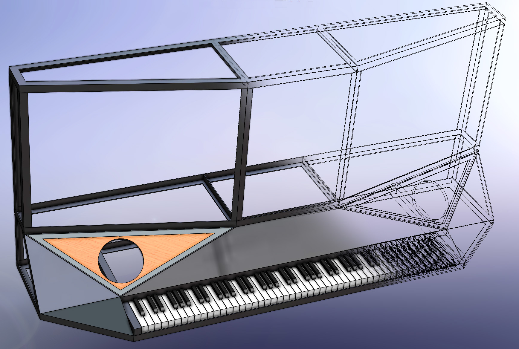

Here is what I am aiming for....
And here is the top frame segment...
A few stills from the many videos I took today...
It probably took more time to get all of the action shots than to actually cut and weld the frame.
I am making a very detailed video series of this build later, so there can never be enough video.
Even made a head mounted iphone holder so I can do POV welding and grinding.

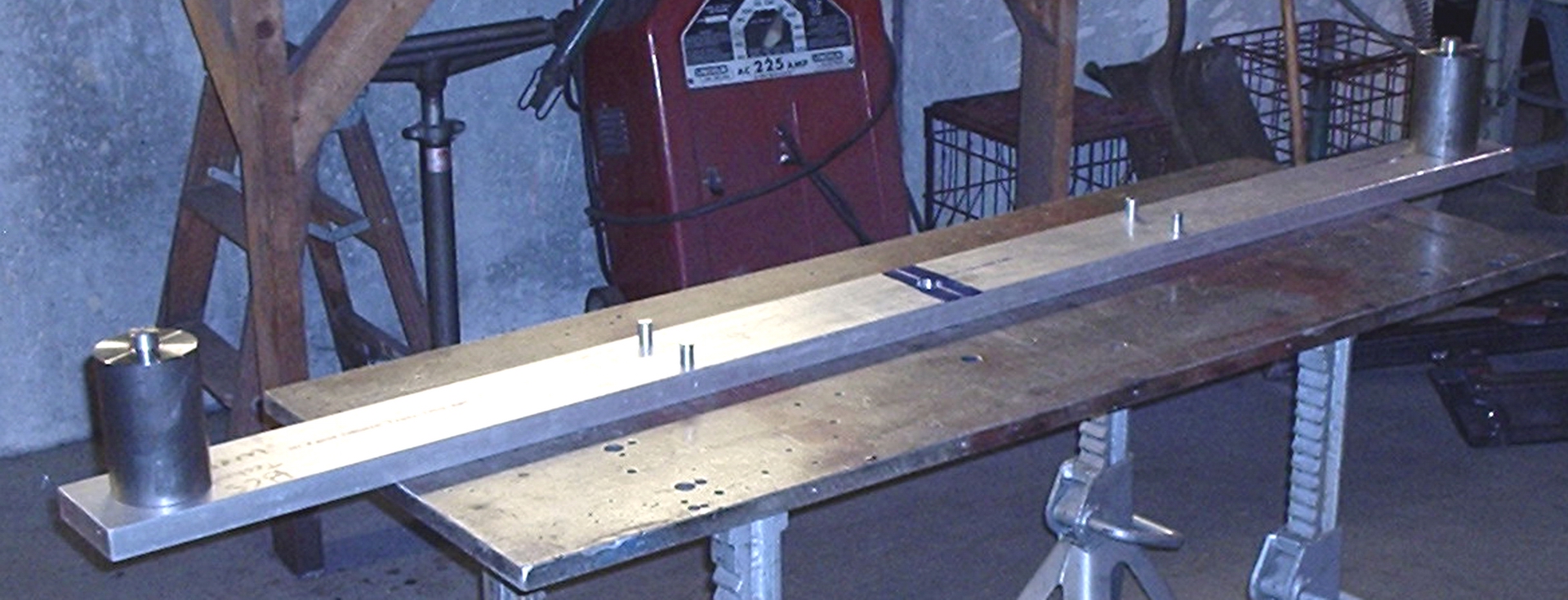

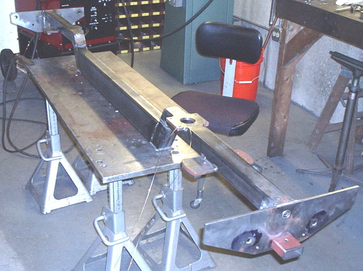

Over the years, I have found a number of uses for a pallet.  Acting as a welding table wasn’t one of them.  :D  I’d be afraid of setting the damned thing on fire.  :shock:
When I need to build a weldment such as what you are doing, I get out this big hunk of aluminum tooling plate that I’ve been using for some 50 years.  I just set it on some jackstands, which puts the work at a height that is comfortable for welding while I’m seated.  In the below photo, I have it set up with a welding jig on top of it.
Makeshift Welding Table
The tooling plate is four feet in length, 3/4 inch thick and despite being aluminum, weighs over 100 pounds.  Back when I was a young whippersnapper, I’d just pick it up.  Nowadays, I use the cherry-picker to lift it and thus avoid making an unscheduled visit to the nearest emergency room.  :o
Here’s another view of it in use.

Nice shop, and certainly a durable and flat table to work on.
My current shop is the great outdoors, and my clients... "whatever breaks on the farm"!
It was a chore to make that complex frame true, but I managed to do it, using a lot of shims on that old pallet.
Also did catch the grass on fire a few times, but that's usually what happens.

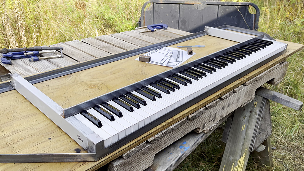

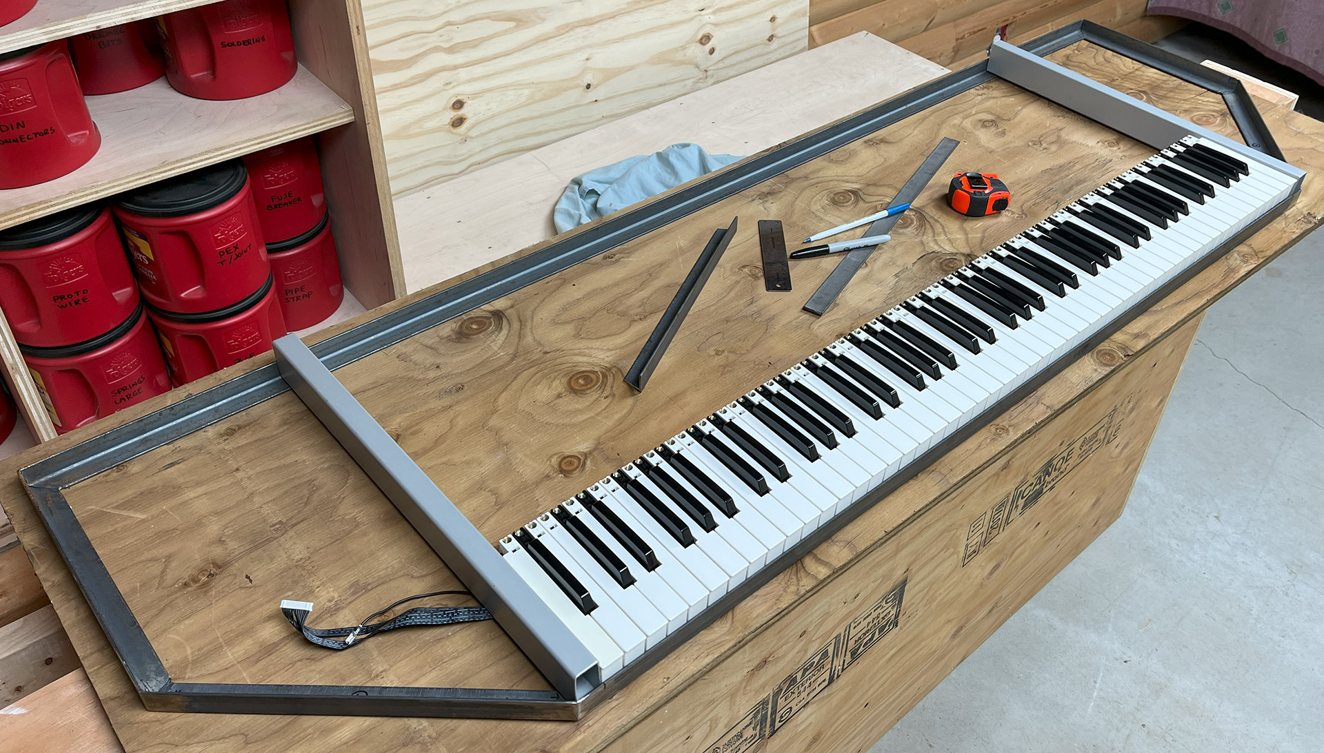

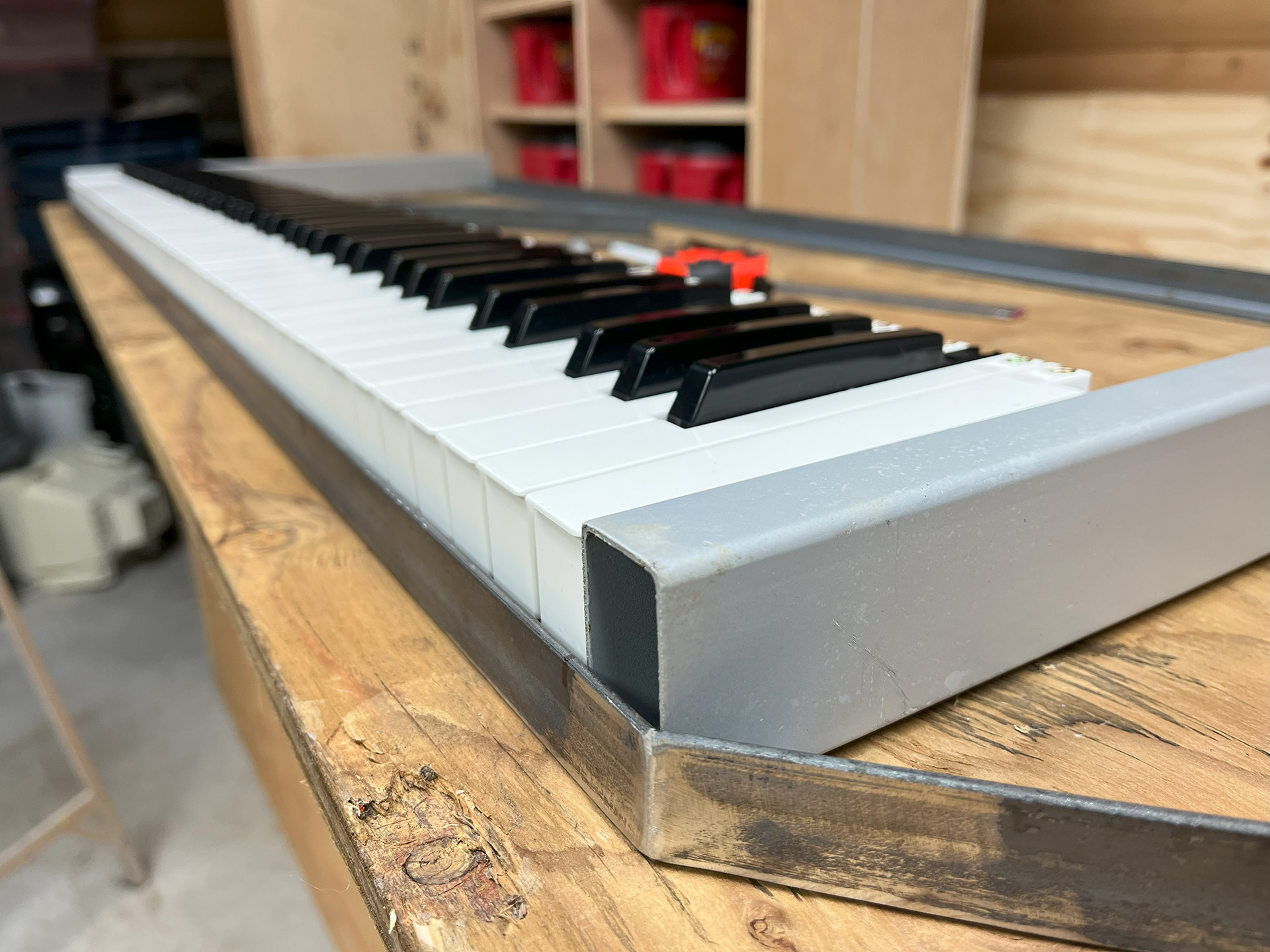

I am fitting up the 88 key piano hardware today, one of the last "precision" parts of the frame.
I hope that old pallet I am using as a workbench hasn't warped too much in last night's rain.
Base frame with the 88 key assembly...
Found some spare 1 inch by 2 inch tubing that was exactly what I needed to make the side supports...
Now I need to adjust the frame model to support this small change in design.
I always build using recycled parts, so the "plan" is always just a guide.
Later!

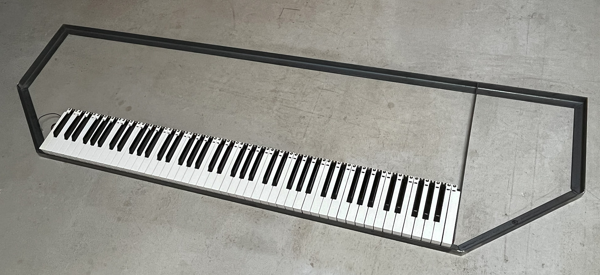

Some adjustments to the base frame and front plating.
I like this better, plus the 1x2 square tube will make a great mounting point for the removeable caster/legs, putting the load on the strongest part of the frame.
Time to get that buzz-box sparking again!

The trees are shedding their leaves and the sun is setting at 7:30 now so I am in a hurry to get the basic frame done before the snow hits the ground.
I am not worrying about the final weld and grind work, just the basic frame with all bars and plates installed.
If I have the skeleton sitting inside all winter, it will be motivation for all that wiring that is coming soon.
Started by framing in the keyboard with the 1x2 square tubing.
This will allow an attach point for the stand as well as ensuring that there is no flex in the frame around the keyboard.

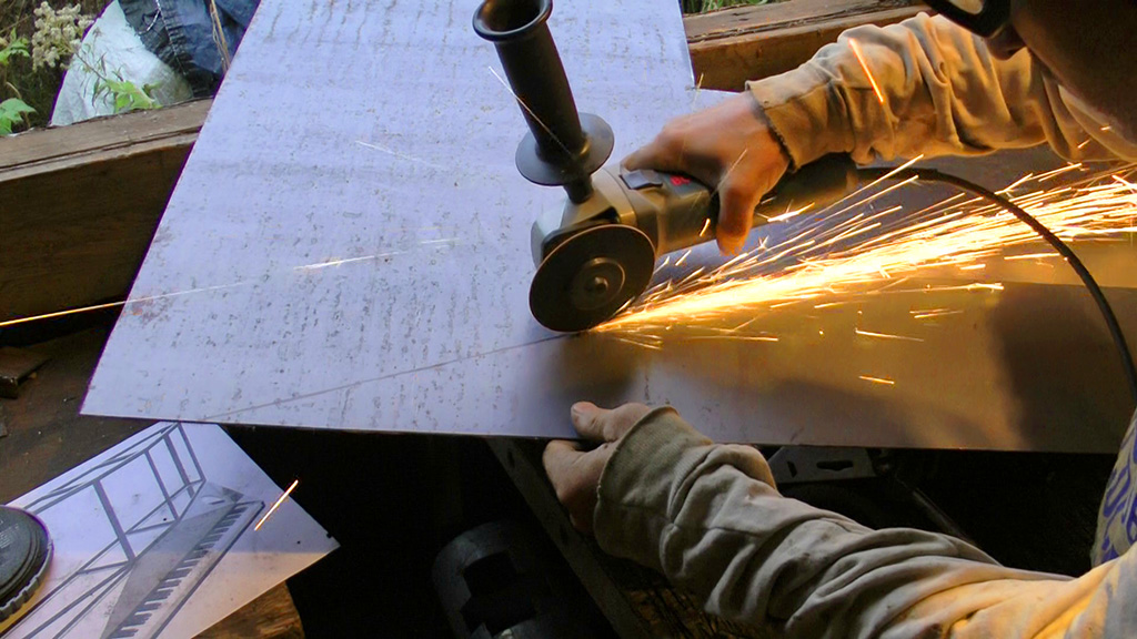

Cutting the front plate. This will join the top and bottom parts of the frame and is the place where the VIC-20 keyboard & mixer controls live.
I will cut the keyboard access later once I can bring the frame indoors for fine dremel cutting.
Welding the front plate to the top and bottom half of the frame. It was starting to rain, so I put it into overdrive tonight.
Here is the frame now. Still needs the speaker grill plates and side plates, but almost completed.
It is actually not as heavy as I figure it would be, bust is still not your average plastic synthesizer frame!
Made a small adjustment to the front of the frame where the keyboard edge meets the front corner.
If the weather holds up, then perhaps I will get the other smaller plates installed this weekend.

Given the amount of metal work you are doing, and have done with the bikes, I’m surprised you don’t have a plasma cutter and GMAW (MIG) welder.  Stick welding is okay—I still use my old Lincoln buzz box for some jobs, but it’s possible to work faster with MIG, as well as produce much smoother welds.  Plus there’s no slag to chip, and with the right shielding gas (I use 75/25 argon/CO2) and wire, it’s easy to weld thin sections and keep warpage and spatter to a minimum.  Only thing with MIG is welding outdoors can be a challenge if there is anything more than a very gentle breeze.
As for cutting sheet metal with an angle grinder and stone, I haven’t done that since the 1970s.  When it comes to dicing and slicing sheet metal, a plasma setup is the way to go if you don’t have access to a shear.
