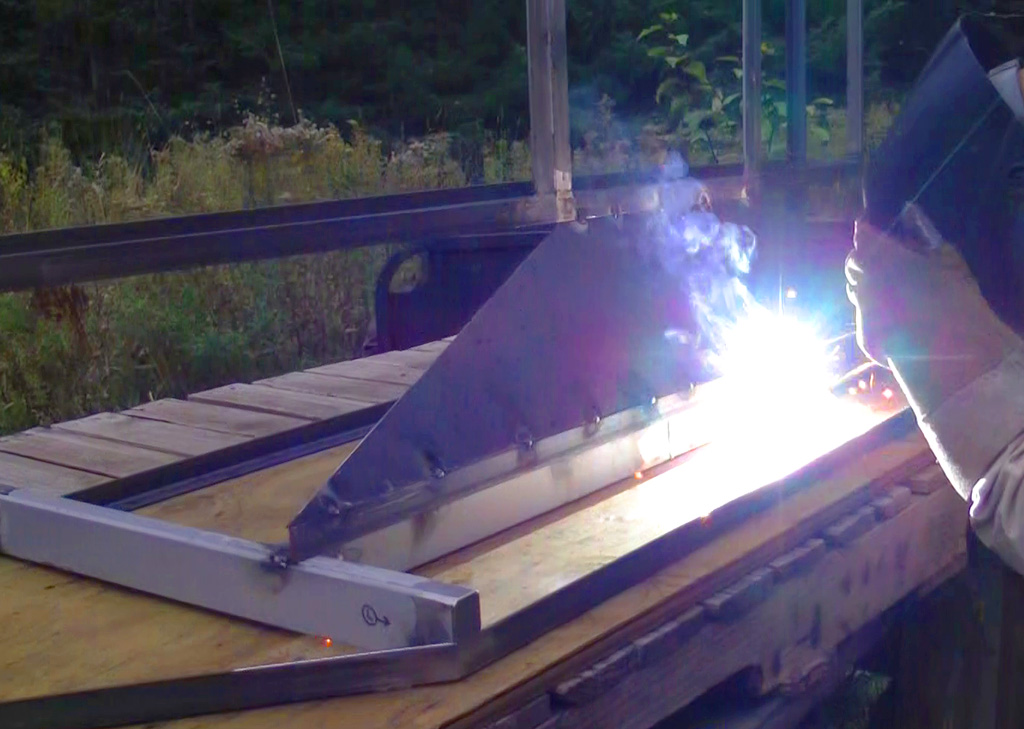

The trees are shedding their leaves and the sun is setting at 7:30 now so I am in a hurry to get the basic frame done before the snow hits the ground.
I am not worrying about the final weld and grind work, just the basic frame with all bars and plates installed.
If I have the skeleton sitting inside all winter, it will be motivation for all that wiring that is coming soon.
Started by framing in the keyboard with the 1x2 square tubing.
This will allow an attach point for the stand as well as ensuring that there is no flex in the frame around the keyboard.
Cutting the front plate. This will join the top and bottom parts of the frame and is the place where the VIC-20 keyboard & mixer controls live.
I will cut the keyboard access later once I can bring the frame indoors for fine dremel cutting.
Welding the front plate to the top and bottom half of the frame. It was starting to rain, so I put it into overdrive tonight.
Here is the frame now. Still needs the speaker grill plates and side plates, but almost completed.
It is actually not as heavy as I figure it would be, bust is still not your average plastic synthesizer frame!
Made a small adjustment to the front of the frame where the keyboard edge meets the front corner.
If the weather holds up, then perhaps I will get the other smaller plates installed this weekend.
Well... depends on the farm chore list too.
Later!
Radical Brad

My main concern has always been the time required to get something done.  I built most of my first race car’s chassis with a buzz box, and basic tools to cut and fit steel.  However, it was a very time-consuming process to get things right—about three years from when I started to when the car made its first run.
So when I decided to build the next car—which was expected to go a *lot* faster than the first one, I thought about the problems of building a frame that was square, straight and strong.  I also thought about the importance of having a roll cage that could withstand a high-speed crash.  A tertiary thought was about how much time would be involved with all the cutting, fitting and welding, especially when my job had me constantly on the road.
All considered, I decided being proud of being able to build a race car using basic tools wasn’t nearly as important as being able to build a car that would perform, be survivable in a crash, and not require a huge amount of time to complete.  Those factors led to me acquiring better tools, especially the MIG welder.  The build took about two years, start to finish, despite being significantly more complicated than its predecessor.  I credit a lot of that to having better tools at my disposal, as well as some experience gained from the first build.
