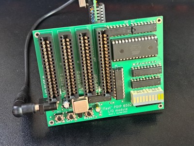

This is coming together - just the CPU board to go. My wife helped with the soldering. The empty sockets are for ROM, a PLD, and the I/O clock oscillator as I'm not sure what speed to go with yet.

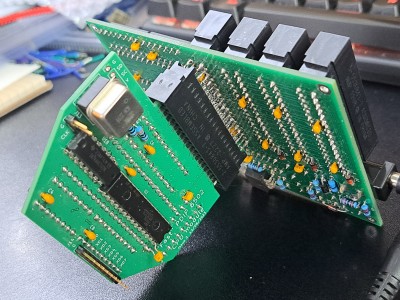

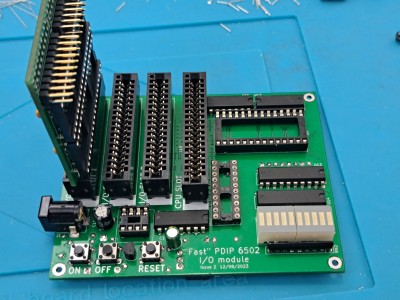

The CPU board is soldered as well now, but somehow I've managed to make a nasty error with the card edge connector - all its pins are on the opposite side of the board to where they should be! It seems to only affect the CPU board - the VIA board's pins seem to be fine. In the picture above, the VIA board when mounted correctly has its "front" side facing to the right, and the connector's even pins are on that side of the board; but I've somehow got the edge connector footprint flipped on the CPU board, so that when I mount it with pin 1 at the bottom as I intended, the front side of the board - with even-numbered pins - is to the left rather than to the right, while the receptacle footprint on the main board is consistent, expecting even pins on the right.
Unless anybody has any better ideas, I think I'm going to have to desolder the CPU slot connector and put it on the back of the main board instead for now, so that the contacts are on the correct side of it. It's going to be tricky to desolder it, and after remounting it the whole thing will be a bit of an awkward shape physically, but I expect I will make other variants of the CPU board in future (e.g. the 64K RAM version) and can fix the issue properly for those, and then I'll have to move the connector back to the front side of the main board again. I don't think I'll get another run of the CPU boards done just to fix this issue though, it's not worth it given I have a workaround.

Damn, I think we've all fallen into that hole at some time.
The only real solution is to redraw the processor PCB but you may be able to build an adaptor card to fit the socket and with a plug mounted to suit the processor. Still needs a PCB building - though you could perhaps use veroboard or similar? - but at least it gets everything on the right side of the backplane.

You have 4 slots; so you can sacrifice two slots and solder one side of the connector to one slot and the other side of the connector to the next slot. Most likely you’ll need to extend the connector’s pins to bridge the space between slots.

Desoldering went well for about half of the pins, but my desoldering station has stopped sucking properly - I was trying to keep it clean as I went along, but I must have done something wrong. I suspect the nozzle is blocked fairly deep inside, but I need to take the gun apart to see what's really going on.
I am considering a plan B of soldering an additional connector to the reverse side of the board, onto the pins of the existing connector, so that I don't need to remove it, with the benefit that I also don't need to move it back to the front of the board when I get a fixed CPU board made. It will be fragile though in the meantime if I do this, and I do want to figure out what's wrong with my desoldering gun as it's such a useful tool.
Edit: I went for Plan B, soldering a second CPU connector on the back, and while it's very messy after ask the desoldering and resoldering, it does work - here it's running a memory stress test at 32.768MHz:

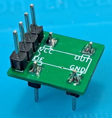

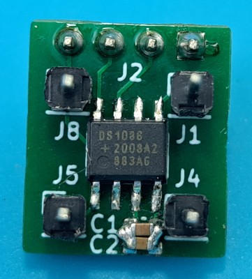

I have also soldered up one of the little DS1086 programmable oscillator adaptor boards:
Those capacitors were awkward. Hot air blew them away and I didn't have a good way to hold them in place, so I did this with a soldering iron. It is not great but it is not shorted and there is continuity where there should be, so hopefully it's fine.
The pin header is for SPI programing of the oscillator. It will allow me to try rates between the current 32MHz and 40MHz where it stops working. I need to dig out something to program it with though!
