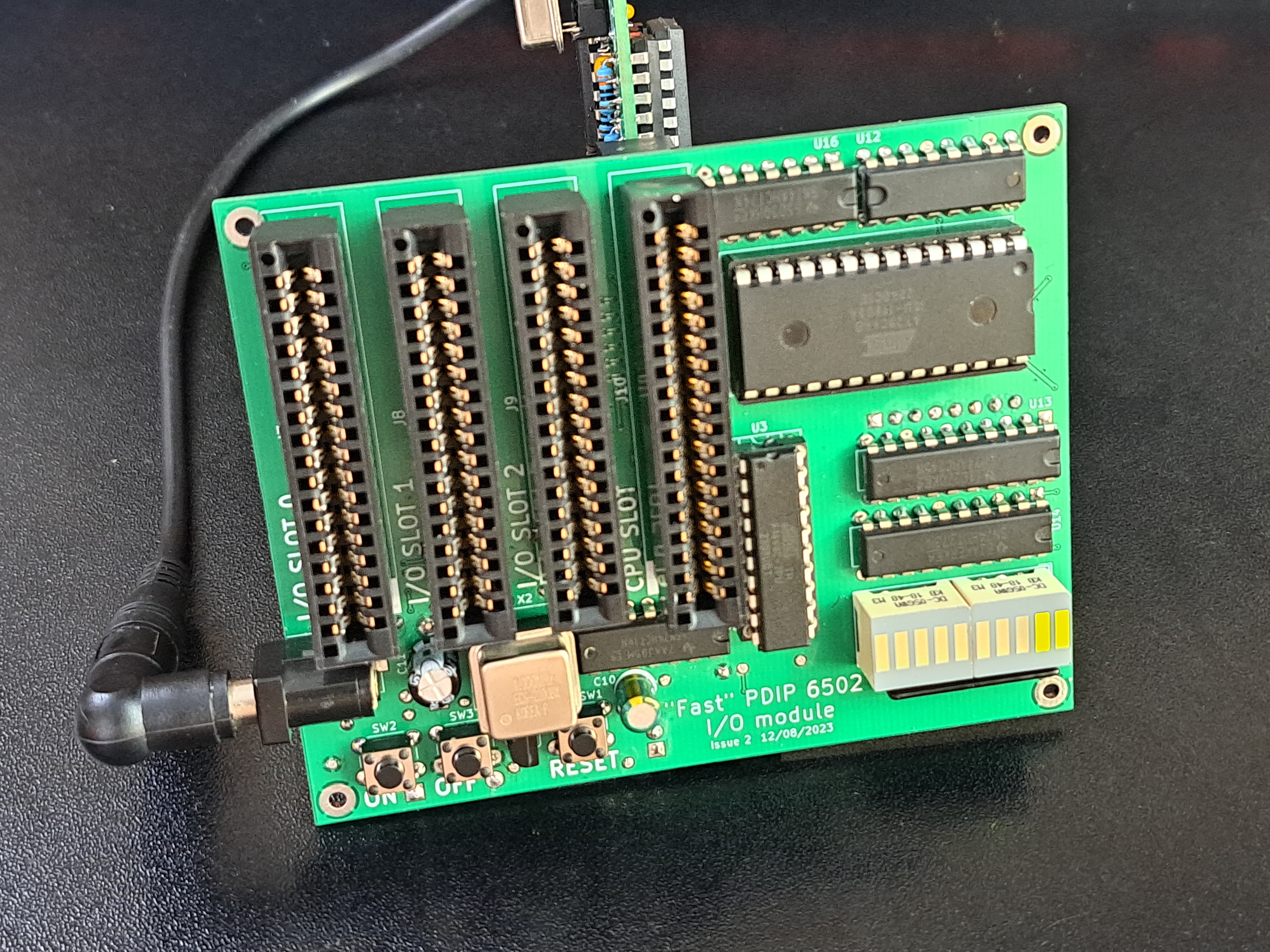

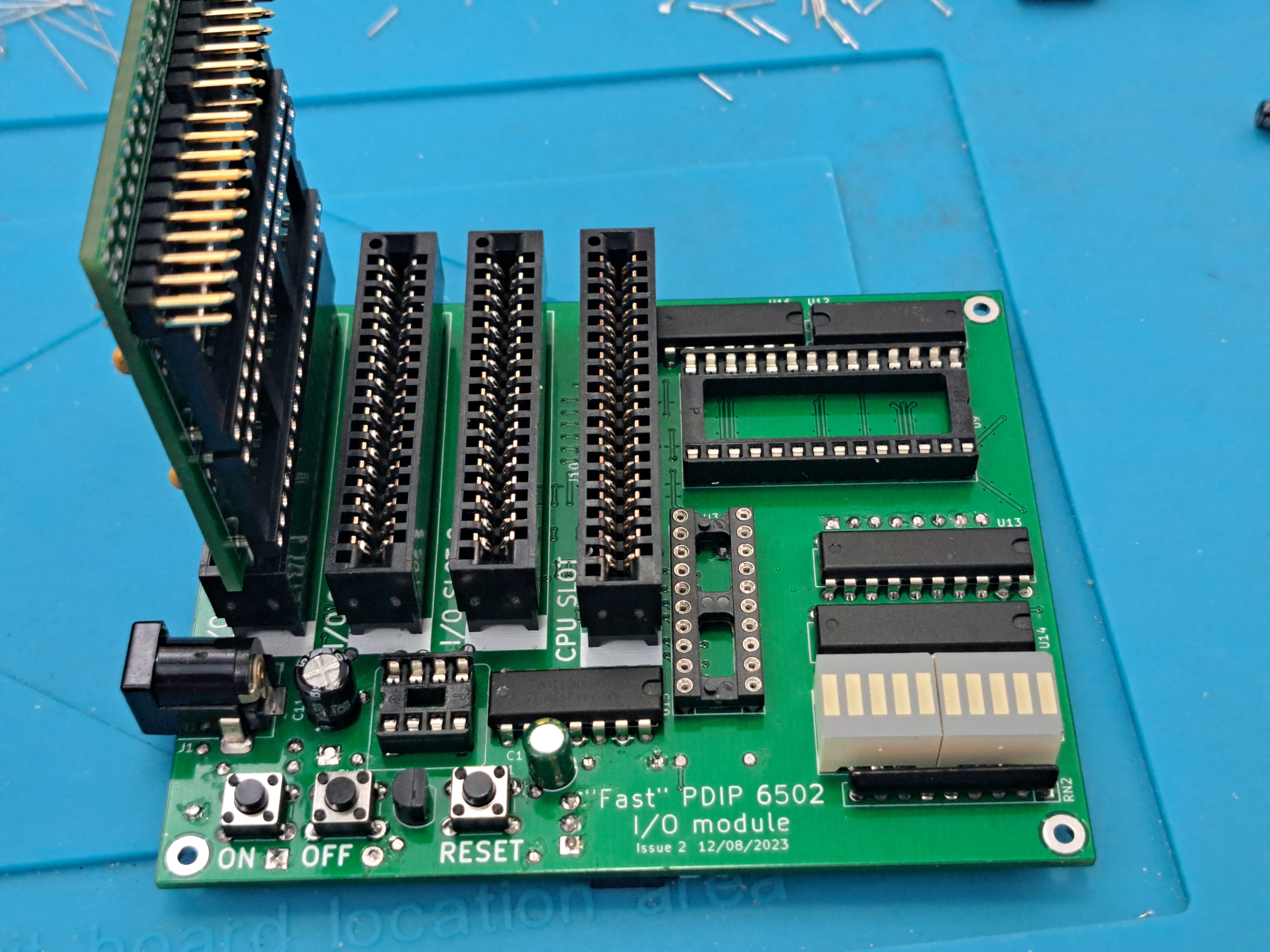

This is coming together - just the CPU board to go. My wife helped with the soldering. The empty sockets are for ROM, a PLD, and the I/O clock oscillator as I'm not sure what speed to go with yet.

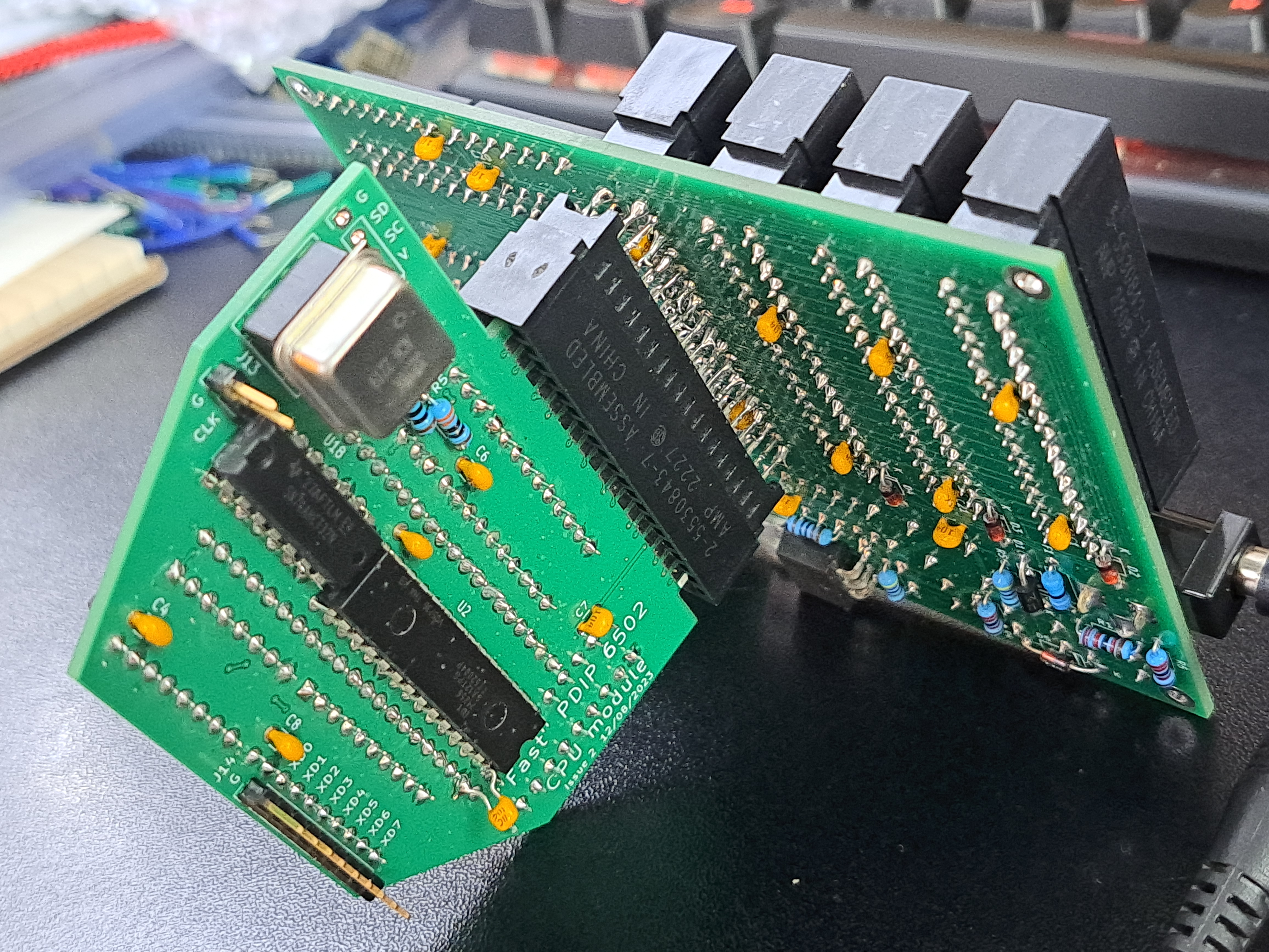

Posts: 741
The CPU board is soldered as well now, but somehow I've managed to make a nasty error with the card edge connector - all its pins are on the opposite side of the board to where they should be! It seems to only affect the CPU board - the VIA board's pins seem to be fine. In the picture above, the VIA board when mounted correctly has its "front" side facing to the right, and the connector's even pins are on that side of the board; but I've somehow got the edge connector footprint flipped on the CPU board, so that when I mount it with pin 1 at the bottom as I intended, the front side of the board - with even-numbered pins - is to the left rather than to the right, while the receptacle footprint on the main board is consistent, expecting even pins on the right.
Unless anybody has any better ideas, I think I'm going to have to desolder the CPU slot connector and put it on the back of the main board instead for now, so that the contacts are on the correct side of it. It's going to be tricky to desolder it, and after remounting it the whole thing will be a bit of an awkward shape physically, but I expect I will make other variants of the CPU board in future (e.g. the 64K RAM version) and can fix the issue properly for those, and then I'll have to move the connector back to the front side of the main board again. I don't think I'll get another run of the CPU boards done just to fix this issue though, it's not worth it given I have a workaround.

It's relatively easy to change the processor PCB to fix the issue, as the pads are just on the wrong sides of the board. I could even just swap the layers, without any layout changes! I think that's actually how this happened - I'd probably planned to do that but not followed through with it. My memory is very poor but I think I originally had pin 1 of the CPU connector at the opposite end, but wanted to relabel it so that its pin 1 was at the same end as the one for the I/O slots. I must have missed a step while doing that, and not checked thoroughly enough afterwards.

Edit: I went for Plan B, soldering a second CPU connector on the back, and while it's very messy after ask the desoldering and resoldering, it does work - here it's running a memory stress test at 32.768MHz:
The next faster oscillator I have is 40MHz but that doesn't run. I think phase 1 is too short because it doesn't even run from ROM (which is easiest as phase 2 is very long in that case). There are some experiments to do around that I think - it could be my circuit's limitation, or the CPU's. It's possible that with an unbalanced duty cycle it would work.

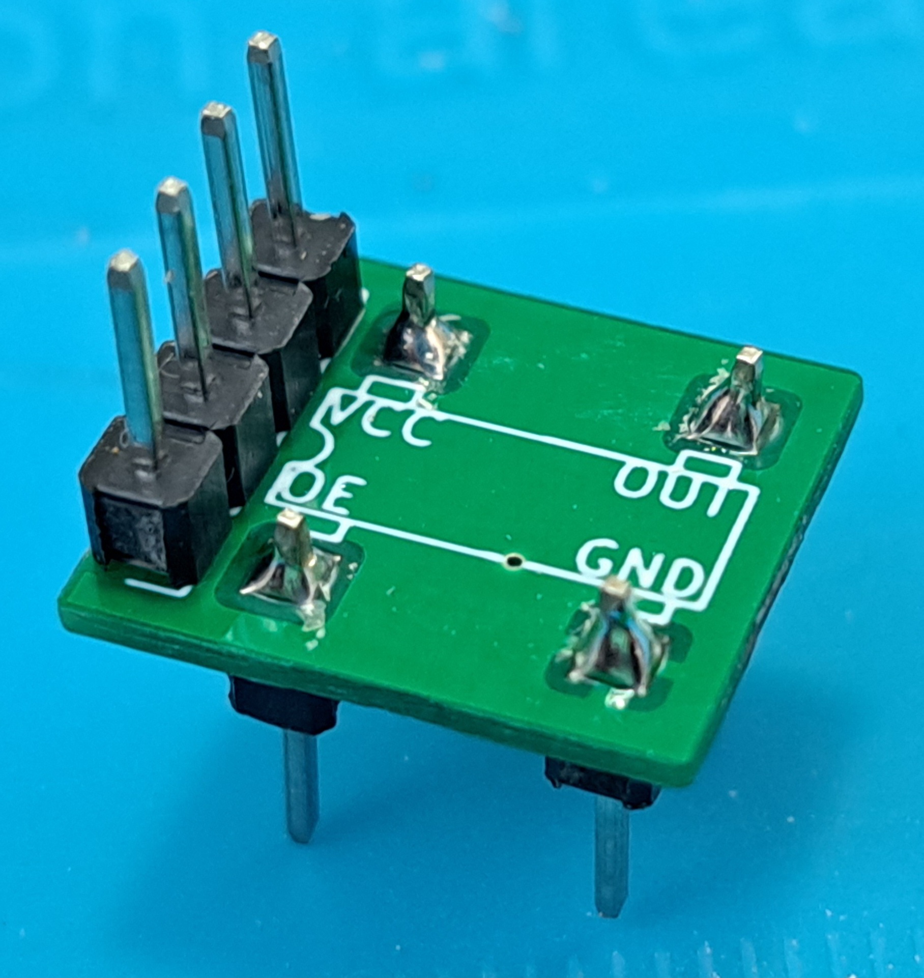

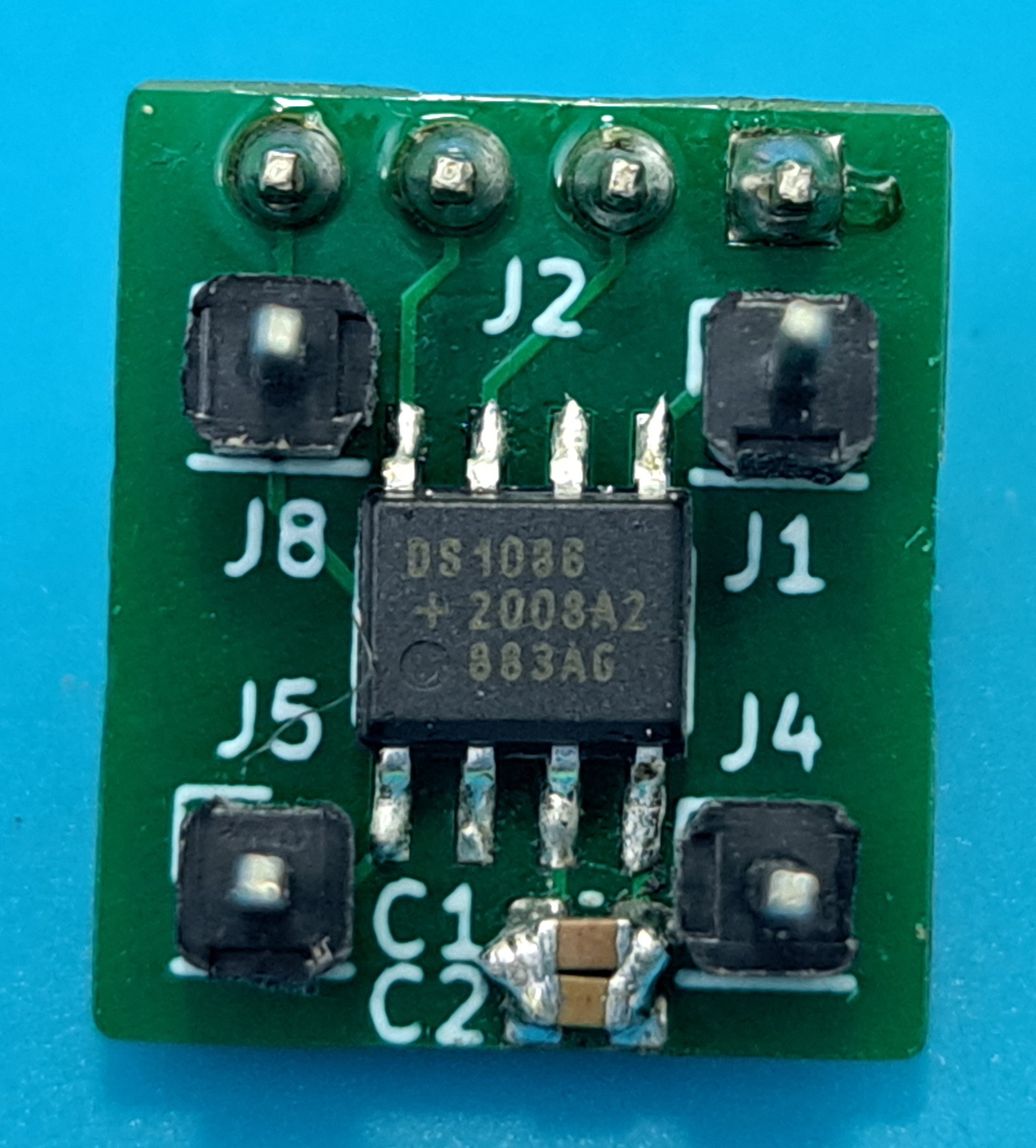

I have also soldered up one of the little DS1086 programmable oscillator adaptor boards:
Those capacitors were awkward. Hot air blew them away and I didn't have a good way to hold them in place, so I did this with a soldering iron. It is not great but it is not shorted and there is continuity where there should be, so hopefully it's fine.
The pin header is for SPI programing of the oscillator. It will allow me to try rates between the current 32MHz and 40MHz where it stops working. I need to dig out something to program it with though!
