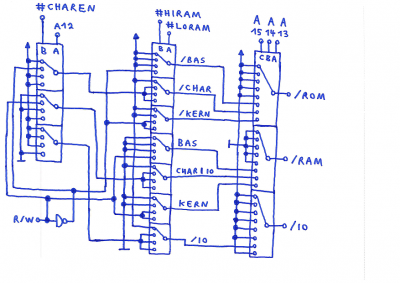

Considering a C64 address decoding without cartridges and without VIC-II bus access
(we would have to integrate 16MB RAM and some address decoding inside the VIC-II too, of course),
my proposal for a 4ns address decoder would look like this:
Typical propagation delays:
TI 74CBTLV3253: select to Q 3.25ns typ., data in to Q 0.25ns max.
TI 74CBTLV3251: select to Q 2.3ns typ., data in to Q 0.25ns max.
So when using 74CBTLV3253 and 74CBTLV3251, the decoder is supposed to have a ca. 4ns propagation delay.
Building it by only using 74CBTLV3251 instead would cut it down to ca. 3ns, but maybe this would take too much chips.
Another approach would be buying chips from Potatosemi, in theory this might cut down decoding time to 2ns.

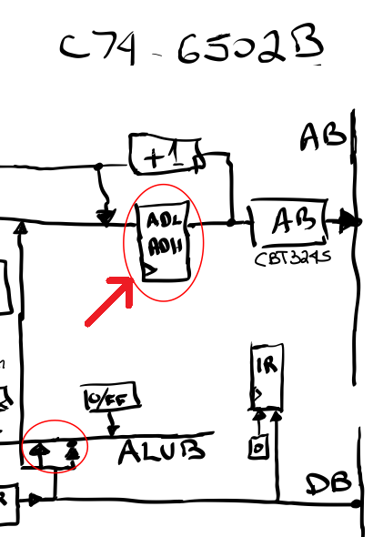

If address decoding would be too slow, the usual approach would be adding waitstates to memory reads\writes.
But in Drass's most recent CPU block diagram, placement of the ADL\ADH latches looks interesting:
It implicates, that there is a possibility of breaking the address decoder into two parts:
What means: making the address decoder (light blue) pipelined. (Note the red line.)
For instance, if we would check if A23..A16 are zero at the LEFT (input) side of the ADL\ADH\ADX latches,
this would save us some time on the 16MB address decoding, at the cost of adding a waitstate cycle to K24 at maybe 30MHz+ PHI2
for instructions which load ADX directly from the data bus.
//That's because RAM timing plus A23..A16 decoding time would add up.
Since the K24 instructions supporting 24 Bit addressing are not cycle compatible to the 65816,
maybe that wouldn't be much of a problem.
Putting the A15..A8 decoding to the left side of ADL\ADH would have two disadvantages:
At ca. 30MHz+, we would have to add a waitstate to 6502 instructions which load ADH directly from the data bus:
JMP, JSR, addressing modes like ABS, ABSX, ABSY etc...
The other disadvantage is, that the 6510 I\O port signals which control the memory mapping arrive one cycle too late.
Means, for C64 address decoding at the left side of ADH, we might have to add a waitstate cycle after 6510 I\O port writes...
...what might create some other problems.
A7..A0 decoding at the left side of ADL\ADH is a thing we should try to avoid,
because at 30MHz+ we would need to add a waitstate cycle for zero page addressing modes, too.

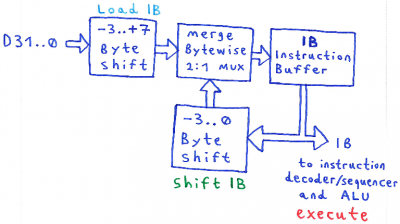

If you can't make memory faster, the second option would be making memory wider,
means having a 16, 32 or 64 Bit data bus instead of an 8 Bit data bus.
But when reading more than one Byte at a time from program memory,
we should spend some more thoughts on how good this goes together with the C64 memory decoding.
Like:
What might happen, if one creatively changes the memory layout by a 6510 I\O port write
shortly before PC rolls over from $9FFF to $A000, $BFFF to $C000 or $DFFF to $E000 ?
Once we have 32 or 64 Bit read from program memory completed,
the question how to make efficient use of it still could make enough fuel for running a neat academic career.

VAX 11/780 had a 32 Bit data bus and an 8 Bytes instruction buffer.
VAX 11/780 maintenance handbook, page 22 of the PDF, page 16 of the document (before it was scanned).
More details about the VAX11\780 instruction buffer starting at page 166 of this PDF.
VAX11/730 had a 32 Bit data bus, but only a 4 Bytes "prefetch register".
Technical description, PDF page 120.
MC68000 has a 16 Bit data bus.
Instructions are multiples of 16 Bit words, but data could be 1..4 Bytes anywhere in memory.
When there is an active bus cycle, the MC68000 considers it completed when the /DTACK input signal goes low
Like:

So we started to consider using synchronous SRAM instead, and after we did an extensive web search,
we think that the GS840Z18T-250 is quite the thing.
From the timing diagrams on page 20 of the PDF, it is able to do a random access within a single cycle
in NBT flow through mode.
TQFP100 package, means one still has a chance to solder that chip by hand. 3.3V or 2.5V supply.
4M*18, means that when putting two opposing chips on a PCB, one on top and the other at the bottom,
that's 16MB in total, the full K24 or 65816 addressing range.
The address lines of the synchronous SRAMs would be tied to the INPUTS of the ADL\ADH\ADX latches,
in other words: the idea is to integrate the whole 16MB of RAM into the CPU (together with the address decoder).
(Note, that the GS840Z SRAM has three chip enable inputs, pretty much like the 74138).
Using the 250MHz version of the SRAM might sound like overkill, but it's cheaper than the 167MHz version,
and in case the pipelined address decoder idea doesn't work out well this still might give us the possibility
of running the SRAM at twice the CPU clock for having some nanoseconds left for address decoding.
At the moment (August 2019), one GS8640Z18GT-250I chip (which makes 8MB in total) does cost ca. 70€ at Mouser.
But hey, one 8ns 512kB asynch SRAM chip costs 4.24€ when ordering 25+ chips, that's ca. 68€ for 8MB, so what.
Edit: there might be bigger synchronous SRAM chips, but they tend to have BGA package and\or 1.8V supply or such.

32 Bit data bus and 8 Bytes Instruction buffer (IB), here we go:
Notation, for avoiding any confusions related to 'little endian' and 'big endian':
Shift IB '-3' means shifting IB 3 Bytes toward IB0.
Shift IB '3' or '+3' means shifting IB 3 Bytes toward IB7.
Edit:
NMOS 6502 and 65C02 instruction size is 1..3 Bytes, and shifting IB -3..0 Bytes would do.
But for 65816 and K24, instruction size is 1..4 Bytes, take care.
The box labeled "merge" alternatively could be filled with OR gates.
As an example, we take a short piece of code that does copy 256 Bytes in memory,
from $0400..$04FF to $0500..$05FF.
Instruction buffer activity explained slowly and step by step, the CPU actually might try to do some of the steps within one machine cycle.
red: execute an instruction
blue: read 32 Bit from program memory into the Instruction Buffer (short form: buffer).
green: shift or flush buffer
IB: Instruction Buffer
_0._1._2._3._4._5._6._7
xx.xx.xx.xx.xx.xx.xx.xx //No valid Bytes in the buffer. Need to read in 32 Bit.
A0.00.B9.00.XX.XX.XX.XX //Read in 32 Bit from program memory.
A0.00.B9.00.xx.xx.xx.xx //Execute A0 00 //LDY #$00
B9.00.xx.xx.xx.xx.xx.xx //Shift the buffer for removing the instruction which was executed.
B9.00.xx.xx.xx.xx.xx.xx //B9 is a three Bytes instruction, two valid Bytes in the buffer. Need to read in another 32 Bit.
B9.00.04.99.00.05.xx.xx //Read in 32 Bit from program memory.
B9.00.04.99.00.05.xx.xx //Execute B9 00 04 //LDA $0400,Y
99.00.05.xx.xx.xx.xx.xx //Shift the buffer for removing the instruction which was executed.
99.00.05.xx.xx.xx.xx.xx //Execute 99 00 05 //STA $0500,Y
xx.xx.xx.xx.xx.xx.xx.xx //Shift the buffer for removing the instruction which was executed.
88.D0.F7.60.xx.xx.xx.xx //Read in 32 Bit from program memory.
88.D0.F7.60.xx.xx.xx.xx //Execute 88 //DEY
D0.F7.60.xx.xx.xx.xx.xx //Shift the buffer for removing the instruction which was executed.
D0.F7.60.xx.xx.xx.xx.xx //Execute D0 F7 //BNE foo. Conditional branch taken.
xx.xx.xx.xx.xx.xx.xx.xx //Change in program memory flow, flush buffer. //the rest in the buffer is not executed.
B9.00.04.99.xx.xx.xx.xx //and from here, the loop repeats until Y contains zero.
Some observations:
0) IB0 contains the instruction Byte.
1) For 2 Byte instructions, IB1 contains either 8 Bit immediate data or the lower Byte of a 16 Bit address.
2) For 3 Byte instructions, IB2 contains the higher Byte of a 16 Bit address //screaming "build a 16 Bit ALU for address calculation into the CPU"
3) If an instruction was executed, we need to remove the related Bytes from the Instruction buffer (by shifting the buffer toward IB0).
4) If there was a change in program flow (JMP,JSR,RTS,RTI, Bxx true), we need to flush the Instruction Buffer.
5) We need to keep track, how many Bytes in the buffer are valid.
6) If the Instruction Buffer is empty, we need to read 32 Bit from program memory (into IB0..IB4).
7) If there are not enough valid Bytes for executing an instruction, we need to read 32 Bit from program memory.
8) We would have to shift the 32 Bit (4 Bytes) read from program memory by -3..+7 Bytes before merging them with the buffer for efficiently making use of the buffer.
9) For a 32 Bit data bus, the address from which the 4 Bytes are read usually isn't PC, but [PC AND (NOT 3)] //A0 and A1 are zero.
10) It might become necessary to read 4 Bytes from [PC AND (NOT 3) +4].
11) MC68010 featured a "loop mode" for two instruction loops.
When changing the Instruction Buffer size from 8 Bytes (IB0..IB7) to 16 Bytes (IB-7..IB8), when being able to Bytewise shifting the buffer
into both directions, and when pulling the one or other little trick, the loop in our example could repeat without the need for reading
Bytes into the buffer from program memory.
For "shifting", we would need something like a barrel shifter working at Byte level.
Barrel shifter could be either implemented by using 74CBTLV multiplexers (what won't simplify PCB layout) or by using a lattice of 74CBTLV3245 bus switches (what won't simplify generating the control signals).
When sacrificing a little bit of speed, the chip count for implementing a barrel shifter could be reduced (replacing one layer of 74CBTLV3251 8:1 multiplexers by three layers of 74CBTLV3257 2:1 multiplexers).
For "merging", I think it would be something like 74CBTLV3257 2:1 multiplexers working at Byte level... or a lot of OR gates.
Spending any thoughts on:
How to generate the 32 Bit program memory read address,
How many and which control signals are needed for implementing all this,
How to generate said control signals...
That's a thing that could be done later, after we have:
Some more spare time at our hands,
A decision if we really should go for a 32 Bit data bus and an 8 Bytes Instruction Buffer,
And a clear definition of what a (hypothetical) 32 Bit 6502 bus interface is supposed to look like.
OT: started to wonder, if anybody at TI still remembers the SN74AS897 barrel shifter.
BTW: using an Instruction Buffer and staying cycle compatible to the 6502 might be two different pairs of shoes.
