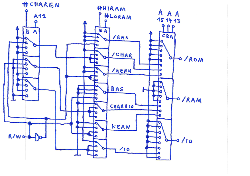

Considering a C64 address decoding without cartridges and without VIC-II bus access
(we would have to integrate 16MB RAM and some address decoding inside the VIC-II too, of course),
my proposal for a 4ns address decoder would look like this:
Typical propagation delays:
TI 74CBTLV3253: select to Q 3.25ns typ., data in to Q 0.25ns max.
TI 74CBTLV3251: select to Q 2.3ns typ., data in to Q 0.25ns max.
So when using 74CBTLV3253 and 74CBTLV3251, the decoder is supposed to have a ca. 4ns propagation delay.
Building it by only using 74CBTLV3251 instead would cut it down to ca. 3ns, but maybe this would take too much chips.
Another approach would be buying chips from Potatosemi, in theory this might cut down decoding time to 2ns.
Looking forward to see, for what 16MB memory layout and for what memory chips Drass decides later.

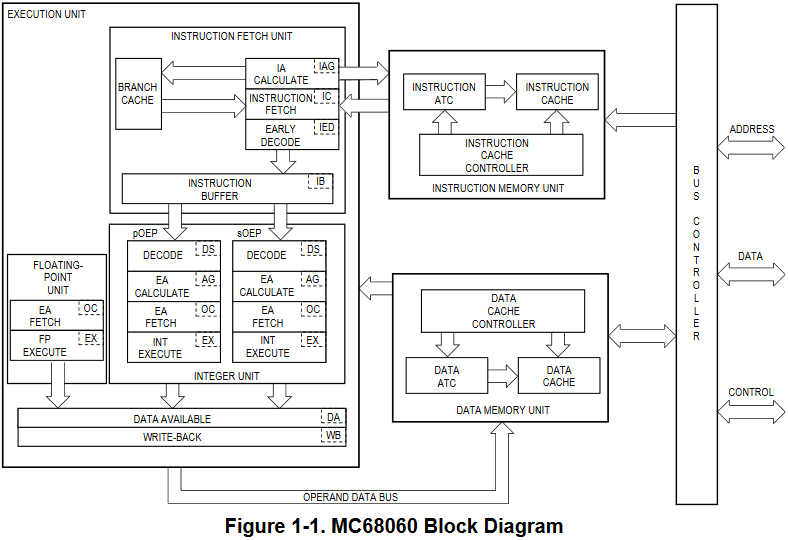

MC68060 block diagram looks nice, started to wonder if there were related Motorola patents.
