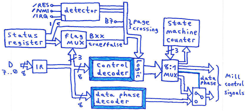

OK, now for the unavoidable proposal for building a non_microcoded 6502 instruction decoder\sequencer from multiplexers,
something we certainly won't build for this project.
IR is the instruction register.
"data phase decoder" is a big lump of 8:1 multiplexers like in my previous posting.
It generates control signals for ALU, flags and registers for the mill in machine cycles where the ALU processes data.
"control decoder" is another lump of 8:1 multiplexers, together with a little lump of logic related to interrupts, flag testing etc.
it is responsible for what happens in all of the other machine cycles. (addressing modes etc.)
Some more 8:1 multiplexers controlled by the 3 Bit state machine counter (that's 8 states) then generate control signals.
//Means it could happen that one would have to make eight 16*16 OpCode tables, one for every state.
That 2:1 switch which routes either these control signals or control signals from the "data phase decoder"
to the mill is just for illustration of the concept:
On implementation level, one could use a 7404 inverter plus 8:1 multiplexers with three_state outputs like 74251 or 74CBT(LV)3251
for getting rid of that switch.
Some more clues might be hiding up in the thread.
When trying to take this approach, better expect to end up with >150 TTL chips just for the instruction decoder\sequencer.
Because the select inputs of all these multiplexers are fed by the instruction register,
we are going to have a lot of capacitances, even when creatively buffering the instruction register outputs.
So a design like that would be too slow for the project (it probably won't be getting past 100MHz).
An instruction decoder\sequencer built from 8ns asynch SRAM containing microcode would have about the same speed,
while being a lot smaller, cheaper, more reliable, and simpler to modify (bug fixes).

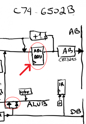

If address decoding would be too slow, the usual approach would be adding waitstates to memory reads\writes.
But in Drass's most recent CPU block diagram, placement of the ADL\ADH latches looks interesting:
It implicates, that there is a possibility of breaking the address decoder into two parts:
What means: making the address decoder (light blue) pipelined. (Note the red line.)
For instance, if we would check if A23..A16 are zero at the LEFT (input) side of the ADL\ADH\ADX latches,
this would save us some time on the 16MB address decoding, at the cost of adding a waitstate cycle to K24 at maybe 30MHz+ PHI2
for instructions which load ADX directly from the data bus.
//That's because RAM timing plus A23..A16 decoding time would add up.
Since the K24 instructions supporting 24 Bit addressing are not cycle compatible to the 65816,
maybe that wouldn't be much of a problem.
Putting the A15..A8 decoding to the left side of ADL\ADH would have two disadvantages:
At ca. 30MHz+, we would have to add a waitstate to 6502 instructions which load ADH directly from the data bus:
JMP, JSR, addressing modes like ABS, ABSX, ABSY etc...
The other disadvantage is, that the 6510 I\O port signals which control the memory mapping arrive one cycle too late.
Means, for C64 address decoding at the left side of ADH, we might have to add a waitstate cycle after 6510 I\O port writes...
...what might create some other problems.
A7..A0 decoding at the left side of ADL\ADH is a thing we should try to avoid,
because at 30MHz+ we would need to add a waitstate cycle for zero page addressing modes, too.

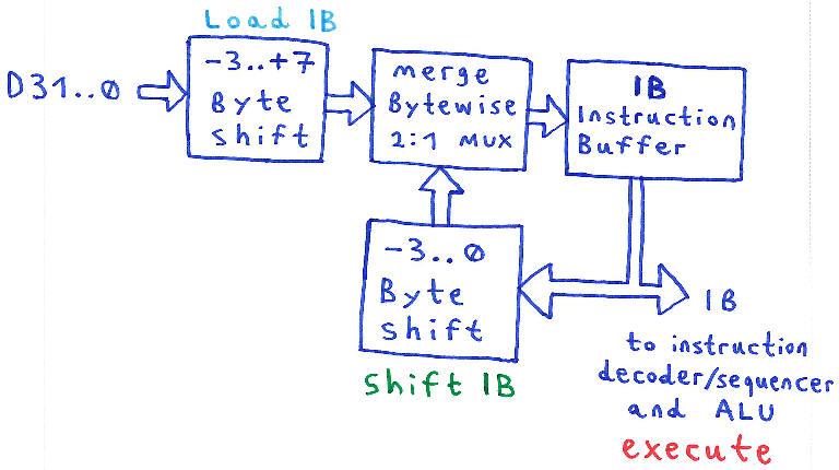

32 Bit data bus and 8 Bytes Instruction buffer (IB), here we go:
Notation, for avoiding any confusions related to 'little endian' and 'big endian':
Shift IB '-3' means shifting IB 3 Bytes toward IB0.
Shift IB '3' or '+3' means shifting IB 3 Bytes toward IB7.
Edit:
NMOS 6502 and 65C02 instruction size is 1..3 Bytes, and shifting IB -3..0 Bytes would do.
But for 65816 and K24, instruction size is 1..4 Bytes, take care.
The box labeled "merge" alternatively could be filled with OR gates.
As an example, we take a short piece of code that does copy 256 Bytes in memory,
from $0400..$04FF to $0500..$05FF.
     LDY #$00
foo: LDA $0400,Y
     STA $0500,Y
     DEY
     BNE foo
     RTS
Program memory contents at $0100:
A0.00.B9.00.04.99.00.05.88.D0.F7.60
LDY #$00      .        .  .     .
foo: .LDA $0400,Y
              .STA $0500,Y
                       .DEY
                          .BNE foo
                                .RTS
Instruction buffer activity explained slowly and step by step, the CPU actually might try to do some of the steps within one machine cycle.
red: execute an instruction
blue: read 32 Bit from program memory into the Instruction Buffer (short form: buffer).
green: shift or flush buffer
IB: Instruction Buffer
_0._1._2._3._4._5._6._7
xx.xx.xx.xx.xx.xx.xx.xx //No valid Bytes in the buffer. Need to read in 32 Bit.
A0.00.B9.00.XX.XX.XX.XX //Read in 32 Bit from program memory.
A0.00.B9.00.xx.xx.xx.xx //Execute A0 00 //LDY #$00
B9.00.xx.xx.xx.xx.xx.xx //Shift the buffer for removing the instruction which was executed.
B9.00.xx.xx.xx.xx.xx.xx //B9 is a three Bytes instruction, two valid Bytes in the buffer. Need to read in another 32 Bit.
B9.00.04.99.00.05.xx.xx //Read in 32 Bit from program memory.
B9.00.04.99.00.05.xx.xx //Execute B9 00 04 //LDA $0400,Y
99.00.05.xx.xx.xx.xx.xx //Shift the buffer for removing the instruction which was executed.
99.00.05.xx.xx.xx.xx.xx //Execute 99 00 05 //STA $0500,Y
xx.xx.xx.xx.xx.xx.xx.xx //Shift the buffer for removing the instruction which was executed.
88.D0.F7.60.xx.xx.xx.xx //Read in 32 Bit from program memory.
88.D0.F7.60.xx.xx.xx.xx //Execute 88 //DEY
D0.F7.60.xx.xx.xx.xx.xx //Shift the buffer for removing the instruction which was executed.
D0.F7.60.xx.xx.xx.xx.xx //Execute D0 F7 //BNE foo. Conditional branch taken.
xx.xx.xx.xx.xx.xx.xx.xx //Change in program memory flow, flush buffer. //the rest in the buffer is not executed.
B9.00.04.99.xx.xx.xx.xx //and from here, the loop repeats until Y contains zero.
Some observations:
0) IB0 contains the instruction Byte.
1) For 2 Byte instructions, IB1 contains either 8 Bit immediate data or the lower Byte of a 16 Bit address.
2) For 3 Byte instructions, IB2 contains the higher Byte of a 16 Bit address //screaming "build a 16 Bit ALU for address calculation into the CPU"
3) If an instruction was executed, we need to remove the related Bytes from the Instruction buffer (by shifting the buffer toward IB0).
4) If there was a change in program flow (JMP,JSR,RTS,RTI, Bxx true), we need to flush the Instruction Buffer.
5) We need to keep track, how many Bytes in the buffer are valid.
6) If the Instruction Buffer is empty, we need to read 32 Bit from program memory (into IB0..IB4).
7) If there are not enough valid Bytes for executing an instruction, we need to read 32 Bit from program memory.
8) We would have to shift the 32 Bit (4 Bytes) read from program memory by -3..+7 Bytes before merging them with the buffer for efficiently making use of the buffer.
9) For a 32 Bit data bus, the address from which the 4 Bytes are read usually isn't PC, but [PC AND (NOT 3)] //A0 and A1 are zero.
10) It might become necessary to read 4 Bytes from [PC AND (NOT 3) +4].
11) MC68010 featured a "loop mode" for two instruction loops.
When changing the Instruction Buffer size from 8 Bytes (IB0..IB7) to 16 Bytes (IB-7..IB8), when being able to Bytewise shifting the buffer
into both directions, and when pulling the one or other little trick, the loop in our example could repeat without the need for reading
Bytes into the buffer from program memory.
For "shifting", we would need something like a barrel shifter working at Byte level.
Barrel shifter could be either implemented by using 74CBTLV multiplexers (what won't simplify PCB layout) or by using a lattice of 74CBTLV3245 bus switches (what won't simplify generating the control signals).
When sacrificing a little bit of speed, the chip count for implementing a barrel shifter could be reduced (replacing one layer of 74CBTLV3251 8:1 multiplexers by three layers of 74CBTLV3257 2:1 multiplexers).
For "merging", I think it would be something like 74CBTLV3257 2:1 multiplexers working at Byte level... or a lot of OR gates.
Spending any thoughts on:
How to generate the 32 Bit program memory read address,
How many and which control signals are needed for implementing all this,
How to generate said control signals...
That's a thing that could be done later, after we have:
Some more spare time at our hands,
A decision if we really should go for a 32 Bit data bus and an 8 Bytes Instruction Buffer,
And a clear definition of what a (hypothetical) 32 Bit 6502 bus interface is supposed to look like.
OT: started to wonder, if anybody at TI still remembers the SN74AS897 barrel shifter.
BTW: using an Instruction Buffer and staying cycle compatible to the 6502 might be two different pairs of shoes.
...but now I need a break before "going superscalar".
PostPosted: Wed Aug 07, 2019 4:35 am
Posts: 170
I just had a quick thought about the instruction buffer that could be a simpler way to build it, what if we had a 8 byte circular buffer that we could load into either the low word or the high word, and coupled with that we have an instruction pointer into the buffer. This would seem to be easier to implement.
So a reworked example would be (where . is the instruction pointer):
A0.00.B9.00.04.99.00.05 //Read in next 32 bit value (because IP is 1..3). This should be done in parallel with instruction execution.
A0.00.B9.00.04.99.00.05 //Execute B9 00 04 //LDA $0400,Y
88.D0.F7.60.04.99.00.05 //Read in 32 Bit from program memory (because IP is 5..7).
88.D0.F7.60.04.99.00.05 //Execute 99 00 05 //STA $0500,Y
88.D0.F7.60.B9.00.04.99 ////Read in next 32 bit value (because IP is 1..3).
The logic for this should be relatively simple although there could be quite a few ways to implement it. I was thinking that no shift registers would be required. The data bus would either write to the low word or the high word, and bytes would be read sequentially from the other side.
This would also generalise to a larger buffer, and from there could be generalised into a cache (with a lot more chips).
PostPosted: Wed Aug 07, 2019 6:47 am
Posts: 1397
Hi jds, thanks for joining the discussion.
I'm expecting something like >100MHz PHI2 with a 32 Bit (4 Bytes) data bus, and that's a throughput of >400MB/sec. peak.
When using an 8 Bit circular buffer to handle this, I think the buffer would have to be able operate at >400MHz.
The fastest latch from TI appears to be the SN74ALVTH16374, and it only makes 250MHz max.
The Potatosemi PO74G374A makes 600MHz, but with a 2.4ns propagation delay and a 15pF load at the output.
For more than 15pF of load capacitance, we could expect that speed dramatically drops.
When attaching some circuitry to a latch, expect IC input pins to have 4pF of capacitance, and three_state IC output pins to have 6pF.
Wiring the outputs of 8 latches together, plus PCB traces, plus some circuitry reading the latch outputs gives you a >50pF capacitive load pretty fast.
8 Bit ECL\LVPECL latches went pretty exotic by now, main mamory RAM and microcode RAM would be TTL,
TTL to ECL\LVPECL (and back) level converters don't tend to be too fast.
Would be hard to build an 8 Bit circular buffer working at >400MHz with the chips we are able to buy.
Building at least 4 circular 8 Bit buffers working in parallel and running at >100MHz probably might be an option,
but I'm starting to think that this would require more chips than to have an 8 Bytes IB latch with two Bytewise barrel shifters attached to it.
I'm afraid that building a >100MHz cache by using 8 Bit comparators with a >10ns propagation delay won't work out well, sorry.

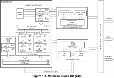

MC68060 block diagram looks nice, started to wonder if there were related Motorola patents.
